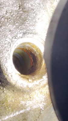

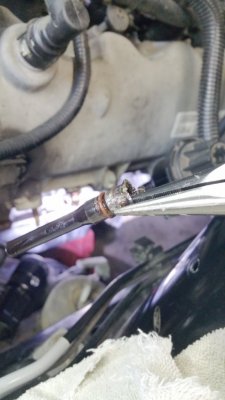

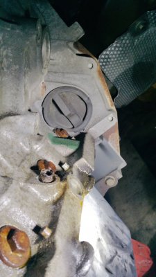

Caved the side in a little and started prying with long skinny screwdriver... At one point it got pushed in a little and wanted to freak out.
Kept at it and eventually got about a half inch out.
It still fought all the way till the end. Its grip didnt give up untill the oring was completely out of the bore. After i got that half a inch out I grabbed it with some beefy needle nose plyers... Kept a constant upward pull while prying. Several times i stopped and heated the bore up for 10-15 seconds with propane torch and pb blasted it.
When i seen the orange o-ring i about started dancing.
What a b****!
Thank you lord!
Oring doesnt look bad so i wonder if bore is corroded or what? Should i try to clean up the bore before installing new one? Maybe some 2000 grit on a dowel then do oil change?

Man glad you got that out. I'm confused by all that corrosion, that's weird. The coating on your dipstick tube must have come off and started to rust.
I think an oil change is in order regardless but I guess cleaning the bore depends on how bad it is. When I installed my new dipstick tube I put anti-sieze on the o-ring.

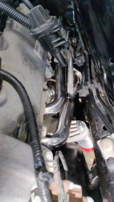

Headers will be here Wednesday. I took fri off so that ill have 3 days to make sure i get this done. Also have new headlights, grille, axlebacks to install. Well the steeda version borla stingers didnt ship yet. I got tracking saying they would be here fri and so had my daughter come sit at the house all morning to sign for them since i was at work and only motor mounts came. Packing slip said the axlebacks were "still in production" whatever that means.... Made to order? Weird.... I sent them an email asking for eta but still waiting for reply.
Anyway.... Im in garage just getting ready for headers and looking things over and had a few questions.
#1 which holes do i leave factory studs? I know its to help keep gasket on while installing but i know studs will also hit primarys in certain areas. There was a thread that mentioned which holes to leave studs, and which hole to cut down bolt to clear primary tube when putting bolt in but cant find this info now :angry1:
#2 Am i suppossed to weld the short tubes that connect H pipe to headers? They fit pretty loose together and dont see a clamp closing that gap. I bought butt clamps and step clamps but not thrilled with their quality. The banding seems pretty thin compared to the stock clamps i took off factory H.
#3 .... One of the back o2 sensors was seized in there good and had to torch it out.... Threads are pretty stripped. Should i order new downstream o2 or just leave them out and plug the bungs?
Dont know if it matters but steeda does my tunes untill i get the car where i want it and will take it to a dyno.

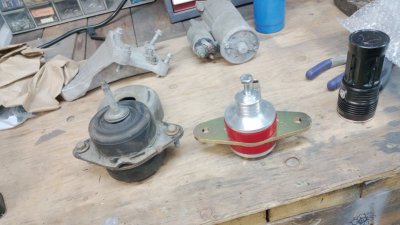

#4 ... I got the steeda motor mounts. Should I install them at factory height or with a slight 1/4" drop?
I thought i read before with pypes LT that some people had steering shaft clearance issues untill they lowered motor 1/4". But cant find any info on that now either lol.

I don't know about the studs, I used all bolts on mine. My headers had a few slotted holes so I started bolts with the gaskets, then hung the headers on the bolts as I put them up in from the bottom.
As for the clamps- They are supposed to be thin, this is what helps them conform to the pipe. Are the ends of the H pipe slotted? If not you might cut a couple in there to help it tighten down. Trust me, the clamps will do their job. They tighten up real good once the bolts are tight. I use strap clamps on all my exhaust systems now.
Downstream O2's, if you have a tune that turns them off, you can just install plugs. It's definitely easier that way.

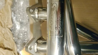

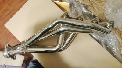

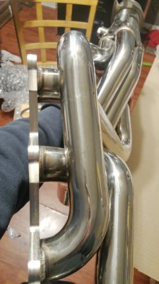

Got the headers today.
$530 shipped and they are legit.
Even came with 2 o2 extender harnesses which i wasnt sure if they would or not.
The ebay headers primary near steering linkage was WAYYY off!
Ebay header
Pypes header
Actually... The whole pypes header looks more compact and inline more. I wonder if naughty china kids stole the tubing from work and welded them in some garage with no jig or fixture.
Either that or theres another company who clones the pypes which is clone of kooks :rolleyes:

Pypes is the original "name brand" Chinese knockoff of Kooks, and then there are even cheaper no-name copies on Ebay. I've also seen ebay chinese knockoffs of JBA's. Those seem to be the two they have copied.
I really think the chinese no-name stuff is slapped together, probably with no jig, or with a bad one. At any rate those look much better, you should be good to go now.

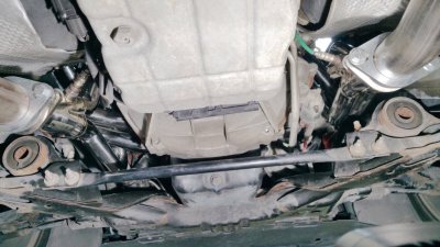

These pypes clear the steering shaft with a half inch to spare. I just ran the steeda mounts at stock height.
I got the dipstick tube and lubed it with grease and antiseize and it popped right in unlike how it didnt want to come out.

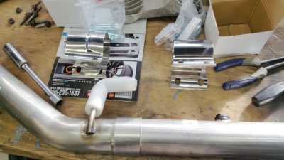

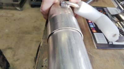

When i installed the H pipe I read to tighten clamps from 30-40 ft lbs.
I used antiseize on all of them so backed the torque wrench down to 20ft lbs because it just seemed like the wrench was never going to click since the threads were lubed with antiseize.

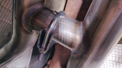

The whole process went smooth untill the very last friggin 2 bolts. The H area was the last clamp i had to tighten and was getting tired so just kept running it in. It didnt click and so I looked and the damn H section caved in a bit.
Pretty pissed at myself.... Will probably leak there. All the band clamps i have were 2.5" and that H area needs a 2" or 2 1/4" so had to use the damn u-bolt clamp. Was going to look for a band clamp at parts store tomorrow but figured all they had was u-bolts so decided to use the u-bolt pypes provided. That was a mistake.
Caving that area in really pisses me off. Guess its my fault for being in a rush.
What do you guys think i should do?
Just run it and see if it leaks?
Replace with right sized band clamp?
Hope i dont have to have it welded.

Id just the leave it the way it is and see if it leaks. Its gonna be a bitch to get that thing apart to get another clamp on there, just steer into the curve.
