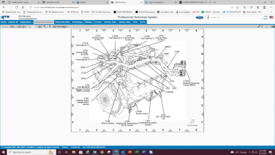

Interesting that your diagram calls that the "Engine Oil Temperature (EOT) Sensor". All the searches I've done have come up empty or call that an engine coolant temperature sensor. Weird. Thanks for the info!

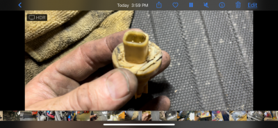

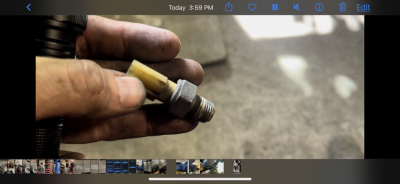

So, I was mistaken. My car is a 2006 not 2007. Also, when I went to the dealer to get a new oil temp sensor, this was before I removed the air splitter from under the engine and saw the hacked all plastic sensor in my oil pan, they gave me a brass unit with plastic connector. Once I saw the all plastic hacked up one in the oil pan, I figured the dealer just gave me the wrong part but after comparing the plug geometry, it looks like the wiring harness pigtail will plug into the brass sensor. I'll need to confirm this next time I'm at the shop. The diameter of the threaded portion of the brass sensor looks to be smaller than the threaded section of the plastic sensor so even if the electrical connector plugs in correctly, I don't think I can just screw the brass sensor into the oil pan.
There must be a simple reason for all this. I'm just pulling my hair out to find it.

Rock auto offers what appears to be a generic oil temp sensor that looks like the modified sensor in photo 1. If you look at their website you will see what it looked like originally.
