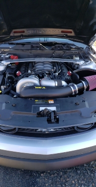

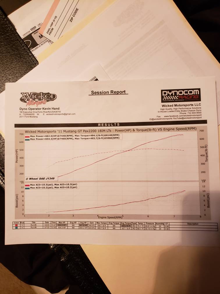

hey guys, I'm on a few other forums but new to this one. I recently just got my 2011 mustang gt 6 speed back this weekend from getting my paxton 2200 sl installed and my new tune. had a performance shop install and tune it as I wanted to to learn and save money but just dont have the time due to work. the car has longtube headers a ported 2018 intake manifold and opg's and an rst clutch otherwise its stock. I had a Paxton 2200 sl with a 3.8 pulley ID1050x's and a vmp boost a pump installed and a retune. I was expecting 580-600 rwhp and was surprised to find out it made 662/494 sea @ 7400 rpm's. The 93 was really good but I'm going to run boostane in every tank full to ensure I have good fuel. here's the sheet

Great numbers but try turning the attachment 90* to the left so that it comes in landscape. It's a bit hard to read sideways. ;)

any better

pretty similar to a dynojet from what ive heard and what he was telling me

Kevin @ Wicked... that's a name I haven't seen in a long while

About 2 years ago when I was looking to get my 2v tuned I had people recomending him and everything went well so I had him do the work on this car as well with good results
