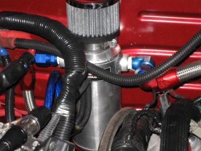

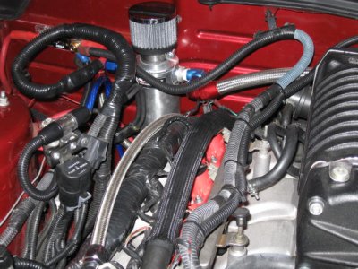

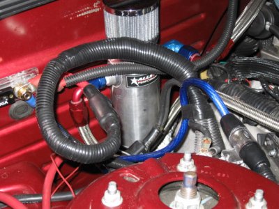

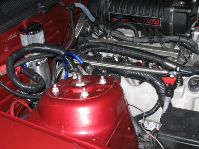

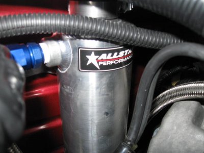

I have breathers on both sides and get zero oil on the drivers side. I get enough oil on the passenger side that it pools up on the valve cover and I'm tired of cleaning it. I need to figure out the parts for a dual line vented catch can.
here ya go

Nice-looking setup. Keep in mind, if it matters, that oil will accumulate in dips in the line; that could clog the passenger side venting in the pics above.
To keep the lines open, try to keep it so oil will run out the hoses, either to the can or back to the valve cover.

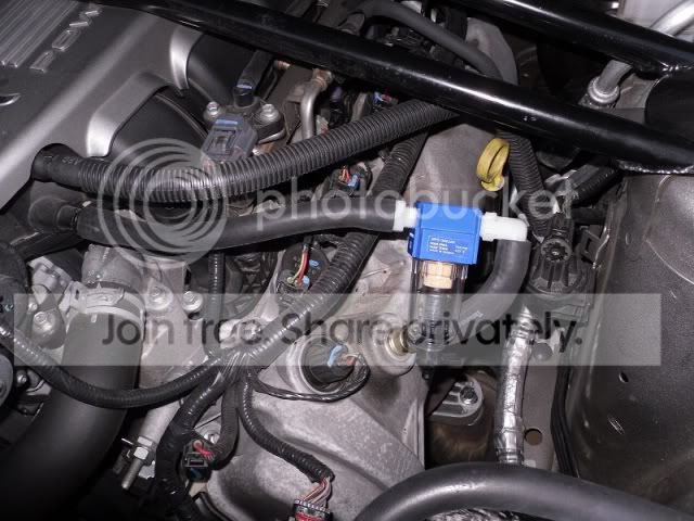

I paid around $12 for mine. It was so cheap I decided to do a little experiment. I wanted to see how much oil was NOT being captured so I installed a pair in series. I did this on my '03 Terminator when I owned it. Guess what? Each trapped the same amount of oil (see pic)! I can't help but wonder how much is still being passed through....
2)
If you're using full synthetic oil, remove the white "filter" like I've done. It is not compatible with synthetic oil.
other side?
On the Terminator, I've read the passenger side passes a minute amount of oil. On my S197, I wasn't sure so I installed a pair, similar to my Terminator. After 4,000 miles, take a look to see how much oil was captured. Hardly any at all. For the same mileage, my catch can (driver's side) has trapped almost one inch of oil.

ok, so I did this mod today after changing my oil after 5k miles and seeing how low I was. I used a haulsfield campbell air filter. Its rated at 150psi, i dont know how much any of this matter, I'm just verifying im not gonna grenade something at WOT lol
Spent about $25 total, and used a 90* elbow on the in so I didnt have to loop a big thing of hose, and its light enough that the hose supports the weight of the seperator
ixtlan
Apr 9, 2007
1,623
30
Hooper, Utah
The pressure rating is not so much a issue as this is vacuum on the drivers side. I chose the Husky because it flowed with less restriction. If you could blow through the CH filter with little effort you shouldn't have a problem.
