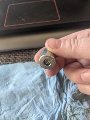

There is a spring loaded plunger in a cylindrical valve, if you blow into it from one direction, it has minimal resistance in one direction but allows a small amount of backflow but anything more and it completely blocks.
