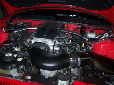

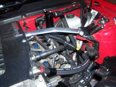

I fully agree about our terms being mixed up lol. More than likely I'm mixing up the blower/vacuum inlet after the "throttle body" with the intake manifold inlet. Perhaps after looking over the images of my Saleen VI blower setup, you can confirm that it is indeed the blower/vacuum inlet after the "throttle body" which is actually hooked up to the catch can and also from the catch can to the driver's side cam cover?

I can see a 5/8” hose coming from the blower inlet right behind the throttle body and connected to the catch can. I see you have added a check valve to this line. I can’t fully see the other line from the catch can but it looks like it go to the drivers cam cover. Looks good to me but you don’t need the check valve if the one in the cam cover works. On the passenger side I see the cam cover is connected to the clean air duct in front of the throttle body just like it should be. I also see what looks like a breather on your oil fill neck. That breather will introduce unmetered air into the system rather than pull air through the clean air duct.
Yes, that is correct. The 5/8" hose you see in the photo is coming from the blower inlet right behind the throttle body and connected to the catch can. The check valve added to the 5/8" hose line is routed between the blower inlet and catch can. The check valve was included with the UPR catch can and is a one-way directional valve designed to prevent crankcase gasses from being sucked into the blower and also back into the crankcase if I understand correctly? The other line you see, is routed from the catch can to the driver's side cam cover. Prior to adding the one-way check valve, crankcase oil gasses were discovered inside the air intake tube attached directly in front of the throttle body.
Therefore UPR recommended adding the inline one-way check valve for that reason? What you see from the passenger side is also correct, as the cam cover is connected to the clean air duct in front of the throttle body just like it should be. The breather you notice on the oil fill neck, also has a built-in one way check ball valve which is designed to only allow airflow to escape when the crankcase is under pressure, otherwise, the valve remains fully closed when under vacuum. If it is in fact designed to function as C.F.M claims? it shouldn't allow for any unmetered air into the system and preventing air from being pulled through the clean air duct.
At any rate, the only other scenario I can possibly think of which may be causing crankcase oil to build-up inside of the air inlet tube attached directly in front of the throttle body, is either the design of the PCV valve inside the 3v cam cover is flawed or the valve itself just isn't functioning properly and may be defective :shrug:
It's normal for the PCV system to pass oil.
I can certainly understand it being normal for the PCV system to pass some oil, but not when it's an excessive amount. The main concern as mentioned above was from crankcase oil building up inside the air inlet tube in front of the throttle body and also small amounts around the throttle body itself as well :shrug:
