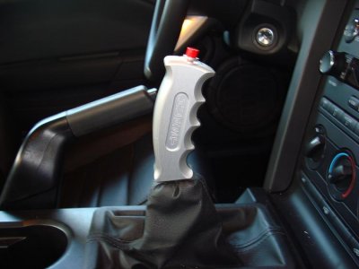

if you install the factory knob back on it will look stock , if you go aftermarket you can do like i did and cut out the rubber o-ring off the top of the boot and use a small tie-wrap to snug it down to the bar itself
