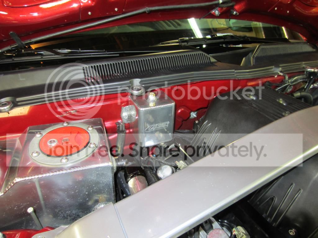

Finally got around to mounting the Canton transmission expansion tank:​

Thanks, but up close it needs a good cleaning!
I still need to find spots to mount an Aeromotive fuel pressure regulator and a 2 to 1 Y Block for the return style fuel system.

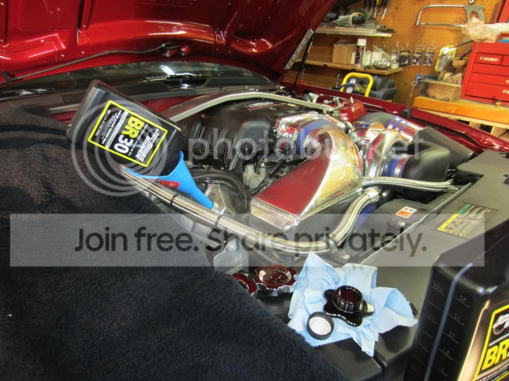

With 385km on the new motor did the first oil change today using Joe Gibbs Driven BR30 and a Ford Racing FL820 Filter, part number CM-6731-FL820.
Had to loosen the strut tower brace on the passenger side so I could move the coolant expansion tank over enough to get the oil fill cap on and off of the Moroso cam cover.

JPC's New tank would help you. I had the same issue with my canton tank . The JPC tank has a front of tank location on its hole and is slimmer at the front which allows you a lot more room for oil cap removal and filling. You can order it unpainted/coated and get the same appearance as what you have now

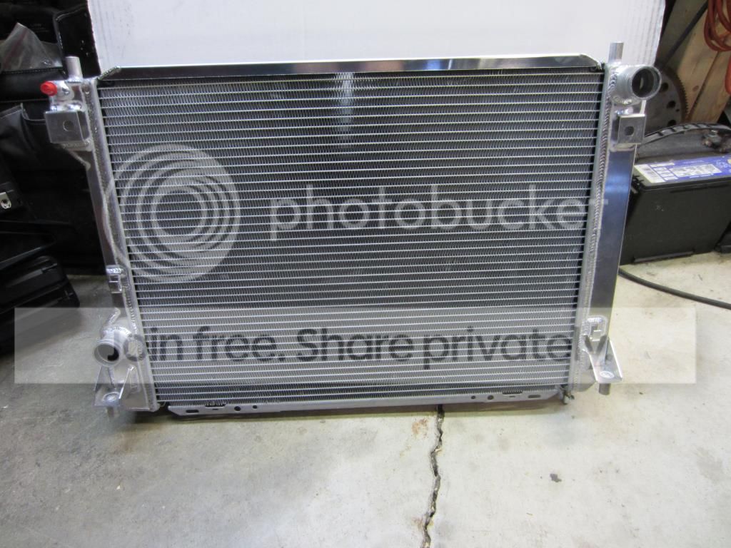

Upgrading the Cooling System – when the new motor was assembled I put in a Hypertech 160 Degree Thermostat, now adding an AFCO Mustang GT Performance Aluminum Radiator and a SVT Performance Cooling Fan
• Ford Racing 2005 – 2013 Mustang Performance Cooling Fan, part number M-8C607-SVT
• AFCO High Performance Aluminum Radiator, part number AFC-81281-S-AN-N

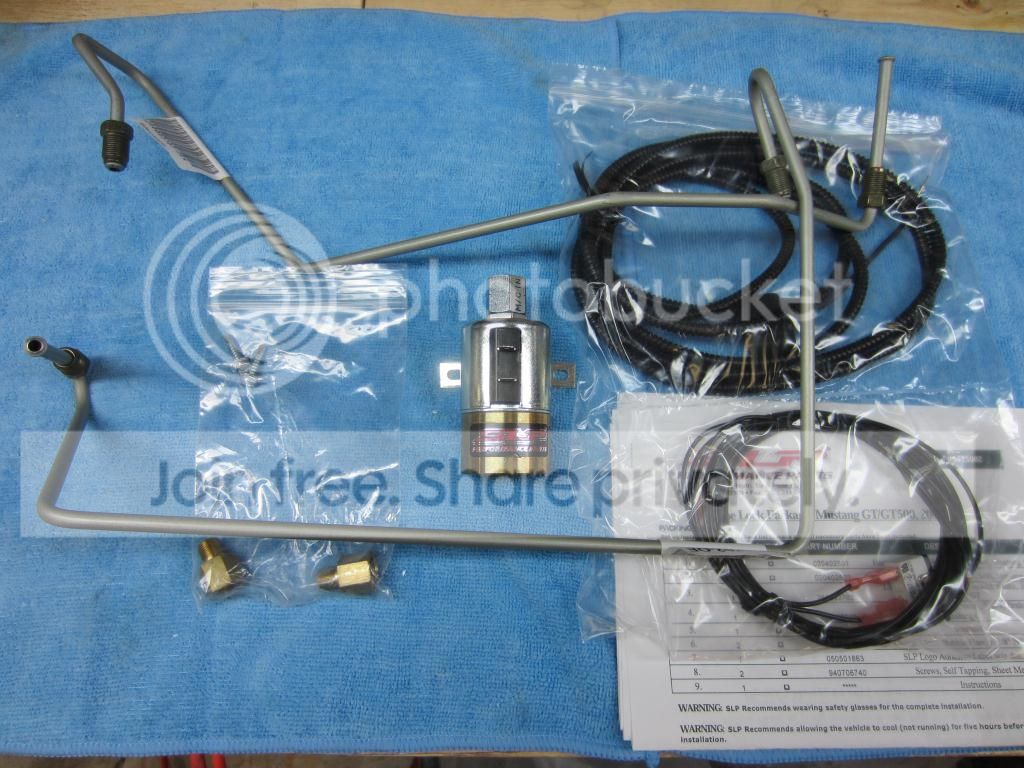

• SLP Line Lock Kit, part number M25002

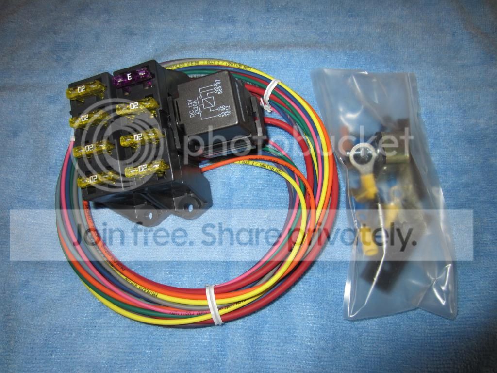

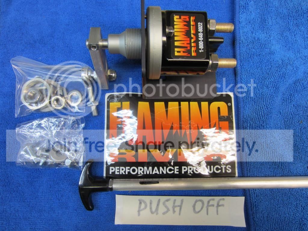

Electrical System Upgrades – when I relocated the battery to the trunk I did not install an external shut off. Going to add one now and also an auxiliary fuse block with room for seven new circuits. When the new motor was installed I did not relocate the IAT sensor to the intake manifold, will address this now and assess the use of a PMAS HPX MAF Sensor with my tuner (MattD).
• Flaming River Battery Disconnect Switch, part number FR1003-2
• Painless Performance Products Auxiliary Fuse Block with 7 Circuits, part number 70107
