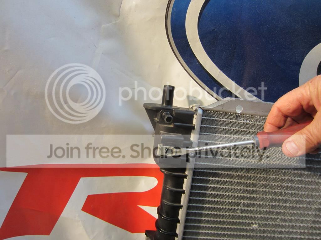

Finally got the radiator shoe horned in today. Only -6C degrees in the garage.
Started with transferring the 8 “U” nuts from the OEM radiator to the AFCO radiator.
Fastened the Transmission Cooler to the AFCO radiator with the supplied M6 x 16MM bolts provided and connected the cooler lines with new stainless steel hose clamps. Removed the ECU connectors for extra space.
Installed the AFCO radiator on an angle at first down towards the driver’s side and lowered it into the bottom bushings of the radiator support.

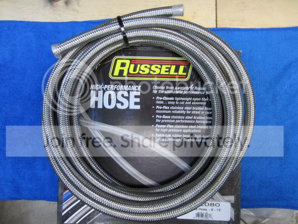

• 1 @ Russell ProFlex Stainless Steel -8AN 15’, part number 632130
• 1 @ Russell ProFlex Stainless Steel -6AN 15’, part number 632080

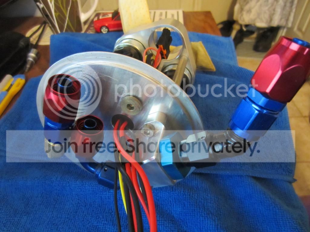

Fuel Hat and Pump Components:
• 1 @ Fore Precision Triple Pump Fuel Hat, part number unknown
• 2 @ Walbro Fuel Pumps 255L/HR with filters, part number GS342
• 2 @ Fore -6AN 90 Degree Fittings, part number unknown
• 1 @ Fore -6AN Billet Return Line Adapter with Cap Screws, part number unknown
• 2 @ Russell Straight Full Flow Hose Ends AN-06 Red/Blue, part number 610020
• 1 @ Russell 90 Degree Full Flow Hose Ends AN-06 Red/Blue, part number 610160
• 1 @ Ford Fuel Pump Seal, part number (CG-805) 3S4Z-9276-AA

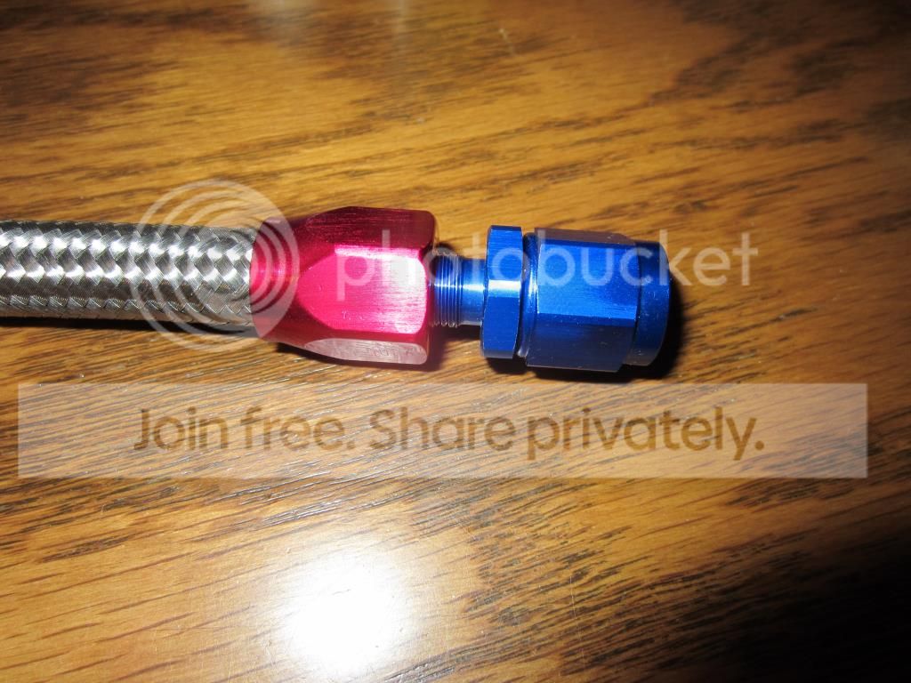

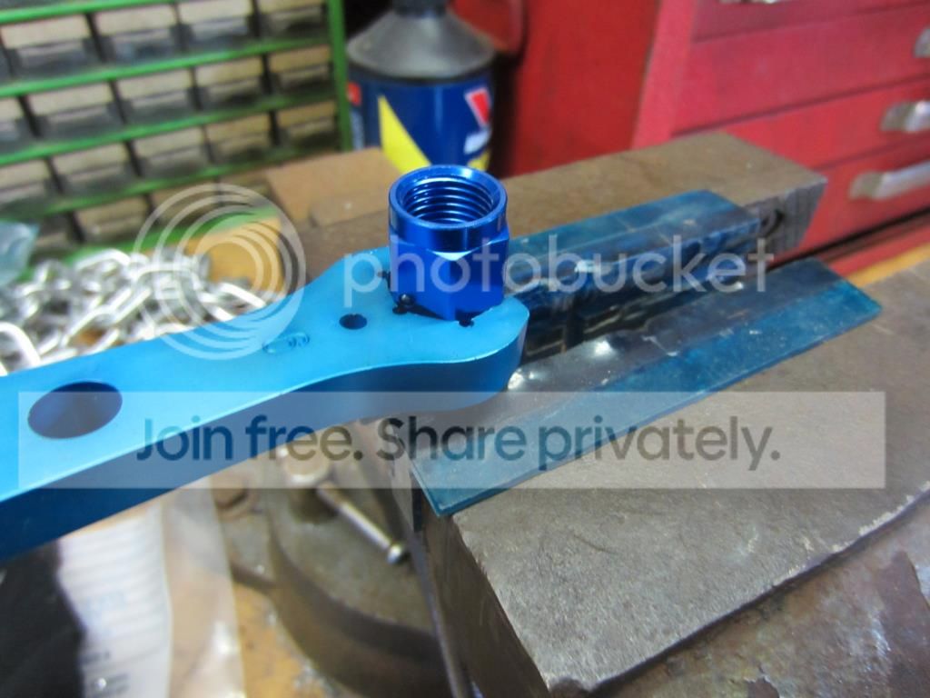

Hose Assembly
Here is my story .....not sure if my luck is any better or worse at cutting stainless steel lines than yours, but no matter how I try to cut it I always end up with frayed ends. In the past after securely wrapping a couple rounds of electrical tape I have tried a single fine tooth hacksaw blade, two fine tooth hacksaw blades installed in different directions and a large electrician’s cable cutter. Always I end up with the same results; frayed ends and one hell of a time inserting the hose into the fitting with blood donor free results. Well the other day while walking through Princess Auto I saw a 6” cut off saw with a very thin metal cutting abrasive wheel and a little light went on in my old brain. Tried the saw and I am very pleased with the cut. Non load speed of the wheel is 7,400 RPM and I went slowly. Pictured here with tape removed.
So with a clean cut it was easy to assemble a couple of 26" 6AN hoses to run from the fuel hat to the under car Y-Block.
A little assembly lube was applied to all the threads and the hose I.D.
Hose was screwed counter clockwise into the fitting hose end until it bottoms out.
Adapter end was screwed on as far as possible by hand.
And then finished off in a soft jawed vice with a 6AN wrench.
Completed hoses.

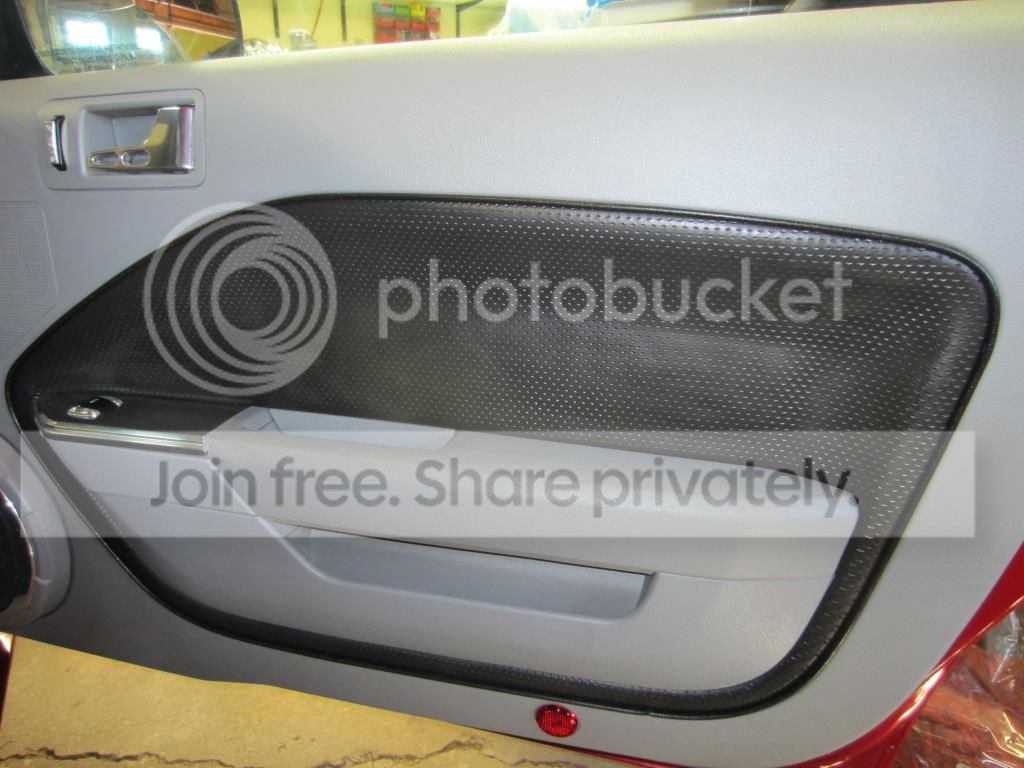

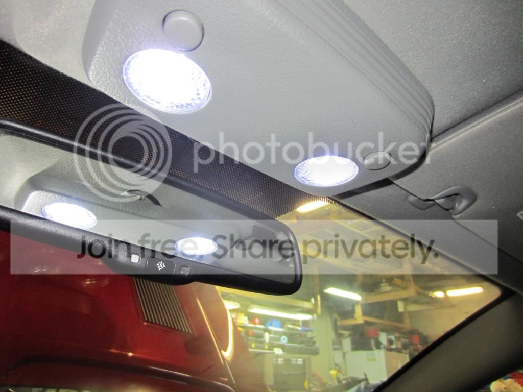

Hip was killing me last week, but not too bad so far this week. Managed to complete a couple of "Heavy Duty" mods to the interior. lol
Added black door welt:
Swapped out the OEM map light bulbs for a pair of "bright" white LED bulbs, thanks to JP at MMS:

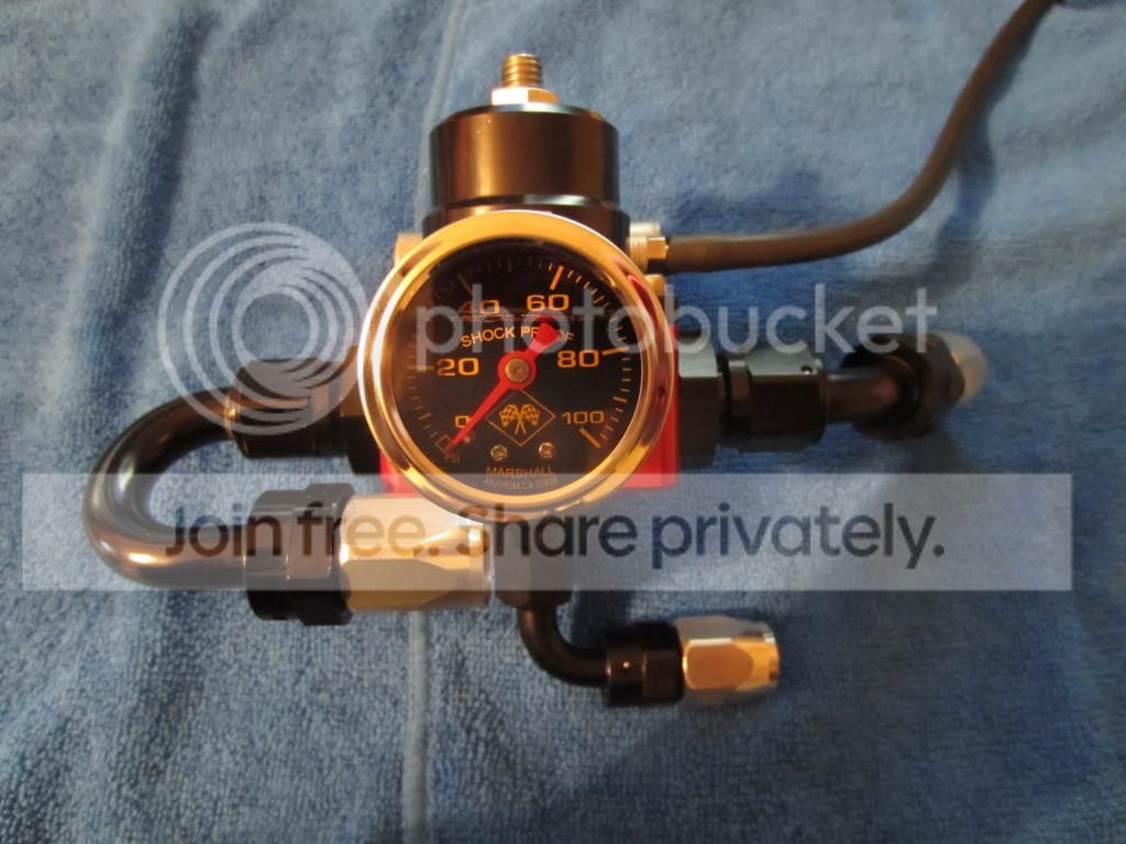

Cut a piece of aluminum for a mounting bracket to attach the fuel pressure regulator to the little tab on the driver’s side shock tower as Timmbo and BlownGTvert have suggested. Not sure if all the fittings I have are going to work yet, but we will see. I had previously purchased an Earl’s 1/8” NPT 45 Degree Elbow Adapter for the fuel pressure gauge, but because of the mess in the garage I may not find it before spring.

^^ Nice bracket! I noticed you purchased an FC2 controller as well and are running dual pumps. With the FC2 both those pumps will be running full time all the time which will really heat up your fuel. The FC3 controller lets you stage on pumps 2 and 3 via a Hobbs switch so when your cruising around your only running one pump. Don't know if you've looked into that but just thought I would suggest it. Your build is looking great!
Scott
Nov 17, 2009
2,337
44
King City, Ontario, Canada
Tim now you tell me! lol
I didn't even consider the FC3 as I have not even in my wildest dreams considered making the kind of power that would require 3 pumps (even though I have a triple hat). Consequently, until you mentioned it I never even looked at the description of the FC3. Live and learn I guess!
Timmbo
Jan 17, 2011
2,067
TN
Sorry man lol. I just noticed your hat this morning with the two pumps. The way the FC3 works is pretty simple. You of course have the 4 ga power and ground feeding the FC3. Then splice into the white wire going the the OEM FPDM. Again I said "splice". Don't take the FPDM out of the circuit. It will cause issues. This new wire splice will be your 12V power feed to remote pump 1 on the FC3. To activate your second pump get a Hobbs switch. Run both leads from the Hobbs switch back to the FC3. Place one of the Hobbs switch leads to "remote pump 1" and the other Hobbs switch lead to "remote pump 2/3". Now when you go into boost the Hobbs switch will close and send the 12 V power from "remote pump 1" over to "remote pump 2/3" which will activate your second pump. The Hobbs switches from Fore engage/close at approximately 2 lbs of boost. This is really the way to go IMO.
blownGTvert
Feb 24, 2011
775
Zeeland, MI
I have a patent on that bracket! Lol. Looks great!

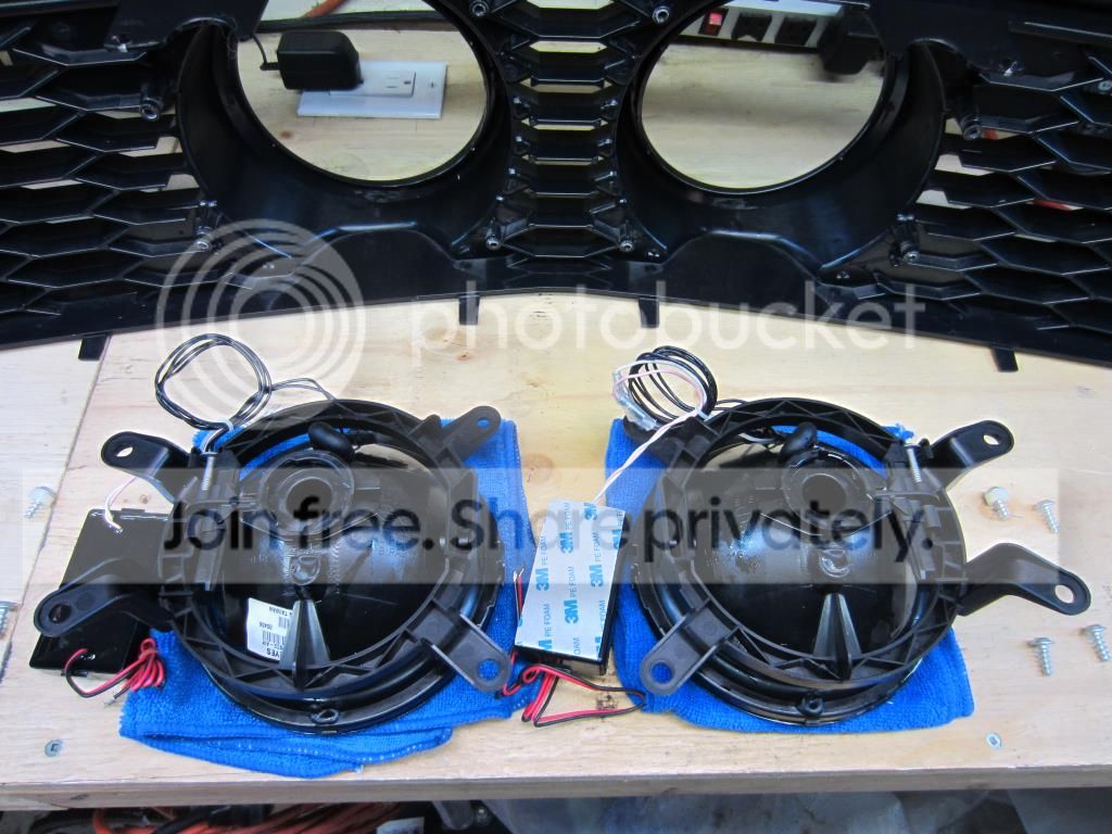

My hip replacement surgery is a week today and the last little while I have just been tinkering on the car and planning the mods for after recovery.

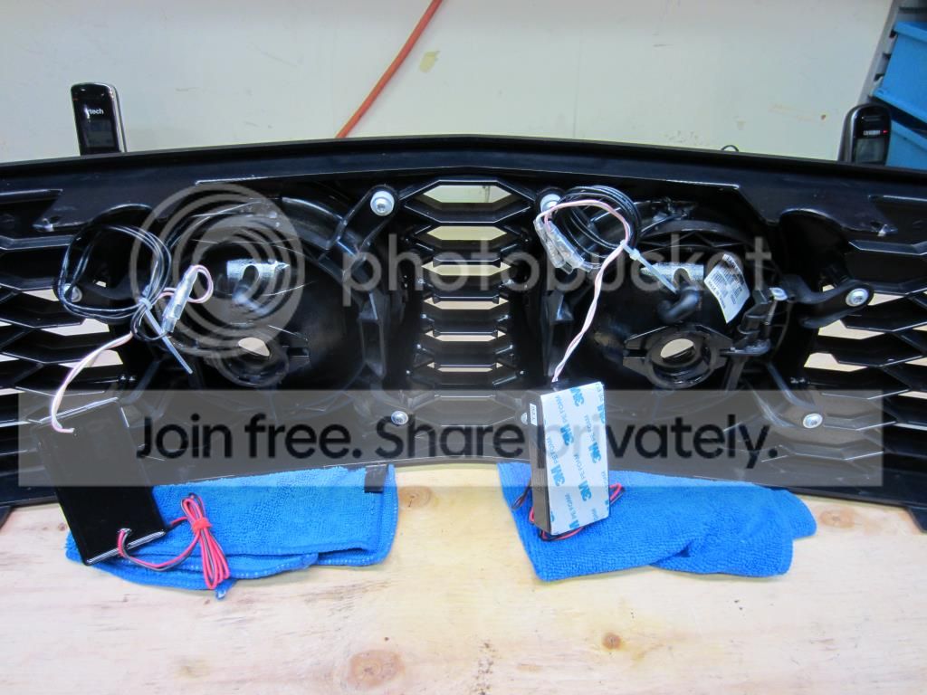

Did get some Raxiom Halo Fog Lights.
Street Scene Center Fog Grille with OEM Fogs (front and back views)
OEM Fogs removed with a T-25 TORX Screw Driver:
OEM Fogs removed from their mounting brackets:
Raxiom Halo Fogs out of the box:
Raxiom Halo Fogs popped into the OEM mounting brackets:
Raxiom Halo Fogs back in the Grille (back and front views):
Silvania Silverstar H10 Bulbs (9145ST)
Bulbs installed in the Grille with the new Fogs and when I am able, ready to go back in the car for the wiring:
