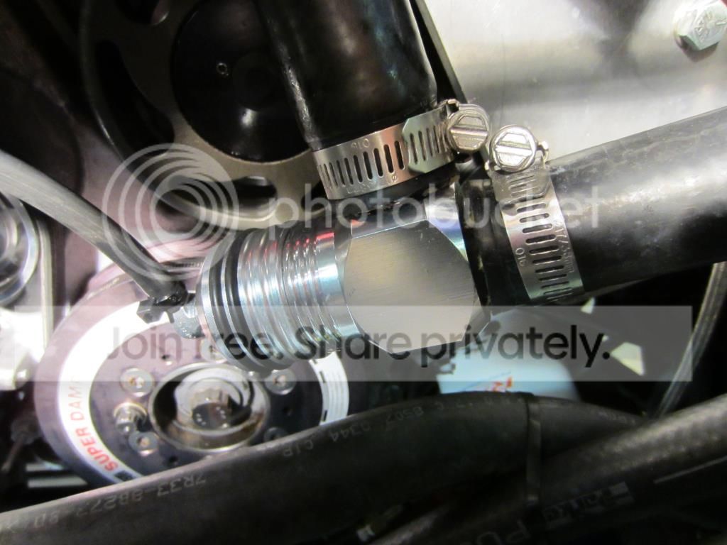

Turbo XS Racing Bypass Valve, Type H25 Installed
While the fan and radiator where out I took the opportunity with the extra space to replace the Vortech factory bypass valve with a Turbo XS racing bypass valve, Type H25.
Vortech Compressor Bypass Valve:
Turbo XS Bypass Valve:
