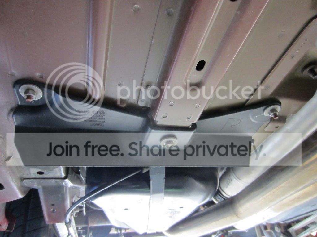

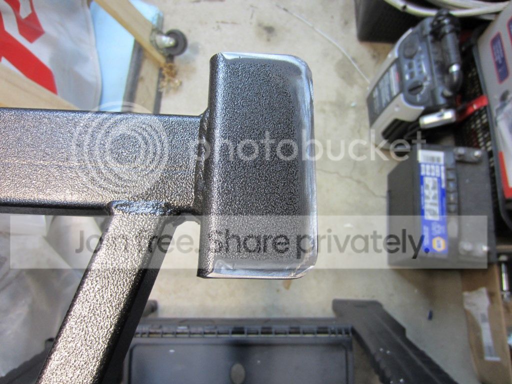

BMR Subframe Connector Install
BMR Subframe Connectors, part number SFC011 out of the box.

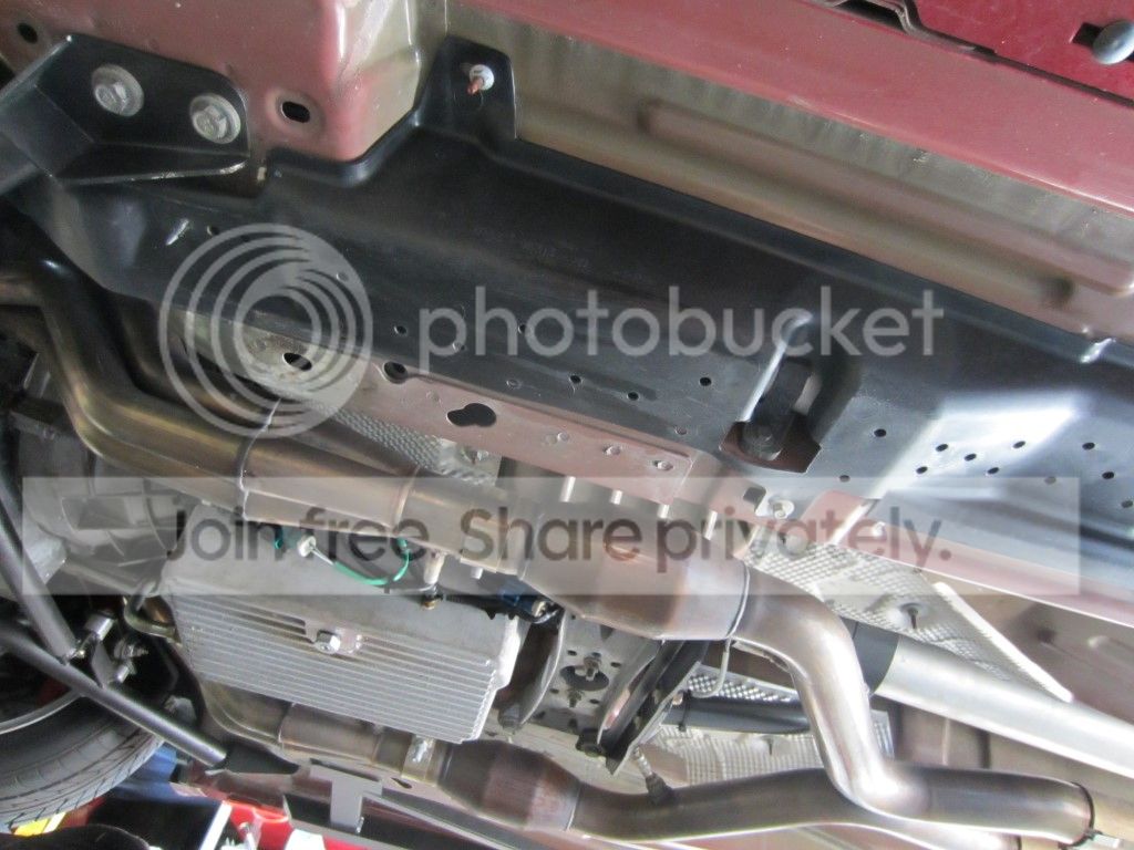

Passenger side of the car illustrated on all pictures unless otherwise noted.
With the car on 12” Race Ramp Wheels Cribs a 10mm deep socket was used to remove both parking brake cable brackets.
With a 13mm deep socket both heat deflectors were removed.
Using a 10mm deep socket the two bolts and two nuts were removed, a panel tool was used to release the three plastic retainers and then the driver’s side plastic fuel line cover was removed.

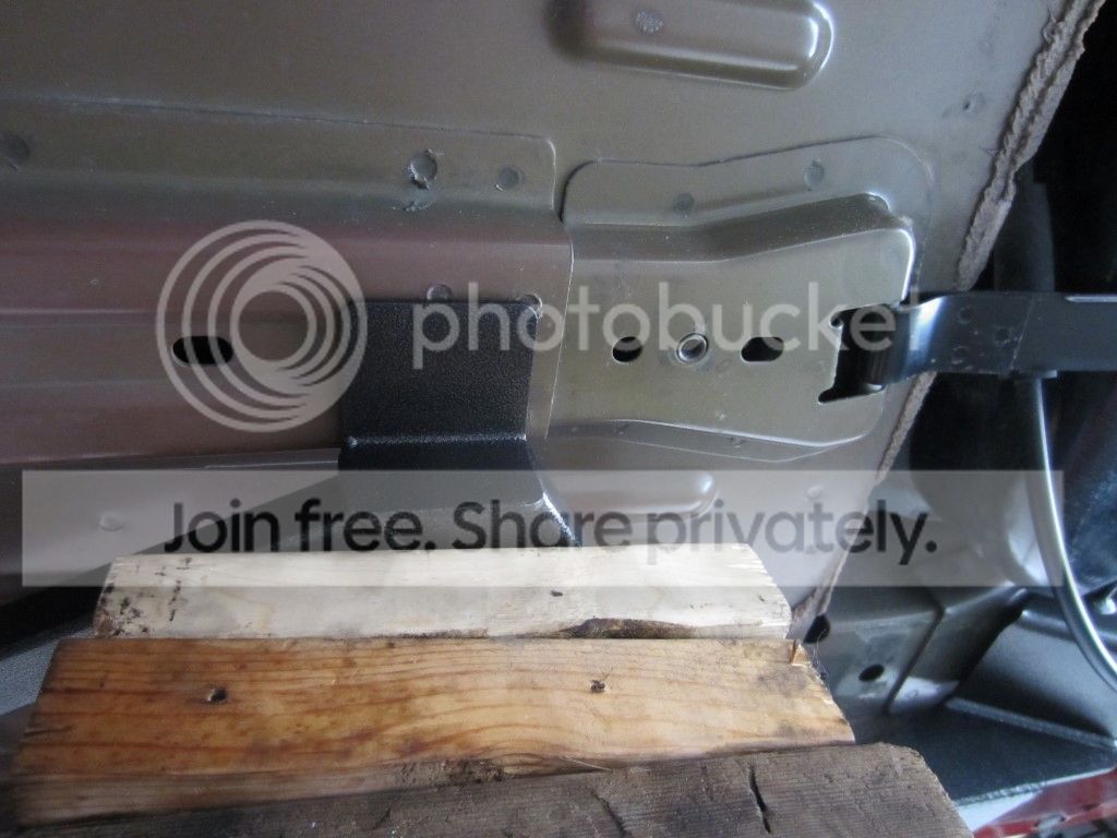

The passenger side subframe connector was lifted and held in place with a pair of floor jacks.

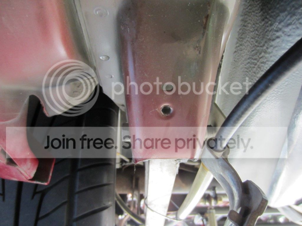

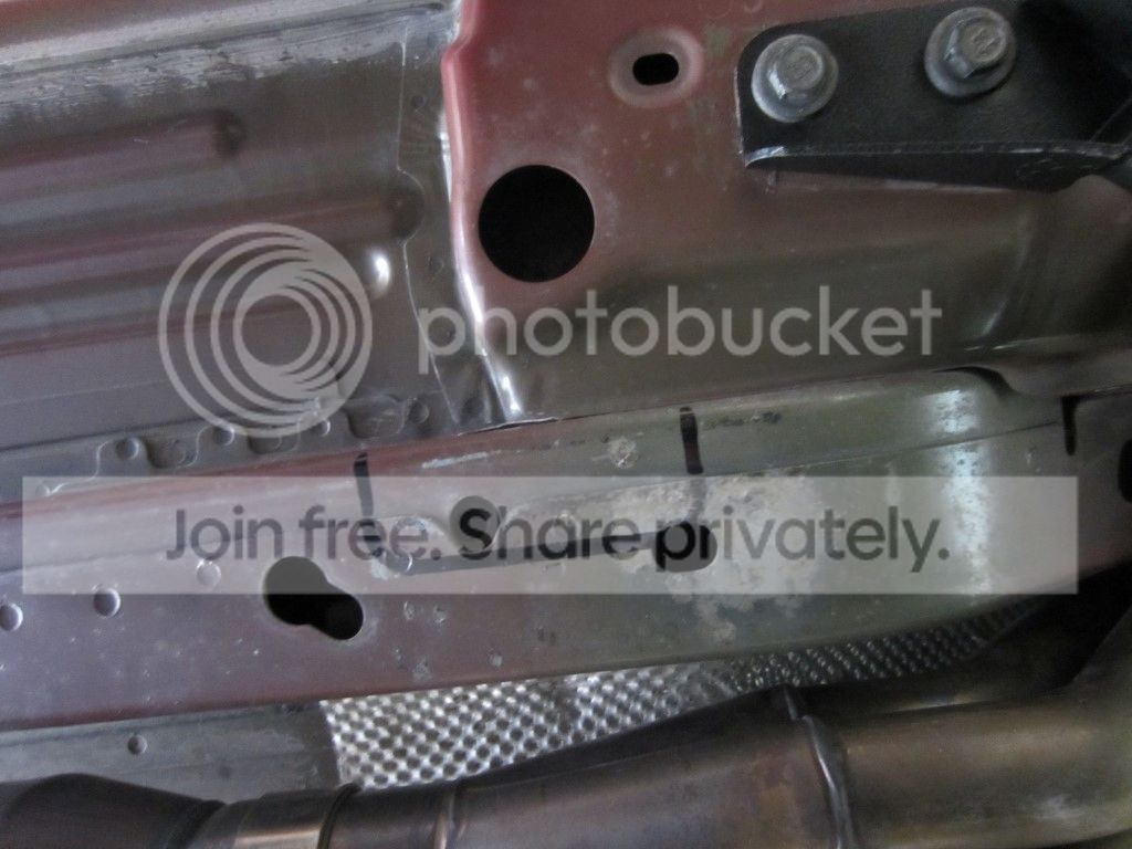

Using a marker all of the weld points were traced like this using the subframe connector as a template.

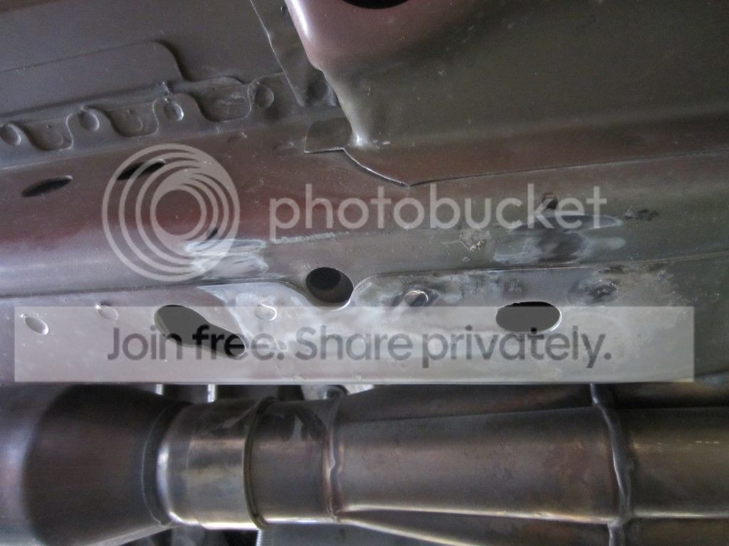

The passenger side subframe connector was lowered and the paint was ground off the weld contact points on the chassis.
And on the connector.
