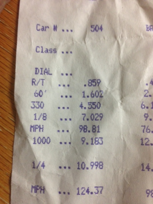

I went back to the track today now that I adjusted the LCAs and took the front sway bar off. The car still didnt hook.
I put a pair off 28x10.5 M/T slicks on and they hooked.
My best pass was 10.99 @ 124 with a 1.60 60'
Finally in the 10s!
The DA was 1700' when I ran so once it cools off here I should pick up some ET.
I still think the car should 60' better too.
07 GT WVB
4.6 stroked to 5.0-Saleen forged crate motor 127300 cams tuned by JDM
Edelbrock blower with 16-18lbs
5R55S TCI SSF with a PI 2400 stall
JBA shorty headers and granetelli 3' exhaust
3.73 gears with an eaton
28x10.5 M/T slicks with 17x6.5 and 15x10 Weld RTS wheels

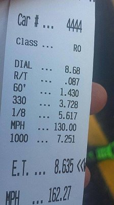

302
Turbo 400
Vortech JTi
20
3.90
M/T 28x10.5 Stiff Slick

Get that sixty ft down and you will see some 8.4s for sure. Congrats on your win and PB!
