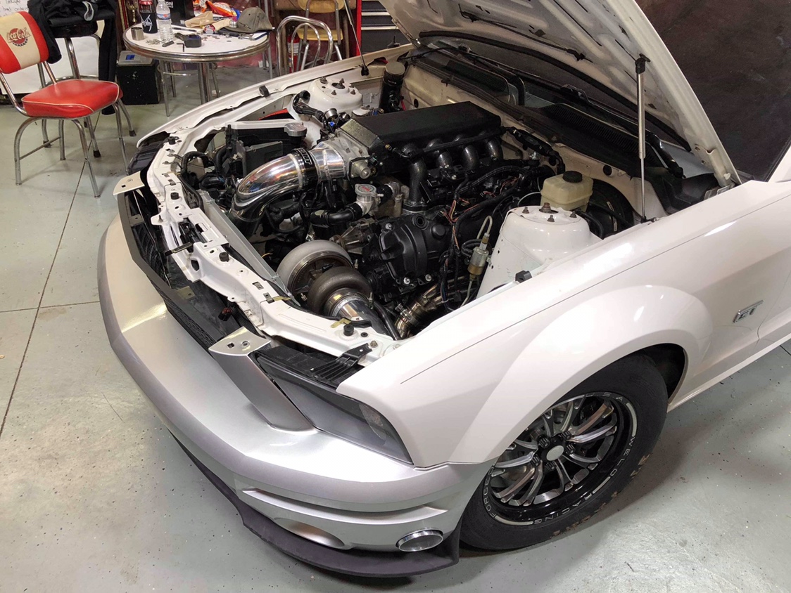

Well most of you probably know me with my ole blue car.
I went 9.4X with it at 15X with the 4R swap and Cast Vortech V7.
My brother passed away so I sold that car to buy his.
His is an 07 GT Premium. He bought it a few years ago. It had been through a lot, work done by Brenspeed. Has a Saleen extreme shortblock, hellion turbo setup, MM 6pt, and some steeda control arms and arb.
He modified the hellion kit for a VS billet 76mm and went blow through with gt500 fuel system on 93octane. He made about 600whp at around 14psi and went high 11s.
He sold that turbo setup and fuel system and was planning a big single forward facing build... but he passed away shortly after that.
So long story short I bought the car and sold mine. I got it NA with stock fuel system.
I had a Kenne Bell 2.6 Stage 2 on it, but pulled it when I saw the old blower from my blue car for sale.
So I bought my old cast V7 JT and installed it with some factory Vortech piping. I also bought and installed a stock 6060 with an RST. Slapped it together and had enough time to make one race. Went 10.97@130 off the trailer. Then the event got rained out.
Fast forward to now! I’ll just post some pics for you all to see.

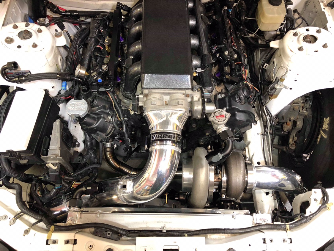

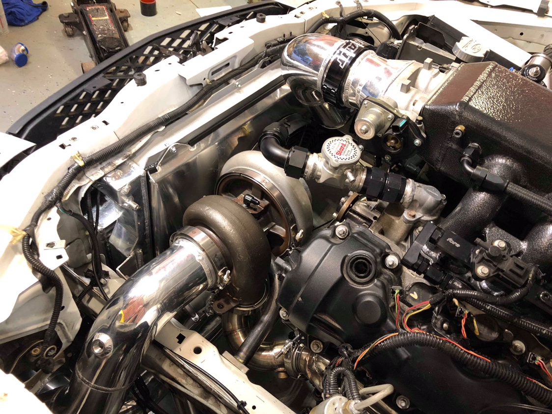

I love what your doing here. One question I have been wondering and I've seen it somewhere else before: .By routing the intake the way you did it looks to eliminate the cooling and and radiator. How are you cooling the motor?
NoviBlownGT
Boosted Crew
Jan 9, 2010
493
11
Marion, IN
I’m running a smaller but thicker ron Davis radiator. It’s positioned lowered and offset to the drivers side.

How'd that Sniper intake fit?
Fitment of the manifold it’s self is great. Depending on your throttle body and coupler setup it may contact the stock hood. Just slightly, still allows hood to close. You can remove part of the under hood support to clear without issue.
