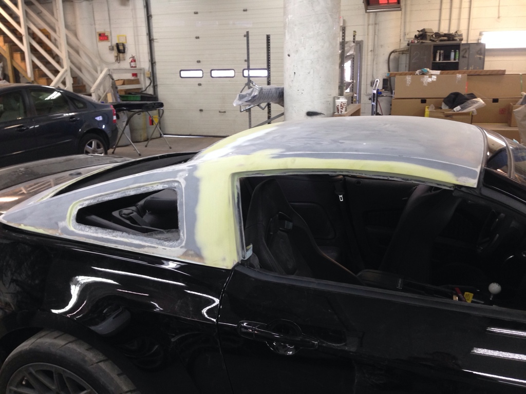

Any updates in the detachable roof? you're giving me a reason to have a convertible lol
I posted some pics in another thread. Should be ready at end of this week or next week. I would heavily suggest not doing this though. Way too time and money was put into it. I will post a complete write up with more pictures when I get the car back.
