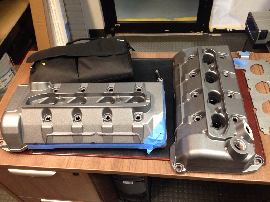

19COBRA93
Ford Racing
Dec 17, 2008
7,577
23
Clinton, Ut
I really like that color/finish on those. Looks great. I don't envy you having to put them on in the car though.
