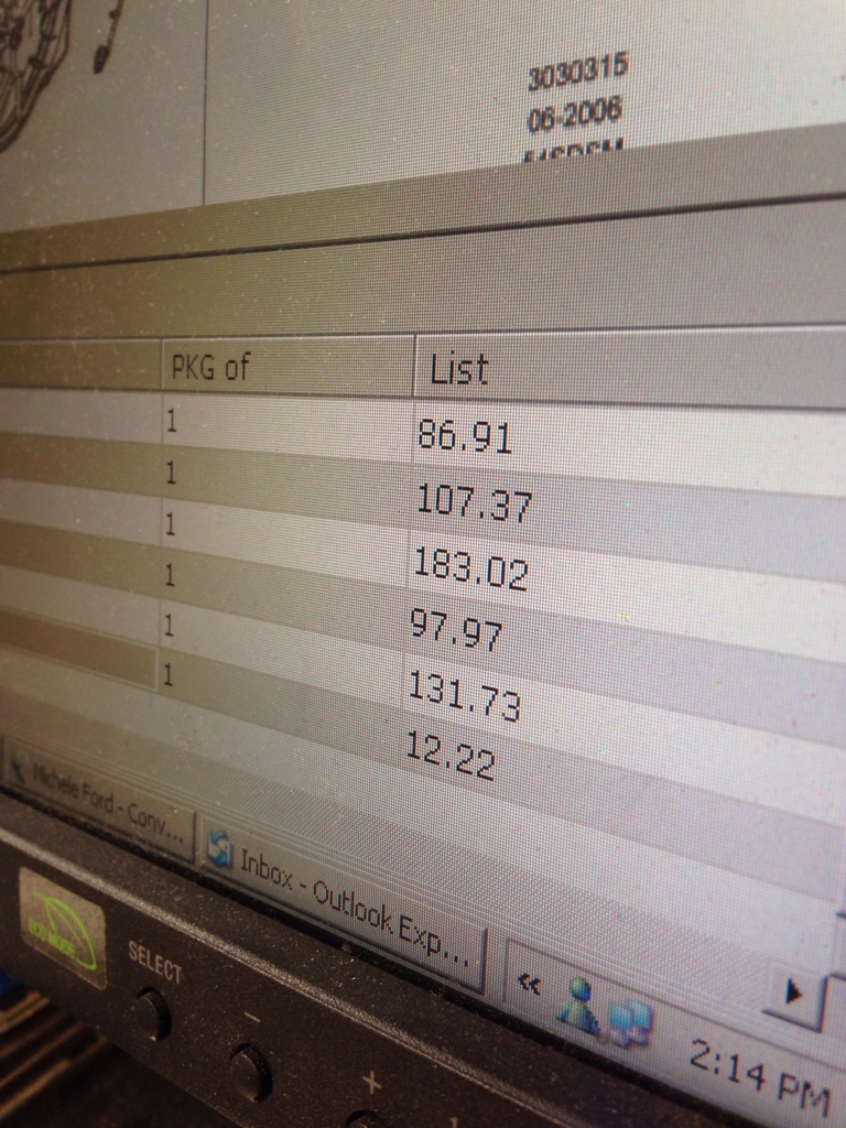

Ordered the remainder of the hoses for the car.... this is why if you do this project you NEED to get everything together... just a lesson of live n' learn
List prices for all of the HE hoses and the Radiator -> Thermostat Housing.

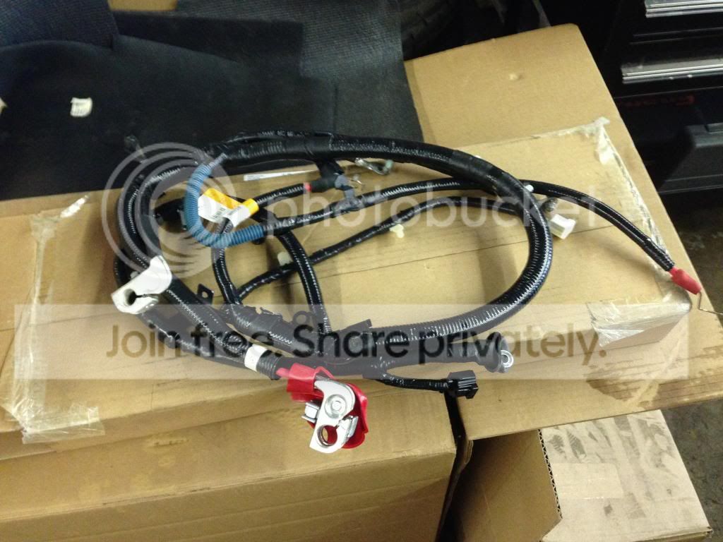

I also got in my battery/power harness for the engine, surprisingly less expensive than some of those coolant hoses I ordered.
It will be installed after the valve covers are reinstalled.

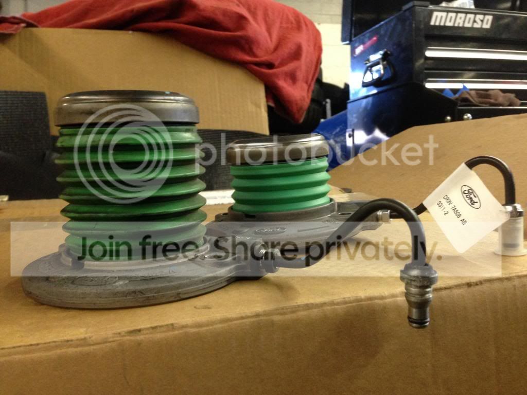

Also swapped out the stock 2007 GT500 slave master (pictured left) for the later model one. Major difference in height.
Should have the transmission bolted up tomorrow.

So how is the shorter throwout going to work? Seems to me if you use a throwout that's 1" shorter then you will be 1" short of being able to disengage your clutch.
GallopingFord
I'm Cam - Mr. Indecisive
Sep 5, 2010
15,369
10
Northern Virginia
I'm not 100% positive but I believe because the later model GT500's have a twin disc clutch, it is larger, and doesn't need such a long ToB/slave cylinder.
one eyed willy
Pizzle fo shizzle
Jul 1, 2008
7,533
26
Lakeland FL
2010 they changed the clutch and the TOB got shorter, long as your using a OEM 2010+ clutch that TOB will be fine. if your using any other clutch from before 2010 or a aftermarket clutch like a mcleod you will need a pre 2010 TOB.

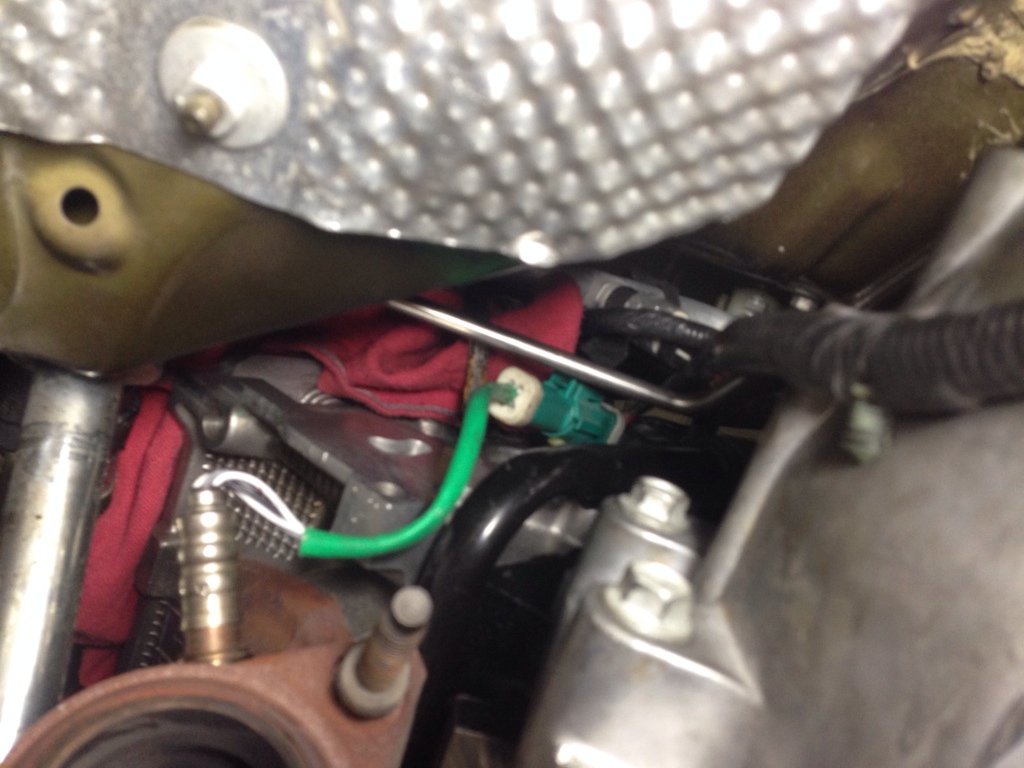

Does this look like a FRPP stainless clutch line? It does not look like the one online and I can't for the life of me figure out how this is routed
skwerl
tree hugger
Aug 6, 2011
16,348
1,334
central Florida
^ That looks similar but different from mine, Cam. On mine the solid end is about 8" before the first bend where it comes in front of the brake booster. The flexible end goes to the transmission bell housing. The only way that one would work is if it went under the booster.
GallopingFord
Sep 5, 2010
15,369
10
Northern Virginia

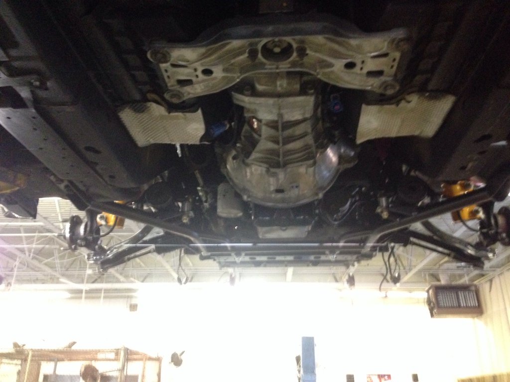

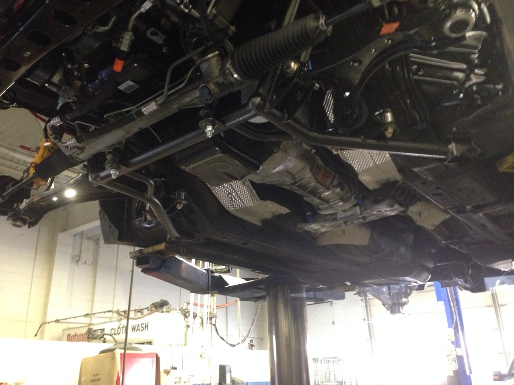

Alright. Well I got it to fit. When I sat and stared at it and saw what Brian said... I realized how the line makes a semi curl like it would wrap around the brake master cylinder. After some luck, I got it to fit. Not 100% happy as it is very close to the steering shaft and is against one of the A/C lines. I'll take a closer look next week.
Here are some pictures I snapped of the process.
You can see it in this pic to the middle right.
The path the line takes over and down the bell housing.
Plugged in

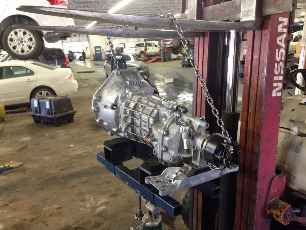

Obviously you can see I bolted in the trans today.
On the left
Becuz forklift
