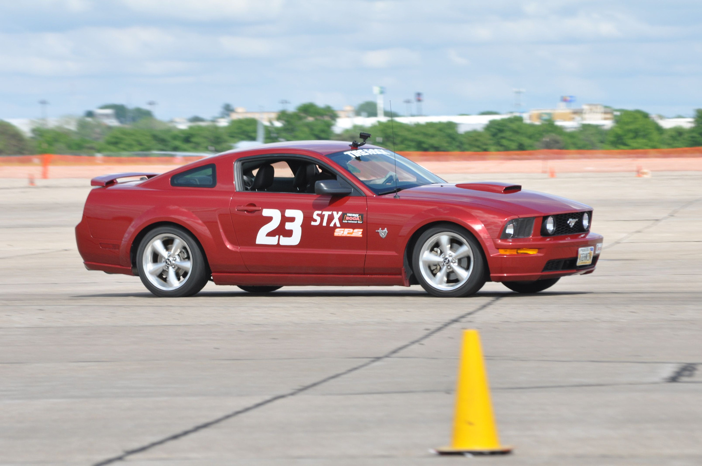

Terry, I'm on the same 245/45/18 Star Specs I've been on since last year. Pressures were 32 front and 35 rear which is because I forgot to swap the pressures after rotating the tires front to back. By the last run of the first "heat" they were at 32/33. The car already requires a little finesse when applying throttle but at 35 rear it required a lot of slow throttle input. Keep in mind, these pressures were set because I had a 220 mile trip there and a 220 mile trip back and none of us that went owned a portable air tank or electric air pump. It's on the list of things to buy. For Spring Nationals, I'll be back to 35F/32R. The tires don't quite have the roll over at higher pressures to be using the shoulders on the tires.
The Koni's (the "custom valved" ones not off the shelf Yellows) on the Ground Control coilovers (440F/200R) were set at a half turn (of only two available, surprisingly) from full stiff. The rears were at 3/4 a turn from full stiff (also of only two available full turns). Any tighter on this course and it might have responded quicker, but honestly, I tried full stiff and a quarter turn off stiff and kept backing them up at the test'n'tune and beyond where they are right now the car either loses traction on direction changes or doesn't respond very quickly. The car is setup to run on National style courses, this course was tight enough that some of the slalom cones would barely be far enough apart to park a car through them.
The other thing to keep in mind is that the steering racks on the 05-10's are not the same as on the 11+ cars. We are all hydraulic, you have (and can keep :p) that EPAS nonsense. I don't think our racks are as quick as the 11+ cars are though. I know my friend (the Evo driver) made comment at the test'n'tune that he had to turn the wheel a lot to get the car to turn as far as he needed it to. It wasn't understeer though, it's just he's used to the quick rack on his Evo which goes from lock to lock in basically a 3/4 of a turn in either direction.
Right now, the car setup is the same as on the first page, Ground Control Coilover kit with their track/school valved Koni's, 440 front springs, 200 rear springs. Strano 35mm front bar set in the middle position, stock 20mm rear bar, Fays2 Watts link with the pivot bolt in the "up one from center" position. On the more open National's style courses on the Nationals concrete this setup is reasonably neutral with a touch of steady state understeer and throttle induced oversteer just a little more gas away.
As for the hands, I think, and you can correct me if I'm wrong, the majority of the reason for this was how tight the course was. Honestly, I was shocked at how tight the course was. On the first post, video 2 and video 4, there is a lot less hand over hand, there is still some shuffling, and one incident of hand over hand, but it isn't nearly as bad as at this event. I dunno, it's something I don't find too interfering, the incident you are probably think of, I actually let go of the wheel since it was quicker than trying to muscle it back. I know, bad idea, horrible idea, and not fast, but with how quick the crap came up in this course, there wasn't much time to do anything else.
It's something I plan on working on at the next event, which I believe is on sealed Asphalt, so who knows how that'll go. I'm hesitant to make any car changes since I'm still learning from the coilovers change. driver mod will always be a work in progress though. This is the second event of year three for me so I'm still reasonably new.
As for the GoPro sound... well, it's not an HD model (Hey, I got it for 40 bucks from a friend) and this is what it sounds like with the sound set on the "Hi" setting:
http://www.youtube.com/watch?v=i4HLjvuYVkI
Are your ear's bleeding yet? Mine sure as hell feel like it! :) I emailed GoPro and was given the "update firmware, report back" response. Updated firmware, and it's not as bad as it was but it's still awful. Responded back that it didn't fix the issue and they said "it sounds Normal". No idea what the cause is, but I really need a new one and that noise is NOT normal from ANY other GoPro SD video I've heard. Sadly, the budget for this kind of thing has been spent, on coilovers. Until I find a suitable mount for my cell phone to use it as a recording device as well (that is what I used to do), I'm kinda stuck with the SD GoPro.
Live and learn I guess. :(
From the videos in the first post, does the car still look slow to respond? It doesn't feel that way from the driver's seat but I have no idea if it's adrenaline masking the feeling or if it is the video playback that makes everything feel slower than it actually is, or what. Needless to say, I'm all ears on this issue! :)
"Tires are everything in solo" - me
Those spring rates sound about right but I might go with a tick more rear bar. But don't make any major suspension changes until you get the correct 265mm width tires and 9" wide wheels...
Hmm, good point about the rack. Does anyone know the published ratios? I've only tracked in some 2005-2010 GTs (where the steering felt fine), except for a few autocross runs in an F Stock classed Shelby GT, which I've tried to block from my memory, heh.
As for the hands, I think, and you can correct me if I'm wrong, the majority of the reason for this was how tight the course was. Honestly, I was shocked at how tight the course was. ... I don't find too interfering, the incident you are probably think of, I actually let go of the wheel since it was quicker than trying to muscle it back. I know, bad idea, horrible idea, and not fast, but with how quick the crap came up in this course, there wasn't much time to do anything else.
Well, it might be something to work on? If you get a chance to do an Evo school they can and will work with you on wheel control. For autocrossing you need to have QUICK hands but good steering wheel discipline. If you have a slow steering rack you might want to teach yourself to shuffle steer.
PS: If you are willing to lift your embargo of the SCCA, I'd gladly welcome a Co-Driver for Spring Nationals! :D That is, if you can tolerate driving a 3440lb car on 245/45/18 Star Specs! :D
Hehe, thanks for the co-drive offer, and there have been a surprising number of offers for rides. Its not an "embargo of SCCA", I just don't have an SCCA Solo legal car at the moment and the NASA season is in full swing. We've been doing track events almost every weekend for months but luckily most of the track events take a break for July and August here in Texas (HOT!), then start up again for the Sept-Nov-Dec races. So during that summer hiatus we will do some regional SCCA Solo events, probably running our Mustang in StreetMod.
Good luck... and get some wider tires. :p

Hah, Terry, there is a good reason why I'm still on those tires. Since the Star Specs had plenty of life left in them I opted to continue to run those and spend the money on Coilovers this year instead of wheels/tires. I know, I know, stupid, but with the potential changes with the Mustang Classing in ST it made more financial sense to me to wait until next year to drop the cash on wheels/tires since fun money is very limited already. Had I bought the 18x9's and 265/40/18's this year and we get moved, then I'm already down on size for STU. If we don't get moved then I'd be fine but that is a lot to gamble on since it is starting to circulate outside of our group that the Mustangs are potentially being moved. This way I end up on the right wheels/tires for where ever we end up. I realize I wont be winning any National Championship on them, that was never an expectation!
When I say potentially being moved, my co-driver from last year is on one of the various RX8 forums and he said he found out about it from there and his comment was: "I saw that they are moving the Mustangs to STU, is that true?" Of course, we don't know for sure what, if anything will change for next year.
I found online that the FR500C cars used a 15.6:1 ratio rack which is supposedly quicker than the default 05-10 racks. Then I found someone saying it was the same despite Ford Racing saying it is quicker than the default racks. I also found that the EPAS rack on the Boss 302 is 15.9:1. I was under the impression that the Boss used the same crappy EPAS based rack as all the other Mustangs. I don't know. I did notice when I drove my buddy's 2011 GT that his rack felt heavier but responded to steering input a lot quicker.
Anyway, Terry, thank you for the responses. I'm going to make a concerted effort at the next event I attend to keep the hands at 9 and 3 and keep them there. My hope is that the next event will not be this needlessly tight since it's the same host region. We also had a problem with workers not showing up which is making me re-think driving out there even though it's only a 2 hour drive instead of 3.5.

Well, tomorrow is the big day! Spring Nationals is a full on go. The car is stickered up, passed tech, course has been walked and I am mentally ready to go!
The course appears to be very open and will be very fast. There are a few places that I imagine time will be made or lost but otherwise the course doesn't look overly technical. It certainly is a power course. Any and all help in STX is a good thing!
I will have my usual write up (minus MSN paint course maps, they have nice ones!) come Tuesday but I figured I would tease a little.
I'm not sure if there are any other S197Forum people at Spring Nationals, but you can watch Sam Strano and myself here:
http://www.ustream.tv/channel/sccasolo
And see our times here:
www.sololive.scca.com
STX runs heat 5 so we are dead last both days.

Realistically, your car is running on lowering springs and Konis with some last-generation 245mm Dunlops. At best your car is prepped to about what I'd call maybe... 60% of the max, and there's still quite a bit left to do. Yes, these things cost money. And take real testing to get dialed in, when you have more things to adjust than you do now (damper settings, swaybar settings, ride heights, camber and caster settings, etc). And I don't know anything about your driving skills or placement in previous classes/cars at National level events, but driving can always be improved - ask any top driver and they will agree they could always improve, too. Don't take that the wrong way - you've done a good bit, but it isn't nearly what the top guys in STX have done to their cars.
And if you've never trophied at Nationals before, go bribe a proven winner to co-drive with you at as many events as possible. Riding through with someone could lop seconds off of your run times, and/or they may see or "feel" something huge to improve on the set-up. If you lived anywhere near Texas I'd volunteer to co-drive with ya at least once, to see how far off of our STX car it was.
And the CRAP weather (it downpoured two out of four days!) from the Spring Rainfest Nationals makes comparing results in class almost impossible. This generated nearly worthless data.
Mustangs in STX, Mustangs in STU, and Mustangs in ST in general
Lets just be clear on this point, my experience at Spring Nationals is not indicative of an ST prepped Mustang, nor is it driven by anyone worth their salt so my results are not to be taken too seriously.
OK, we're with you there...
At this point, I am doubting quite heavily that any allowance the SEB/STAC would allow for live axle cars, heavy cars, whatever, would make a Mustang competitive in ST. Lets do some bench racing shall we?
Whoa, wait... bench racing. The dangerous thinking begins here. ;)
Assuming tire compound doesn't change (in this case it would be Star Specs), the time difference between 245's (what I'm on) and 265's (class limit) is about .75 seconds. At the end of day 2 I was 10.42 seconds behind the top guy and 7.51 seconds behind the last torphy spot. At 1.5 seconds total reduction, I'ms till 8.92 seconds behind the top guy and 6.01 seconds behind the last trophy spot. Even if the SEB/STAC where to open that up to 285's that time would only drop about another 1.5 seconds to 7.42 seconds off first and 4.51 seconds off. Even out to 315's, another 1.6 seconds off THOSE times to 5.82 seconds off the lead and 2.91 seconds off of the trophies. That is of course assuming a 60 second course of which these two courses kinda "washed out" to be in cumulative time.
You then go on to calculate how much time you'd gain with the right tire size, chassis weight loss, etc. After looking at results from a throw-away rain event. Hold on now! Where on earth do you get these factors and formulas? Me thinks from someone's rectum. ;)
Sure, there is likely some sort of gross factor you can put on the +20mm of tire you still haven't utilized (and the "why" still baffles me), but there is a lot more left to do to your car than than that. And while we struggled mightily in STX with our 430 whp Mustang, when we jumped to STU in late 2011 and added 1" of wheel width and only +10mm of tire width, the car WOKE UP. It went from a big hot mess always boiling the rear tires in an autocross run to a STU class winner and top PAX contender. There isn't some magical formula that is incremental in nature, sometimes a small increase has atypical results.
Anyone that tells you otherwise is blowing smoke. Sure, people spend a lot of time on the interwebs and tend to get a little "calculation crazy", but nothing replaces real timed testing at showing you what works.
That only focuses on the tires, how about on driver modifications and driver confidence from bigger wheels and tires? I honestly don't know how you could apply a time to it, but even at a very generous 1.5 seconds we aren't even within driver noise yet. It would REALLY have to boost the capabilities of these cars to kill over 5 seconds to be even in the same ballpark as the top contendors are. Then we have weight reduction possibilities too. There is about 165lbs (being generous) of weight to remove that are allowed in ST for this car. That translates to about 2% reduction in time on a 60 second course or 1.2 seconds.
And what about the SUSPENSION, that has barely been modified from stock!?! This area still has immense potential on your car. :beer:
These above calculations are very very hard to substantiate and are, at best, a blind stab in the dark. Now even though I agree with you that the S197 has a lot more to potential in STU (with a potential upgrade to hopefully a 315mm tire) than in STX (on a 265mm tire) I don't agree at all with your calculations. The hard truth is: your 10+ second time detriment wasn't just tires. To make even an educated guess on what "time amount" is left, you would need to prep the car to the limit of STX (headers, exhaust, cold air, weight loss, seats, max width tires and wheels, the latest tire compound, real shocks and spring rates, lots of camber, real testing) and then take a proven driver and throw them into a "big" event... that was dry. None of those things have been done here, sorry. Don't jump to conclusions on poor data.
MOOT! hehehe...
It would seem that with a good driver, unlimited wheel width and 315 street tires that the 05+ Mustangs might have a potential course dependancy. I would LOVE to see the complaint letters if the SEB/STAC ever approved such a measure for Pony Cars and I'm sure it would generate a ton of animosity there too as another one of THOSE "Pony Car" allowances.
To me, such a move sounds like something STU could support. Rather than making this a pony car specific allowance, why not open up all 2WD tires to unlimited width in STU, move the Mustang and any lingering pony cars from STX to STU and let us duke it out with the boost buggies (admitedly on 245's). IIRC, and please, DO correct me if I'm wrong, the M3's are pretty limited in ST trim on wheel widths and the Littlehale M3 to somewhere around 275's and maybe 285's if you let the rubbing move the fenders or whatever you want to call it. I get it, I get it, I get it, STU is FASTER than STX but it doesn't make sense to open up the wheels/tire allowances in STX when STU is pretty much there and the nearest competitor to the STI and Evo can't even run the currently allowed class maximum size.
One of these things is not like the other... S197 at left, E36 on 315s at right.
Well, you are forgetting one massive factor: the Pony Cars generally all have SOLID AXLE rear suspensions. Horse and buggy stuff when compared to the 5-link and IRS bits on most 2WD cars in STU, like the BMW E46/E36/E82/E90 chassis cars. There simply is no comparison. If you gave all 2WD cars 315mm tire limits in STU, I'd tell people to go build an E46 M3 for the STU, RIGHT NOW. And those E46 M3 cars can fit that much tire with the grey rules in ST regarding "fender contours". How else do you think people managed 10" wheels and even 285mm tires on skinny little E36 M3s, that came with OEM front 225mm tires!
Left: STU prepped E36 M3 on 18x10" wheels and 285/30/18 tires. Right: My own STU prepped E36 M3 on 18x10" wheels
For that reason (solid axle), yes, the "pony cars" do NEED something extra. The 315mm allowance is part of the answer, and I doubt that this alone will be enough to close the gap to the AWD boost buggies. But it will make these V8 pony cars immensely more driveable, and pleasurable to autocross, instead of feeling like you are skating around on ice.
Project Tilty may be coming to a close. It takes some pretty hardcore stupidity and dedication to continue to fight a battle that can't be won. I'm not even sure the car could trophy at this point. That seems like a convenient cop out for someone to use when they get their ass handed to them but looking at the time split, even with alien like driving abilities and maxed preparation, I don't think any allowance will get the car there.
Again - you've barely scratched the surface on Street Touring prep! :( Don't throw out the baby with the bath water. One epically bad results doesn't give you enough data to make such a drastic change. You'd need to do as much and MORE to win in ESP than you would in STX. Trust me on that one...
...the general consensus was still the "no duh, go play in ESP". They made some compelling points about buying used A6's and running on those instead of continuing the fight in ST. The switch would only require wide A6's and wide/light wheels. My concern will always be on cost both in the short term and long term and this was the primary appeal of ST.
To switch to ESP will raise your per-run-costs dramatically over an ST class. Again - been there, done that. You might want to ask people who have run both categories (ST and SP) in the same car that don't have an ax to grind against one category. And I include myself here: you know I've had a beef with the S197 in STX classing for a while, too. ;)
Even buying "used" A6s (which are falling off a cliff after about a dozen runs) you aren't going to "save money" by upping to ESP. I'd recommend new Kumho V710s if you want to run SP on a budget. But also remember that the allowed mods are even MORE extreme in ESP than in STX/STU... and those folks at the pointy end of the grid aren't running on Konis and lowering springs in ESP. They have A/C-less, purpose built race cars without emissions, "hybrid" drivetrain swaps that never existed from the factory, high end shocks, goofy aero mods, the HUGE FREAGIN TIRES.
You should search out and ask Tim Bergstrom (owner of the car above) about the switch from STX to ESP in his 2006 Mustang GT. Very similar to your car, except he went much further in STX than you have so far. His car placed 2nd at Nationals in ESP last year but it is a LOT further along now than he ever was in STX. No A/C, massive car diet, 1000# springs, real aero mods, and the like. Ask him if running ESP is "cheaper"...
It would mean giving up on going to Nationals if I did. No guarantees that I'm going now either though.
Well, sometimes these events are a wake-up call and you shouldn't go to Nationals, if your goal is to win or trophy. I figured that out in early 2011 - we were hopelessly outclassed in STX even Regionally, plus they were still allowing the STS Hondas to "Class Swap", so we bailed on Nationals. It was the right call for us at the time, but it still sucked. You being 25th out of 27 pretty much tells you that your chances in ST or SP at Nats this year ain't good, unless you win the Powerball or make some "life changes" that allow a lot more seat time, mods, and testing. Sometimes not going is the right call...
Anyway, a move to ESP will most likely happen sooner than anticipated and as soon as next year. In doing so I will have to forgo any other planned mods than wheels/tires for next year (assuming no changes to finances) since I will most likely have to buy new street tires to drive on since I doubt the Star Specs will survive this season. That decision wont be made quite yet though. I'm still interested in hearing what, if anything, the SEB/STAC does.
I hate to see you throw out all hopes and aspirations for ST from this showing. Again, look at what you've done to the car (and not) and then ask yourself - will jumping to ESP somehow obviate the need to do these things AND MORE to be competitive? I saw what it was going to take to win ESP - a purpose built race-only car, that we would have to be willing to cut up/flare, yank the A/C and emissions from, and exploit every update/backdate loophole.
ESP is fun, and giant R compound gumballs make the car easier to drive, I won't lie, but it is by NO means a "cheaper" way to autocross than Street Touring. ST is -the- most affordable class to build for, bar none. I would have said "Street" class, but they just butchered that proposal and it is now just "Stock with Street Tires", and the costs-per-run will still suffer greatly on many cars without special-model camber allowances. :(
But don't take my word for it (someone who has built an S197 for both STX and ESP). Ask Tim Bergstrom. Ask anyone else that has built for ST and SP in the same car, and took the prep/testing/mods very seriously. Sure, asking people who haven't run ST seriously and they will give you semi-informed opinions, but like many hard lessons on the interwebs, "all opinions are not equal", because all expereince levels are not equal. I think the consensus among those that have done both seriously will be that ST is a far more affordable route to take than SP, if you want to place well at Nationals events. ESP is easier to set-up for than STX, but the main problem here is... the car is classed wrong in STX. That is the area we all need to pressure the SEB/STAC on. If/when this car moves to STU (and gets a bump in tire maximum) things will be a lot less painful for these cars. :naughty1:
