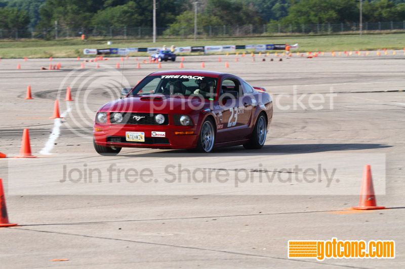

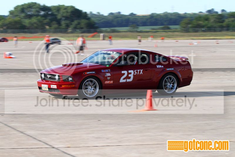

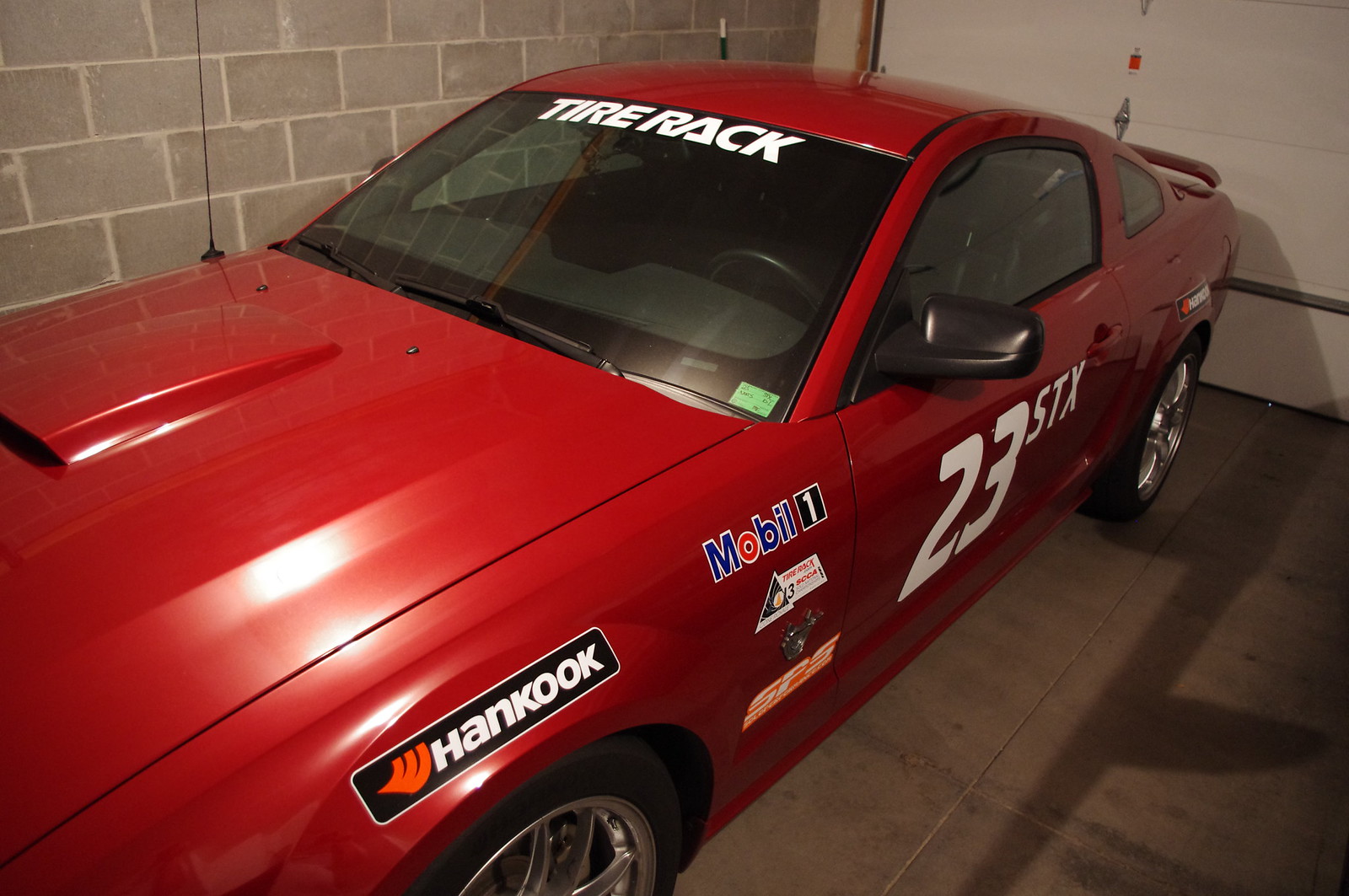

Pre-Nationals Teaser Photos:
All stickered up and ready to go!

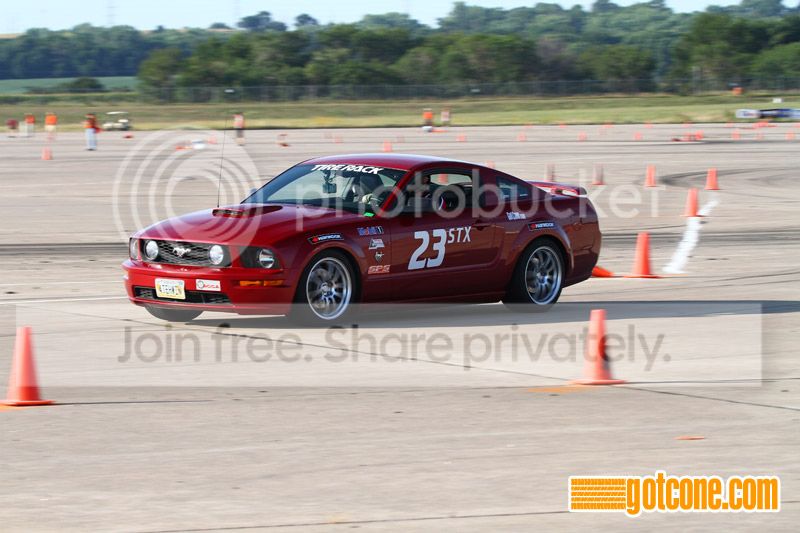

2013 Solo Nationals Day 1:
Day 1 would start with pretty tolerable weather (heat 1 workers were probably loving it) so I decided to get another course walk in before we started to run Sam Strano's East course. I had picked out a few key cones, remembered a few of the Evo Course Walk cones and made a game plan to not suck! :)

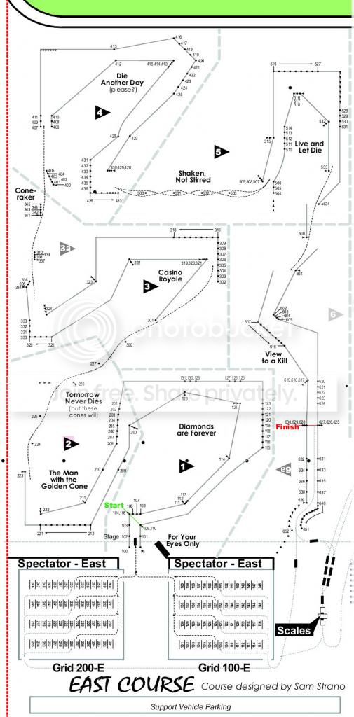

This is the course map, it's better than my MSN paint drawings and a heck of a lot more self explanatory:
Some notables on this course: Lots of big braking points and not a lot of difficult transitions. Most of the stuff on the course was visually open so the keys were to get the right line and find the right braking points. The optional slalom wasn't but thankfully you were already "shut down" right before it so there was PLENTY of time and grip available to make the corner without fuss and get on the correct side of the slalom.
Run #1 came awfully soon after I got back from the course walk and boy was I glad. I've had the jitters all week going into this. I was confident and ready to strut (horrible pun) my stuff and this car's capabilities to the whole of the STX world and flaunt it in the face of those who I beat (just kidding on the flaunting part). Run #1 ended up coming in to a 98.9XX something... no way that could be right?! "There's been a timing error so a few cars are going to get re-runs." PHEW! A free look at this course at speed at a National event!
Run #2 didn't take much longer (5 minutes really) to get to and I had all the "mistakes" I made in my head from Run #1 to correct. Most of it was not fast enough/braking too soon. I managed to get all the way around the course and in the final slalom a downed cone, SLAM on the brakes and point to the downed cone... corner workers didn't even flinch... continue to point to the downed cone as I roll by it, FINALLY someone starts to go get the cone so I took off and finished the run. 88 something IIRC and ANOTHER re-run! Sweet! Two free looks at the course at speed, warm tires and a power friendly course?! WHAT COULD POSSIBLY GO WRONG?!

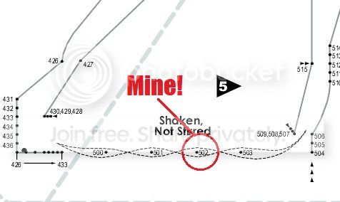

Run #3 is what went wrong, well, more specifically cone #502 in the optional slalom is what went wrong. The car felt great, hit all the braking points, got to the optional slalom and walloped #502... damn... it's ok, two more runs to go, clean it up and you'll be fine. I ran a 81.058 but the 2 second cone penalty brought it to 83.058.
Run #4 I got a little greedy on some parts of the course, particularly going into the back sweeper which was WOT from basically the start of the wallom before the sweeper to the braking point IN the sweeper, FAST! Like 63 MPH fast! I got down on the brakes and when I turned in the car 4 tire slid out wide and nearly took out the cones at the exit to the turn. I guess the tires are hot?! I made it all through the course, got back in and got the time slip and it was an 81.981 which was at least clean, but a second slower than the previous run. I think this time on solo live had me in like 43rd place or something. I was stoked! Not DFL! :D
Run #5 I set out to fix the errors in 4 by braking a touch sooner to get around that back sweeper's apex cone rather than slide out and nearly kill them and I did manage to make less errors on that run. I came in with an 81.257 which was a good solid run!
However... I didn't know this until the grid sheets came out after impound, but I coned the last two runs away. I honestly had no idea as I don't remember any cone hits on those runs?! That was a bit shitty feeling. While I was waiting for my work assignment I went and looked at the corner sheets, turns out I hit cone #502 in the optional slalom on EVERY SINGLE RUN. What the hell are the odds of that?! I guess I made cone #502 my bitch! Now I want that as a shirt! Hell, I may make a "fake" racing team out of it "Cone 502 Racing". How frustrating. This would pull me all the way down to 55th of 59 going into Day 2. Good news is that I was not last going into day 2! :)

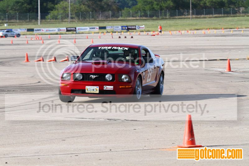

2013 Solo Nationals Day 2:
Day 2 had a more positive start. I wasn't in last place going into day 2 and I had a course that was more my style of driving. It may not have been a particularly Mustang or power friendly course but the much smoother transitions rather than the hyper violent brake/gas/brake/gas fight that was Strano's course suits me better. Don't get me wrong, I rather enjoyed Strano's course but it isn't what I would call my driving strong suit. I'm not sure I have a true driving strong suit, but if I did it would be the smoother "road course like" transitional courses. Unfortunately that isn't what I would call a Mustang strong suit, being wide it's stable in transitions but it requires a lot of movement to get around cones in a transition. This is, of course, no surprise to anyone with half a brain so it definitely isn't a surprise to anyone reading this thread!
So here is the course map:
As has been stated the Speidel West course is a "speed maintenance" course... or at least more of one than Sam's course was. I personally think that all autocross courses are speed maintenance courses, the highest average speeds in every corner with the shortest distance always seems to do well. Certainly this course was less punishing of mistakes than Sam's course was which would literally hang you if you blew a braking zone. I'm glad I'm in the Nebraska Region and we will get to run these courses again because I REALLY REALLY REALLY want another shot at these courses.
I wouldn't be getting any re-runs on day 2, just 3 quick runs and the "band aid" had been ripped off and my first Nationals would be over. Of course the goal was to do the best I could and have a blast doing it.
Run #1 would be my fastest run, thankfully it was clean. It seems that my "tell yourself not to hit cones but be fast" routine before we started runs helped level my head enough to get at least one clean run in before the end of the day. Honestly this run felt like I left a lot of time on course and that would be because I did. The following runs never felt as quick or as smooth and without reviewing the videos back to back to back I'm not sure I could pick out the reasoning why. I came in with a 60.904 with which I felt another second could easily be lost. I went for it on run #2.
Run #2 would be my time to kill off some of the time I thought I left on course. Unfortunately that over zealousness to going faster came with a price, a cone price. I would hit two cones, both in slaloms I believe. It wouldn't matter, the scratch time for this run wasn't faster than my first. That would be disappointing because it certainly felt faster in some places.
Run #3 started off well. I had told myself after run #2 that I needed to clean it up and run the car hard but hard in the right places and not everywhere. I focused on my course walks and tried to remember what the other Nebraska Region drivers had said when they ran this course, where to stay tight, where to let it push out and so on. At the end of this run I felt really good and the run felt extremely fast. I was fast in places I needed to be and slow and tight where I needed to be but the time just wasn't that good. I came in with a 61.047. In hindsight I wish I had ran a "slow but tight" run around this course as I think that approach could yeild some interesting results.
At the end of the second day's runs I felt a massive release, it was almost euphoric. I had managed to survive my first Solo Nationals without any drama (well aside from that stupid cone #502...) and managed to have fun in the process. I put a lot of faces to names on forums and hopefully made some friends that I will see again in the future. While some may look at my 143.962 and 53r d of 59 entrants and scream failure, I think we need to step back and look at the relative success. A 3425lb Mustang driven by a hack with streetable preparation level managed to NOT be dead last in one of the deepest talent pools in all of Solo. If we look at the "could have, should have, would have" side of it I could have placed as high as 47t h at my first National Championship in a car that has no place in ST. I don't see the failure here, what I see is success. Success in the sense that I achieved a rather simple goal that I basically failed at Spring Nationals: Don't be DFL of those that compete both days. For my first Nationals, in a major underdog car, I don't see failure here at all. I don't see success either.
What I see is room for improvement. I'm a hack, a serious hack of a driver, and I don't think it is fair to base the fate of the car on my driving alone. This is my 3r d year of autocross and my second National event EVER so my driving is not what you'd expect to take a trophy spot. That said what is left for car prep is not going to kill the 3.671 seconds per day deficit to cars that can and do win.
It's taken me two years to really admit it but the car is really quite difficult to drive fast on 265 wide street tires. I think it will get easier to drive fast with 285's but it wont make the car fast enough to win in STU. We are talking about over a 5 second per day deficit to the top STU cars with this hack behidn the wheel. It's not that the car is hard to balance on the edge, it's just that the car requires a finness in the controls that simply do not land a hand to the inexperienced. The car is not the scalpel that STX cars are and that really punishes the car when the driver makes a mistake. Add in a course that also punishes the driver and we have a very large compounding effect.
I want to put out this challenge now to whomever will take it: If you honestly think a Mustang can trophy in STX then I'm open to your co-drive at Spring Nationals and Nationals next year (assuming the Mustang doesn't go to STU?). If you think the Mustang can trophy in STU then I am also open to your co-drive at Spring Nationals and Nationals. Give me a non-hack driver and lets prove the car's capabilities.

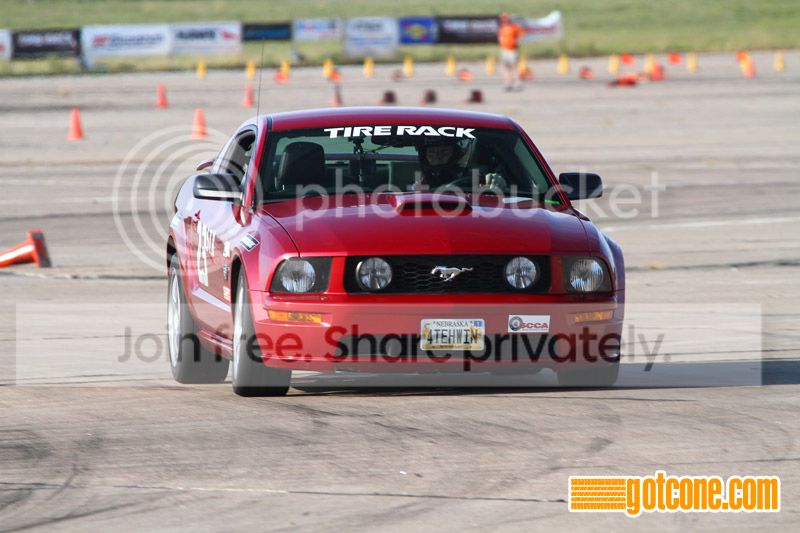

David of GotCone.com got his photos up for Day 1 of Nationals already:
Lots of good visual data in those photos and boy does he make the car look sweet! :)
