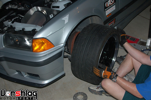

Plan on 285mm tires being the hard set limit for all 2WD cars in STU for the foreseeable future. It might be another 2 years before these hand-wringers make any adjustments to the newly reclassed S197.

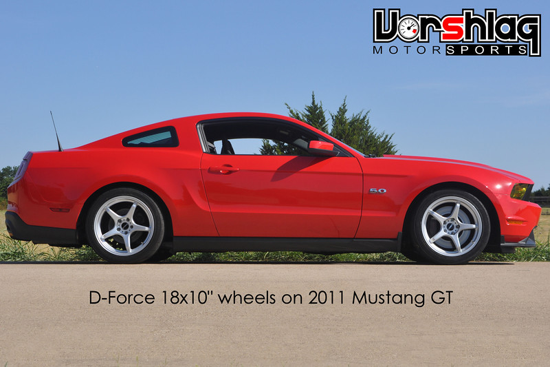

I'd use an 18x10" wheel and 285/35/18 Hankook RS-3 and never look back. The picture above is my 2011 on 18x10's with 285/30/18 Yokohama AD08s. That 285/30 tire is pretty short, however, but there are many more brand options in this size. Just pick the appropriate gearing for your year S197 (the tallest - like 3.31) if you go with the shorter tire. The 285/35/18 is a taller tire and fits the S197 a bit better, both for ground clearance/ride height and final gearing.

Otherwise I guess to the D-Force wheel it is (or a Forgestar made to the same specs?). I'm assuming the same holds true for the 18x10.5's that holds true for the 11's in terms of not being really able to run a square setup with a spacer. Poke is fine so long as poke doesn't translate to rub.

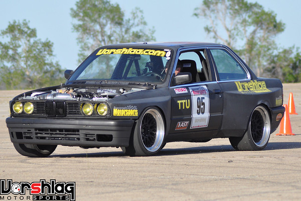

Yea, you are right: for STU the Mustang is currently limited to a 285mm tire. An 18x11" wheel isn't needed for a 285mm tire (STU)... but it doesn't hurt. I tend to run more wheel width than normal, especially when I have a tire width maximum. An 18x10" wheel is LOADS easier to fit to a Mustang, of course, but for the ultimate S197 STU build... I wouldn't skimp on wheel width. For the casual racers, don't go to these extremes and just use an 18x10" and be happy. :)
But I've tested this "run more wheel" trick on numerous autox cars over the years, with decent results. Scientific? Not really - more "we tried it and won", trial-and-error sort of testing. Take the car above (Our $2011 GRM Challenge winning E30 LSx), which had 18x11" wheels at all four corners, yet we ran it with 285/30/18 tires. It turned in like mad and worked REALLY well on track and in autocross situations (we ran it at the Challenge on $200 worth of circle track, steel 15x10" wheels and 275/35/15 Hoosiers, instead of the costlier CCW 18x11" wheels). This is an old autocrosser trick - more wheel width than tire width. Every time I've done this with an autox car (wider wheels "than it needs" for a given tire size) it handled better and just worked.
So for STU, there is a hard set tire width maximum (245mm for AWD, 285mm for 2WD) but no wheel width maximum. Only class in ST that has this open ended wheel width rule, so we always try to PUSH that loophole when we build STU cars. We pushed this on two our STU builds shown here; a 265/35/18 tire on an 18x10" wheel on our STU E36 M3 (below) and a 245/40/18 tire on an 18x10" wheel on our STU EVOX MR (above).
This is hardly scientific proof, but more wheel width did not seem to hurt when it is allowed and it fits. Again... my wacky theory that not everyone will agree with. I am fine with that.
