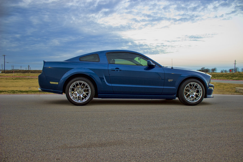

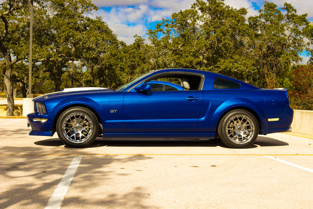

When I had my 06 I cut the factory rear springs about 1 coil until I got all my suspension parts. There was no real difference in ride quality.
Looking back - holy shit that gap was bad.
Before
After

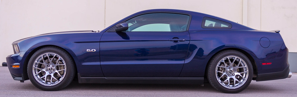

For what it's worth, here's the Eibach Sportlines on my 11 with the same wheels/tires so you can get an accurate comparison. The Sportlines drop the rear about 2''

Really don't want to cut the stockers. Looks good though. Researching different sites it looks like rear Boss 302 (non-LS) springs might do the trick. No pics though.
