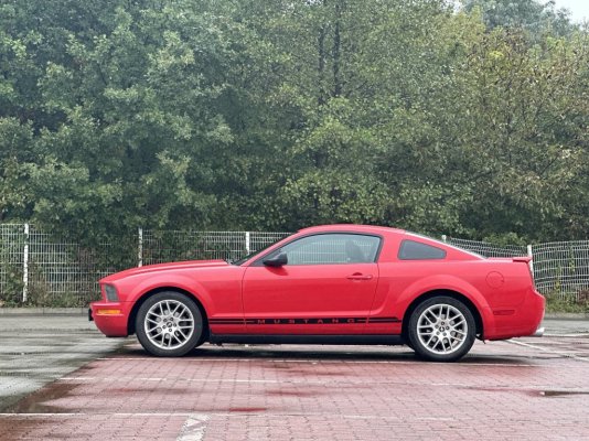

Thanks for the reply. What do you think about pairing stock GT shocks and struts with Roush coil springs? I'm noticing a lot of body roll on the stock suspension (could be due to wear). Someone mentioned they didn't feel much difference after installing the same setup, but it was from an '05 GT(not from 2013), so that could explain it. That's why I'm considering adding the Ford Performance sway bar kit. I attached the photo with my car. Front seems a bit lowered because of ages
I think that would be fine. I would think the GT shocks are 'in between' the Roush and V6 shocks.
