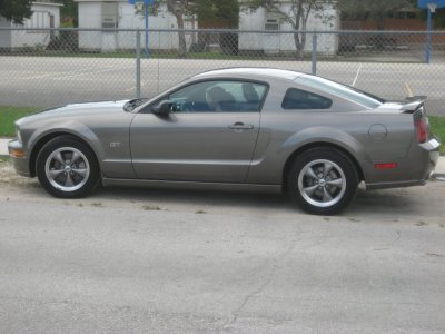

That's what I have on my 05' GT and LOVE them! Mine dropped a little more than .5 but that's to be expected.

Yeah, the "P" springs are stiff, but matched with the rest of my suspension it handles likes it's on rails. Also, no irregular tire wear and doesn't ride like a slinky going down the road. For me a perfect balance of comfort and rigidity.
Interestingly, my car is not as low as yours...

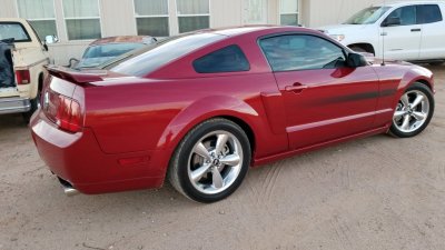

For me that looks like the perfect stance. Reality for me. It'd not. Watched all sorts of videos last night with before/afters. Think I sm gonna have to go Rouch. Until I can afford bags. Probably should have posted a pic if my car earlier.20230501_174116.jpg
