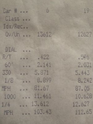

Ok outside of a new converter I could raise tire pressure and what else? I already have 4.10's.
Shed weight and a lot of it... if you do the converter, you'll be kicking yourself for not having done it sooner after the first launch

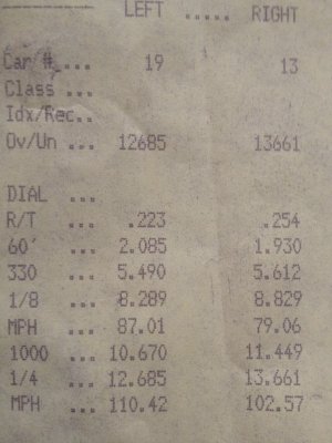

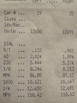

Ok what about tightening the suspension. What exactly do you mean? Springs and or shocks? I have been reading about springs but dont really want to lower my car. I think my car squats too much when I launch. I think I am losing 60ft time because of the squat. Would some sort of spring rubber to stop the squat be a good thing?
All stock suspension except for LCA and an adjustable UCA.

its really hard to see in that video to say what you need. adjustable shocks on all 4 corners would help then you could tighten the front up so it doesnt sit back on the rear as much and tighten the rear up so it doesnt drop as quick.
