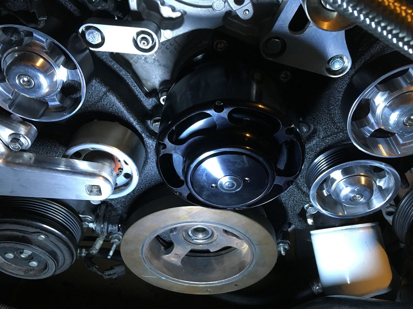

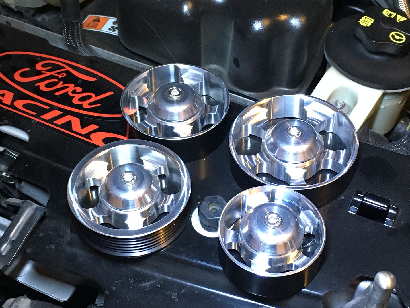

I always carry a spare belt in the trunk, I've had to replace too many over the decades to not have one always with me. Blowers put an enormous amount of stress on the belt and pulleys and it is not uncommon to have failures of this nature. Do you run the stock tensioner? Was it the actual tensioner pulley or one of the idler pulleys that seized up? I should have been some squealing before it failed as the bearing went out. I run a Thumpracing tensioner and have replaced all my idler pulleys with a set from Metco. They even swapped one of their pulleys in the kit for a larger one to match up with the Whipple one.

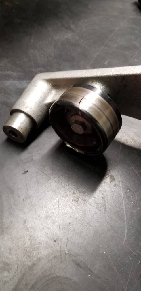

I pulled it out. the thing is completely warped. what could cause this??

I regularly (100K miles) change the bearings in the tensioner pulleys. Changing the bearings is pretty easy and I don't buy the pulley/bearing combo at the Autoparts stores. I usually get a non-Chinese pulley - SKF or similar. I had a squeal once from under the hood and thought it was the power steering pump - turned out to be the pulley bearing. Listen for weird noises!
