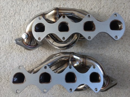

What I noticed that the headers have round shape inlets at the flange despite the cylinder head has some kind of oval shape. Doesn't this mismatch costs performance?
EDIT: https://www.holley.com/products/exhaust/headers_and_exhaust_manifolds/shorty/parts/70303304-RHKR
The round tube header meeting the “D” shaped port is an anti-reversion trick from many decades ago. It is useful in reducing carburetor standoff. It does not hurt the exhaust flow to any great extent.
