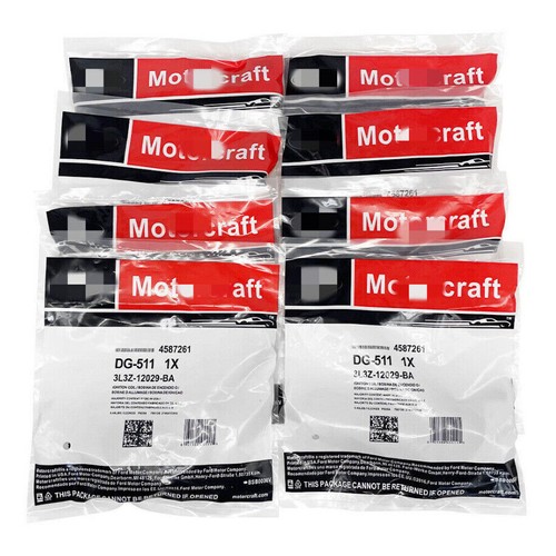

FYI - Motorcraft OEM coils at bargain basement prices:
:snoopy
Yes, but do those have a sticker with a checker board flag and flames and a lifetime warranty like these lol
These are even cheaper than my Bravex...wow, I got ripped off lol
The Bravex COPs do come with a 5 year warranty. I dont know how hard it is to get warranty out of Bravex though. The Bravex look really good. The factory OEM COPs might be a little better built. I saved my stockers anyways, just in case.That is a good price for the ebay Motorcraft ones.
:snoopy
Be cautious of the eBay sellers. DG511s are a VERY common counterfeit item on eBay. If it’s too good to be true, it ain’t (unless you personally know the seller).
Note: I'm very particular about what I put in my car... All I can say is I've been using them for years now (on a blower setup) with no issues to speak of. They have the right packaging with the right markings bought from a US seller. If they are counterfeit then they're certainly very good ones so until something changes to the contrary I'll keep using them.

Oh I feel the same way. I always had in the back of my mind I would buy some MSD coils. I didnt really need coils, but when I saw the Bravex there were to cheap not to try. Only time will tell, but they really do look/work good. Its like plugs, everybody has their preference. There are failure rates with anything. I have seen bad reviews for the E370 plugs, but I got awesome service out of the ones I had, so much so that I probably could have kept running them for a while...and they are one piece.
