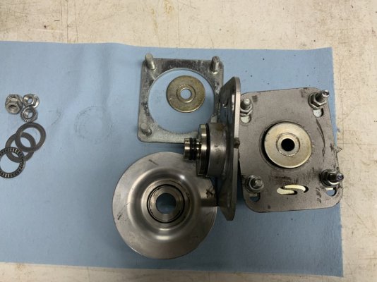

Midlife Crises
Jul 20, 2019
2,365
1,900
Fairbanks, Alaska
I don’t know how many different camber plates Steeda has offered over the years. This is the set I used for a few years. I had no problems with them until one began to bang going over bumps.
Midlife Crises
Jul 20, 2019
2,365
1,900
Fairbanks, Alaska
If you look at the nipple on the center section you can see two “O” Rings. These had failed and allowed the spring perch to wobble around on the nipple. I replaced the “O” Rings with some from a hydraulic supply house but they were not adequate and failed rapidly.
