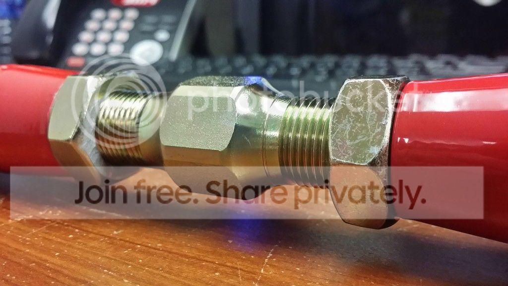

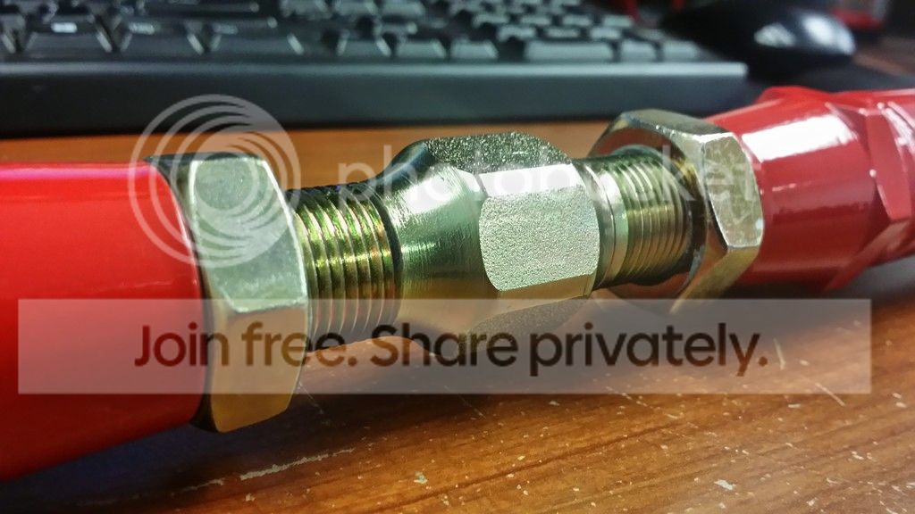

A few differences you may discover when comparing that bar you linked/pics...would be, we pride ourselves in our products designs...and also, form + function. If you take a close up look at our components, we try to add the highest level of function and great looks, every step of the way.
For example, our center adjuster. We don't just make it work, but we make it look superior. Instead of straight cuts on our pieces, we like to roll edges for looks and ease of use.

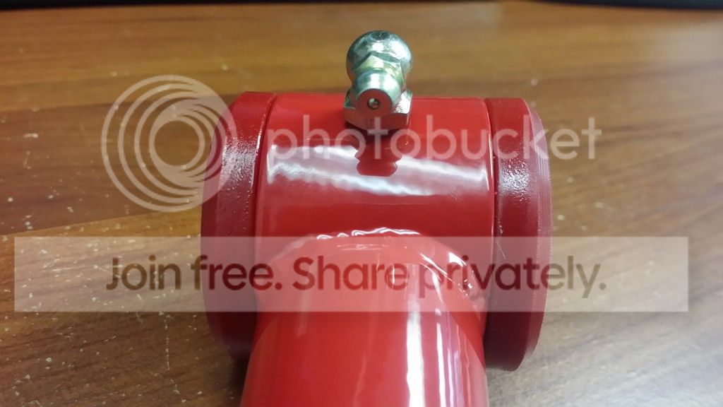

Then you have the "small things that count" - like, we zinc coat everything. You will not get a single part from us that isn't coated. Many of the lesser cost items on the market will feature a bunch of parts that do not have any coating, and do not stand to various weather conditions well. Also, we provide a 90 degree grease fitting (also zinc coated) on the driver side bushing end, so the user does not have to unbolt the bar to lubricate the bushings. Not sure of the bar above, but you would be surprised how many brands do not do this.

Bmr tech, thanks for the info. Yes $75 is super cheap. It doesn't have a 90 zerk but I plan to pick one up and swap it out.
