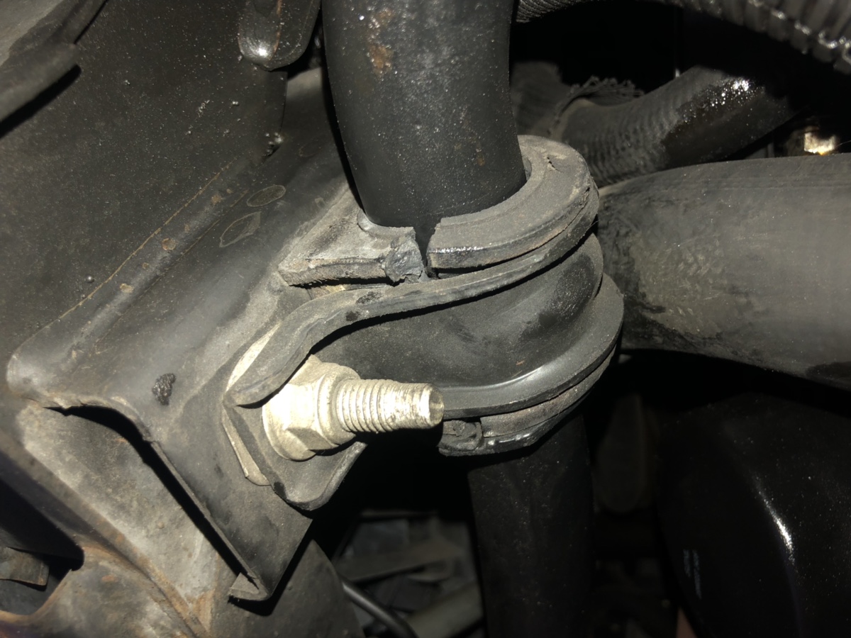

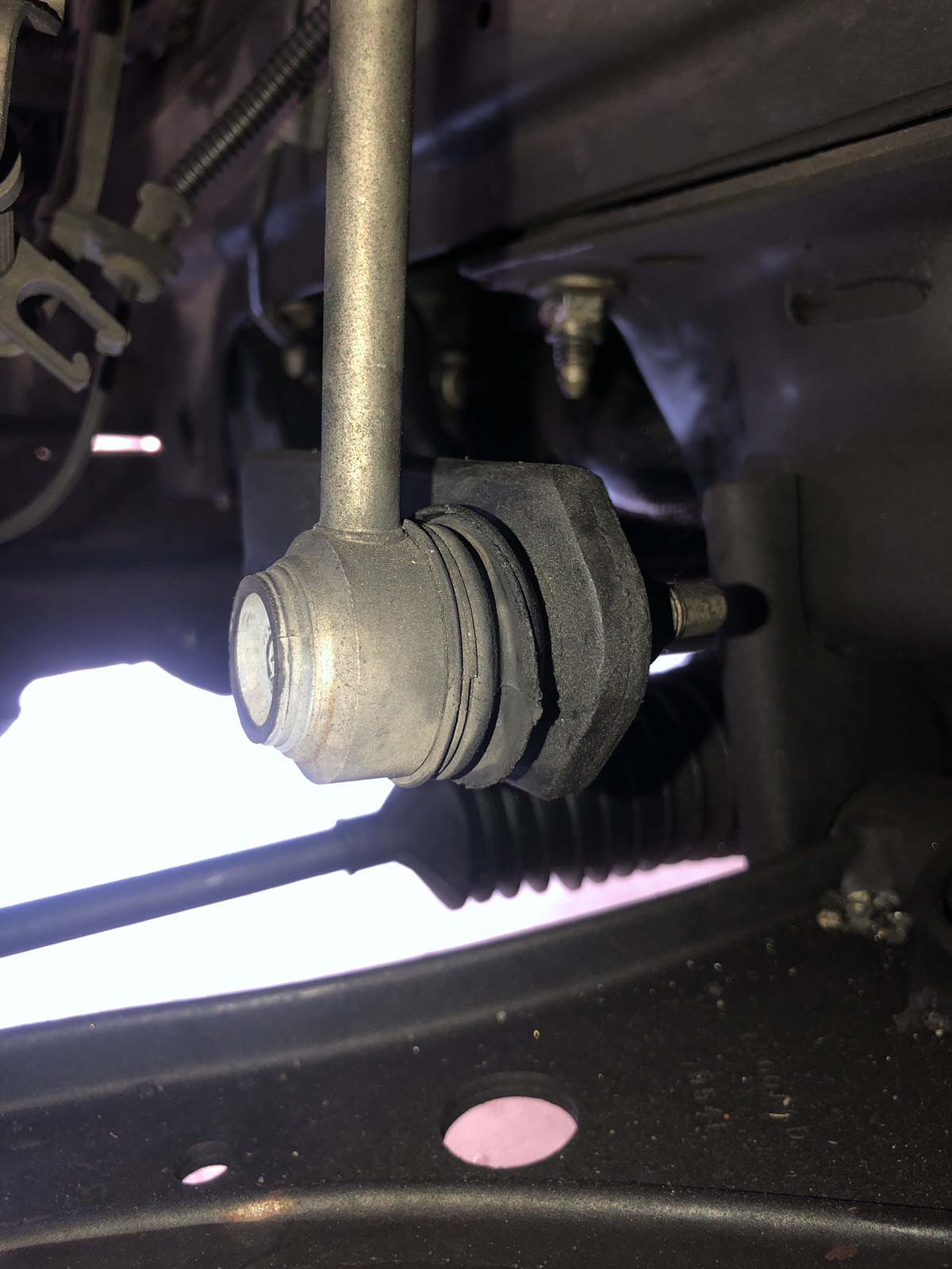

I have started too experience this issue since like a week ago and its been bothering me and today i finally had time to lift my car and check it and ive seem to find a couple beat up bushings, can this be whats causing this clunking over every lil bump?

Bingo. You've found the answer to your own question.

As for the sway bar bushings I recommend to replace all of them, both front & rear, due to what you've shown now. You can get the Ford OEM sway bar bushing upgrade kit thru AutoZone (red polyurethane) for a very reasonable price (got both front & rear full set of sway bar bushings for $44.95 + tax). I had to do the same as you're gonna do right after I bought my '09 Stang (replace the front sway bar end links due to clunking when going over bumps) so since you're gonna need to replace the front sway bar bushings anyway the opportunity is before you to also upgrade them to a stiffer durometer bushing to improve your OEM sway bar's effectiveness to control body roll.
