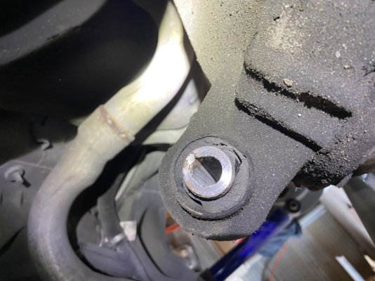

I just replaced the rear upper control arm. The axle side bushing was trash. Even tiny bumps it would be banging around. When I drilled out the rubber it was so dry rotted it turned to powder.

I replaced that w/a prothane kit. No issues since.
Did you guys just change the bushing or did you change the upper arm as well?
This is the last piece of suspension that I need to change on my 07. Been chasing bumping and banging ever since I got the car, it’s better now, but still kind of there.

I changed out both. The diff has a rubber bushing on the top of it that should be changed out if it's trashed (replace the rubber only; keep the shell). Otherwise, you can get away with just changing out the UCA if you want (I went w/J&M due to how it articulates freely - cost, around $100 - $130). There are lots of manufacturers out there to choose from.

I did both, but also already had the adjustable uca and new bracket. The bushing in the stock 150k mile uca were actually still good. I just used a rubber replacement so I removed the entire bushing and metal housing and replaced it.
