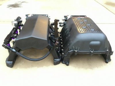

I resolved my issue with the FRPP intake being a flow restriction: Thanks Jeremy!
The runners on this thing are HUGE! And it's super tall! All aluminum, TIG welded, a very solid quality product, and it only weighs about 4 lbs more than the plastic FRPP intake. As good as this one is, I'm going to make it even better by doing some port matching at the bottom of the runners and cnc plate where it meets the heads. In any case this thing should out flow the shit out of the FRPP.

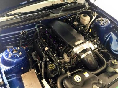

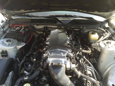

Looks good Kyle! Hell yeah tunnel ram lol, it does look super tall with no alternator and no valve covers. Its a little deceiving though, it is as tall as we could get away with but the throttle plate is very close to stock location and clears the hood fine. Works with some of the taller style strut tower braces as well.
