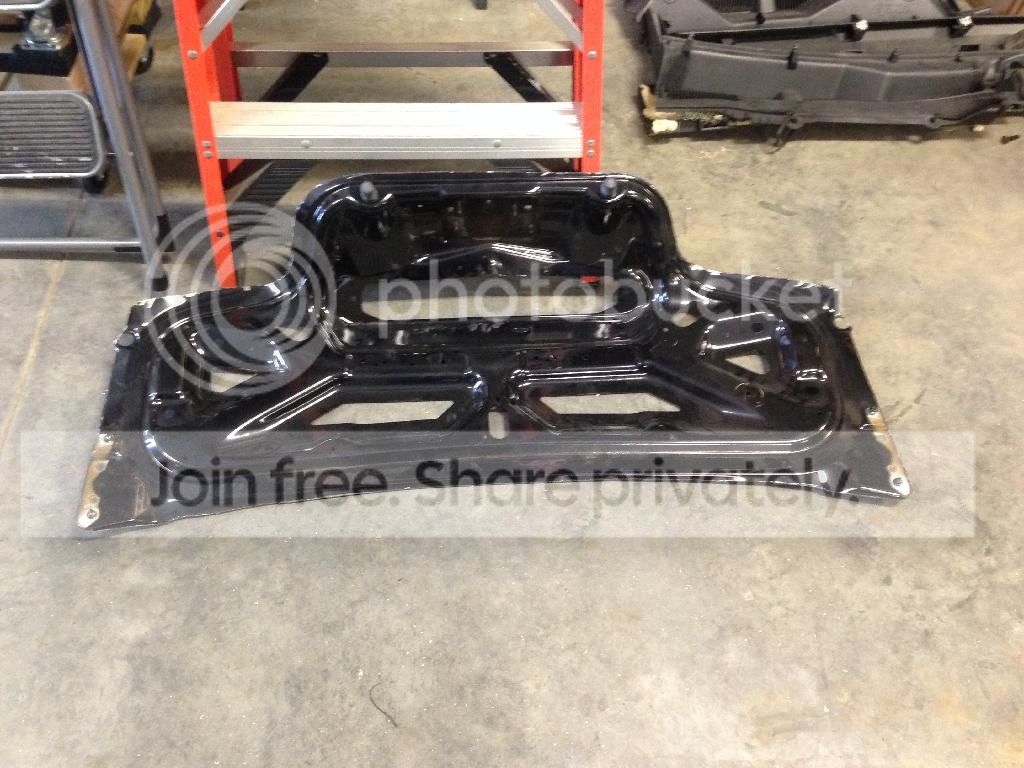

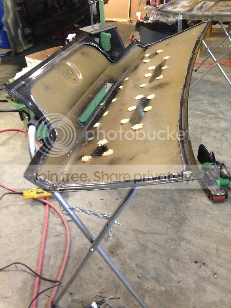

Factory trunk lid weight was 19 pounds. I removed 8.2 pounds of bracing and I will use dzus fasteners and rail to attach it now. I could save more weight by switching to carbon fiber, but I think for now I will keep all factory body panels on the car. Plus the extra weight in the back isn't necessarily a bad thing.

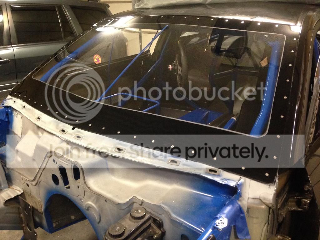

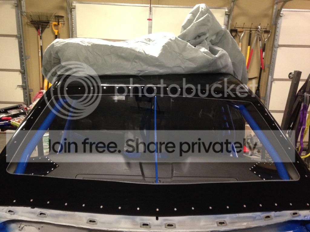

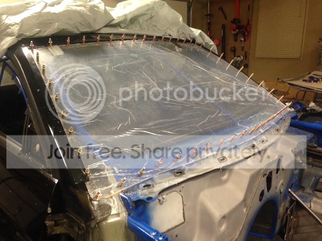

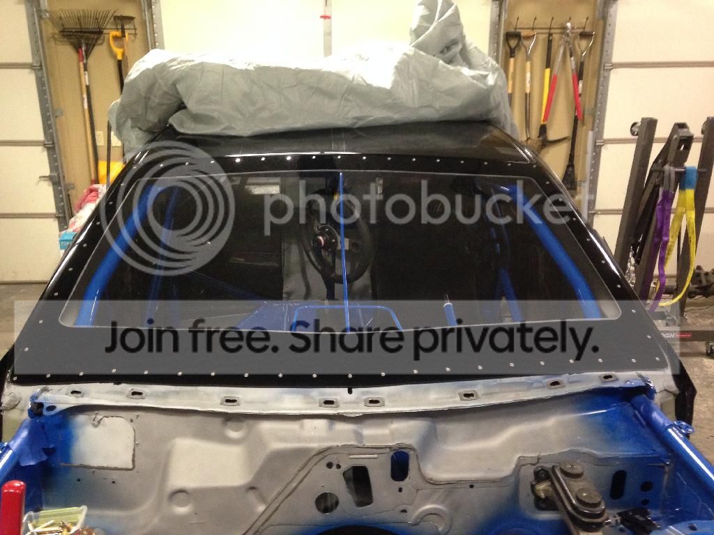

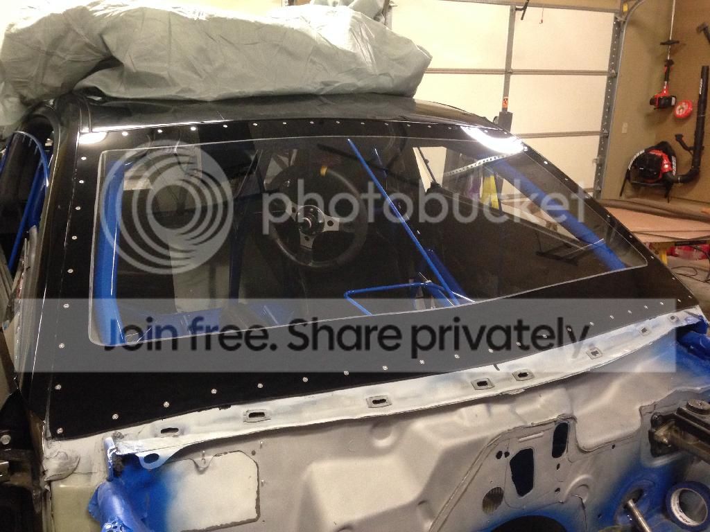

I'm now working on the Lexan front windshield. It weighs 8.8 pounds. According to the spreadsheet in the "How much does it weigh thread" the OEM windshield weighs 28 pounds. I'm using 1/8" thick since I have a center support.

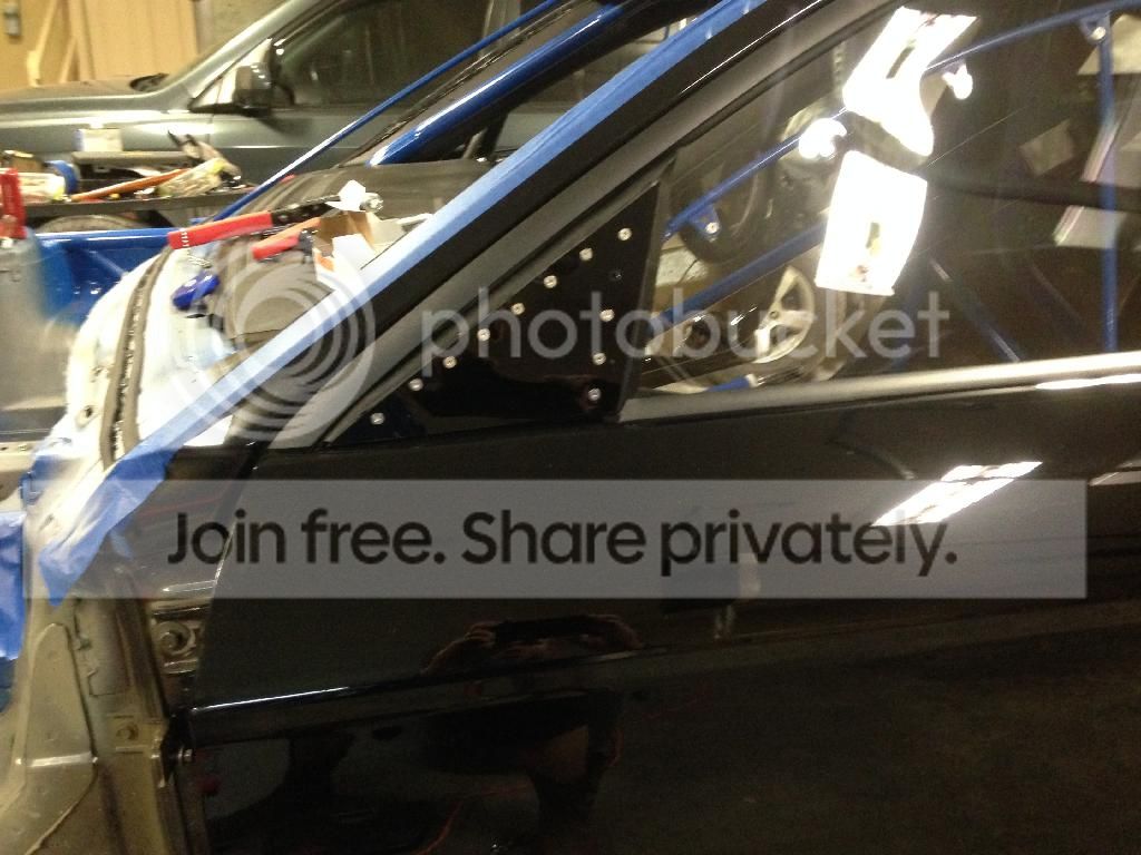

Mirror block-off plate
(Yes I do know there is a screw missing. I have ordered a longer screw for that spot)

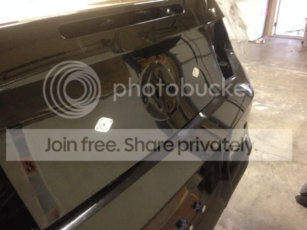

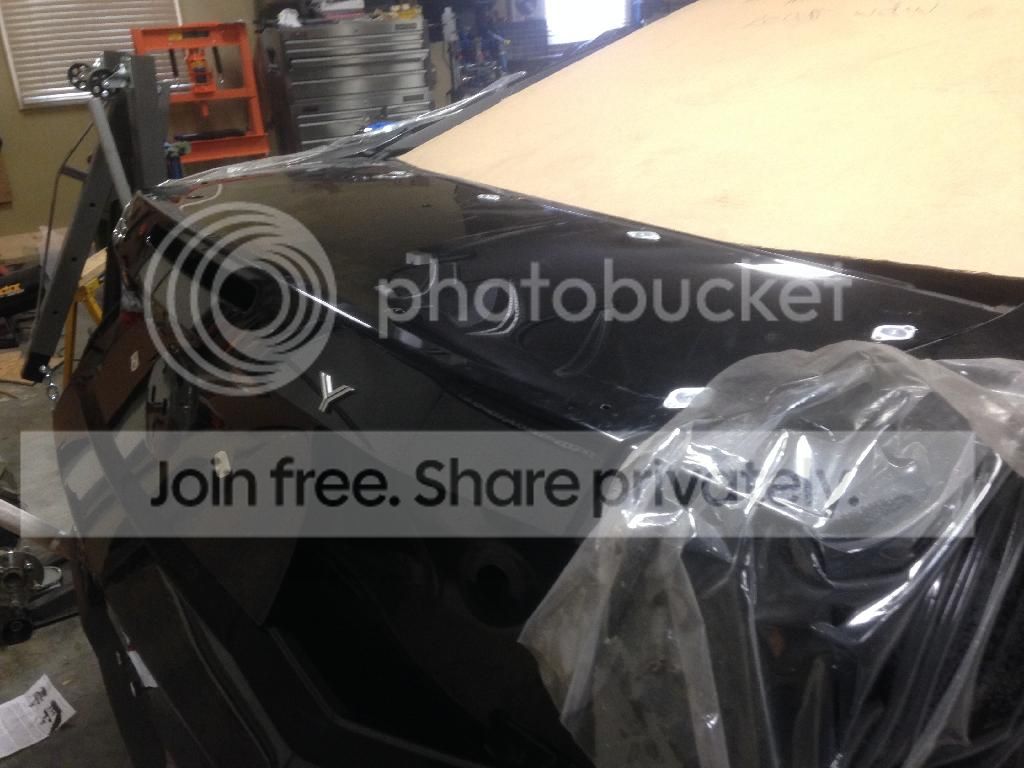

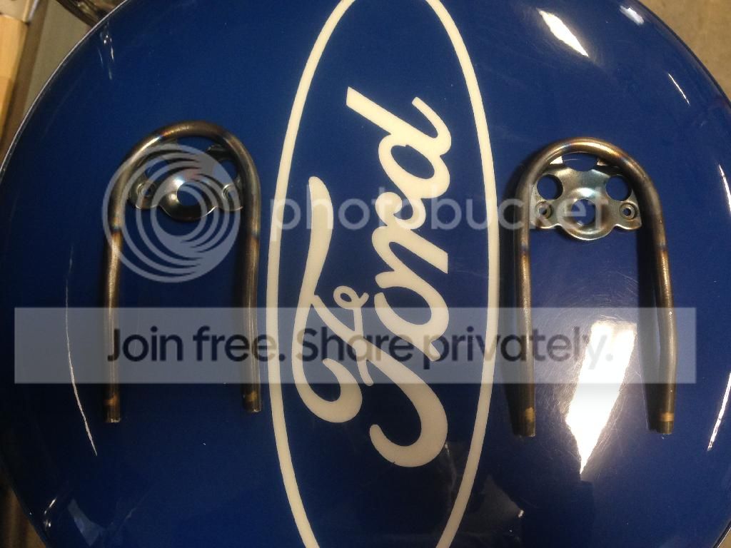

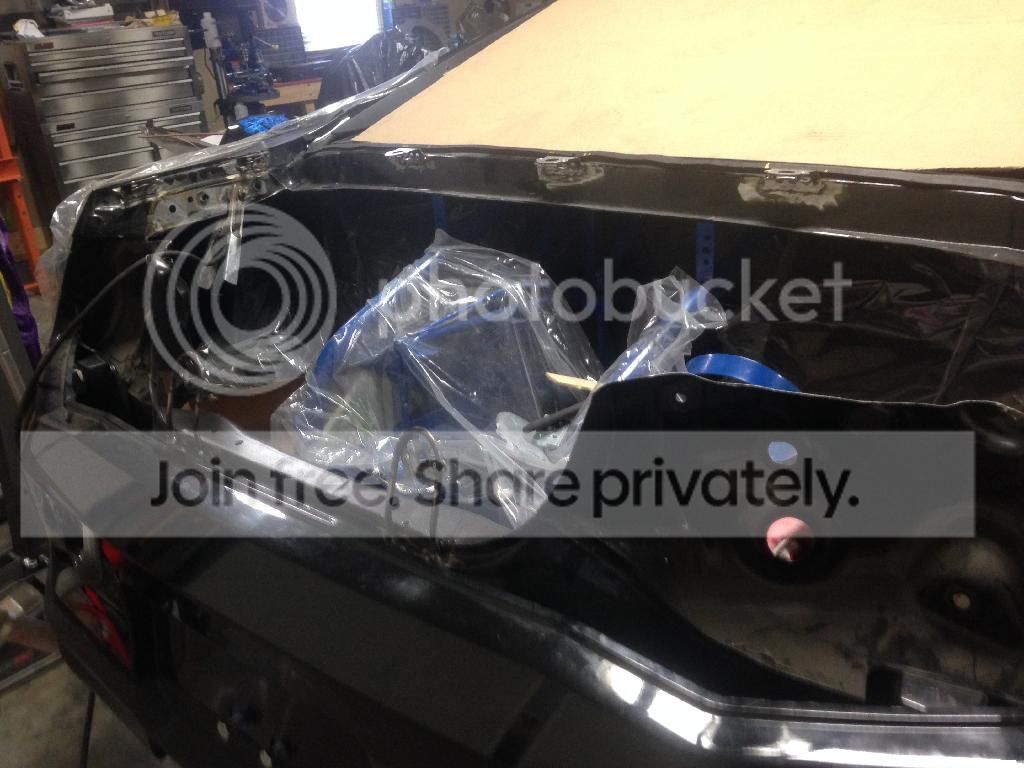

I've been working on mounting the deck lid with dzus fasteners. Very time consuming.
These are some brackets that I fabricated to mount the lower part of the deck lid to:
Here all the fastener plates and brackets are mounted
The mounted deck lid
The lower dzus fasteners
