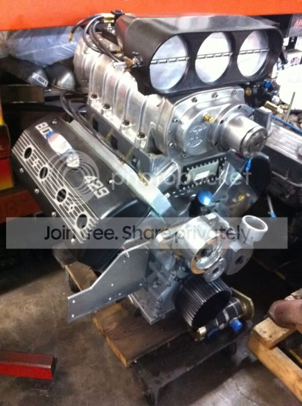

Might be putting this bad boy in the car ( minus the blower). It's a 604 ci BBF with aluminum block, AR hemi heads, aluminum rods, and all the goodies. At 11.7:1 with twin 88s and alcohol as fuel, it would make a ton of power.

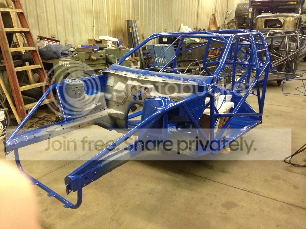

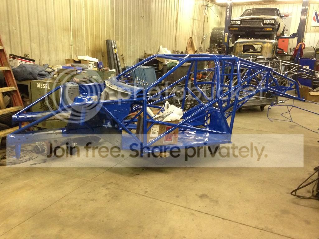

I wanted to do a color other than the usual wrinkle black or silver vein. I was a little unsure at first, but now I am very excited about it.

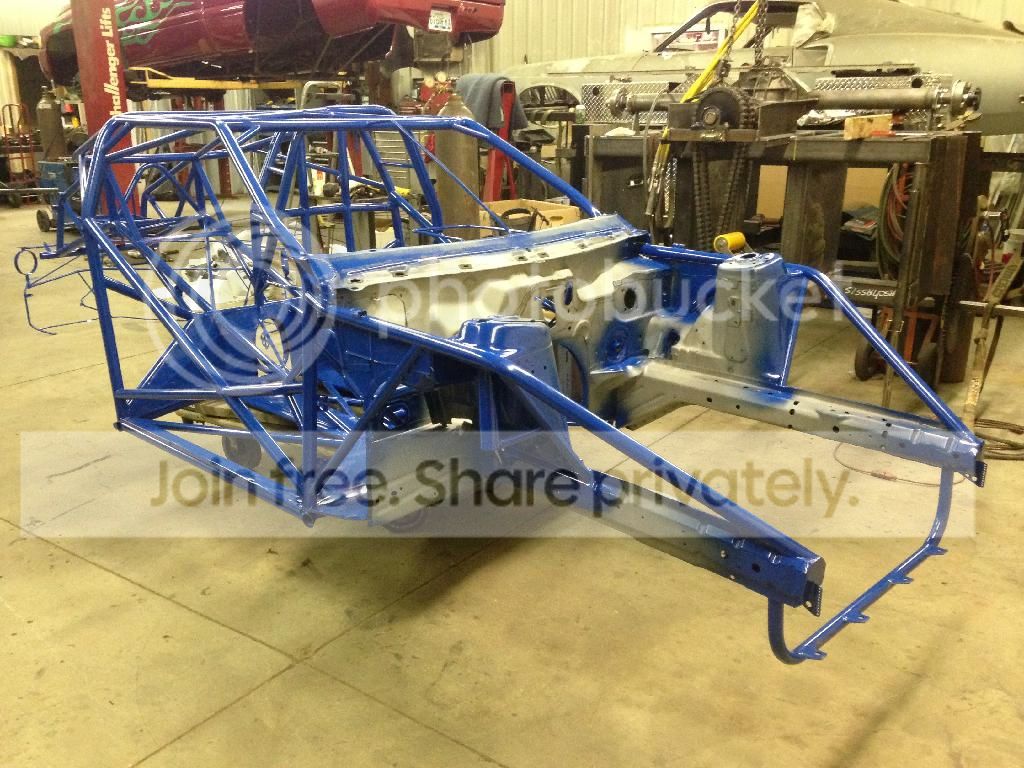

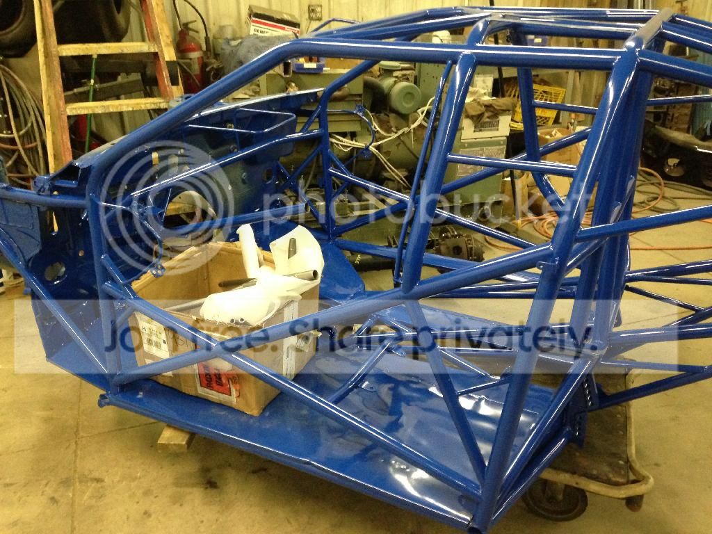

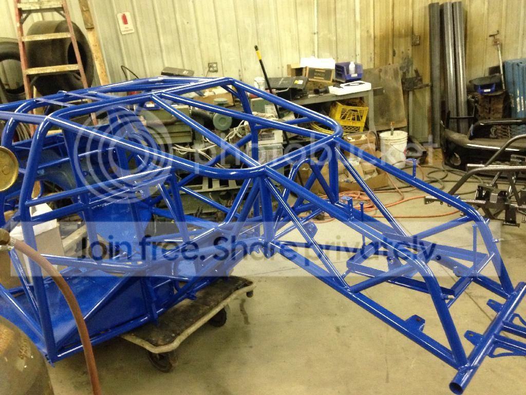

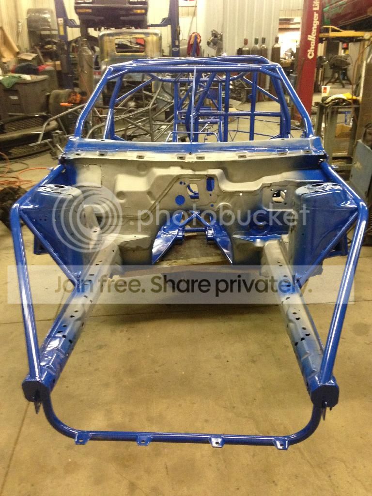

I have a few more pics when I get a chance to post them. You may notice that the front frame rails, shock towers, and firewall haven't been powder coated. That's because I need to go back and fill in holes and do some body work there. I will then paint those areas.

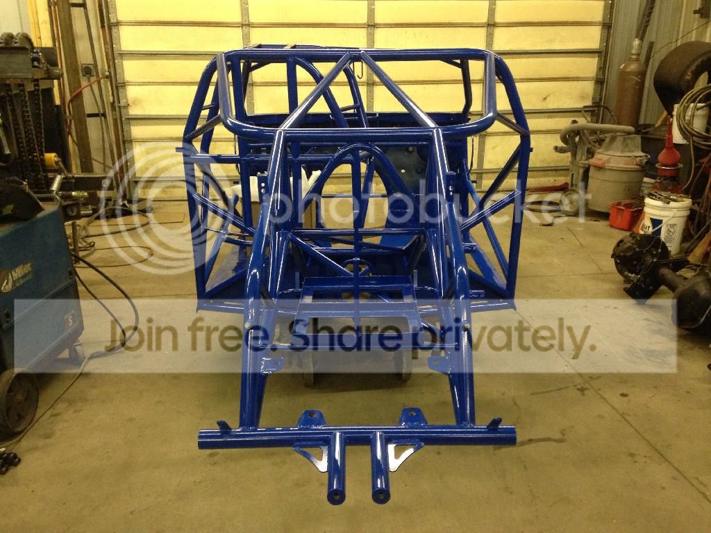

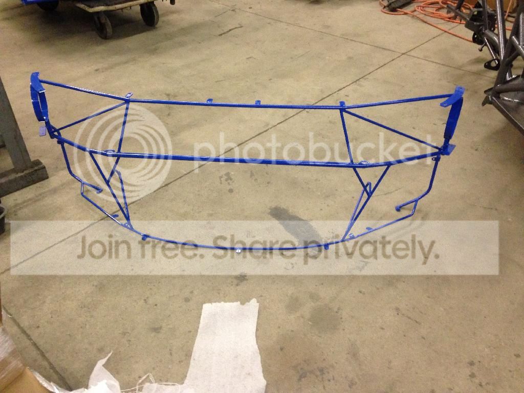

This is the structural tree that ties the front clip together and supports it. It looks like a work of art. It's a shame that it will be mostly hidden.

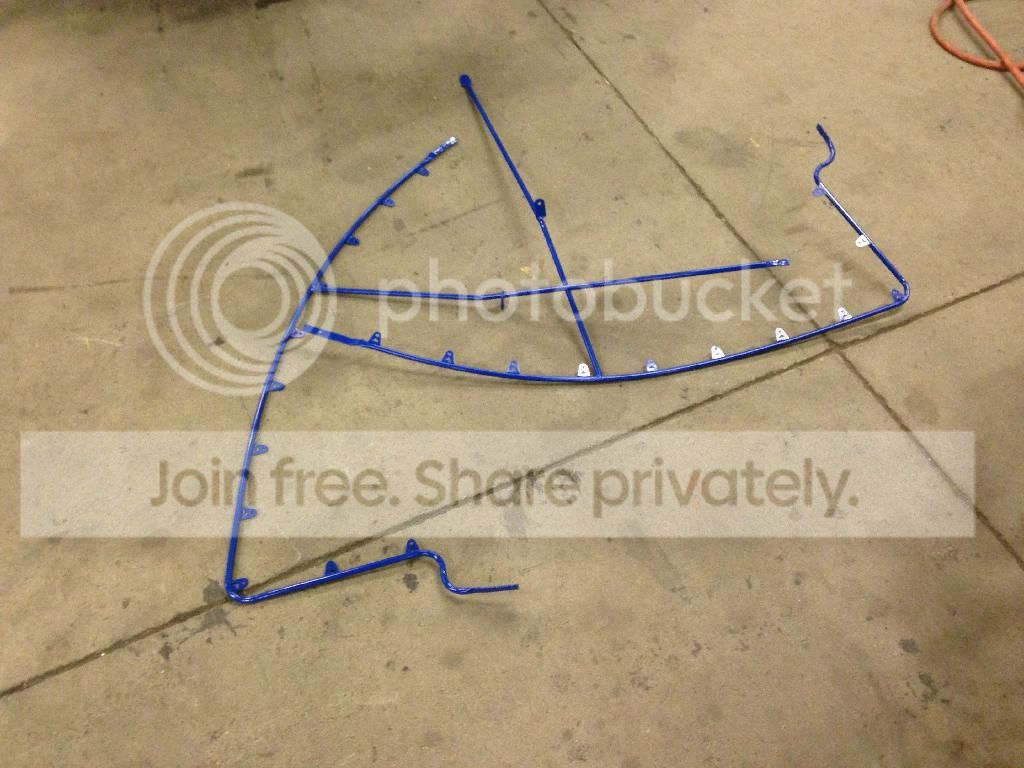

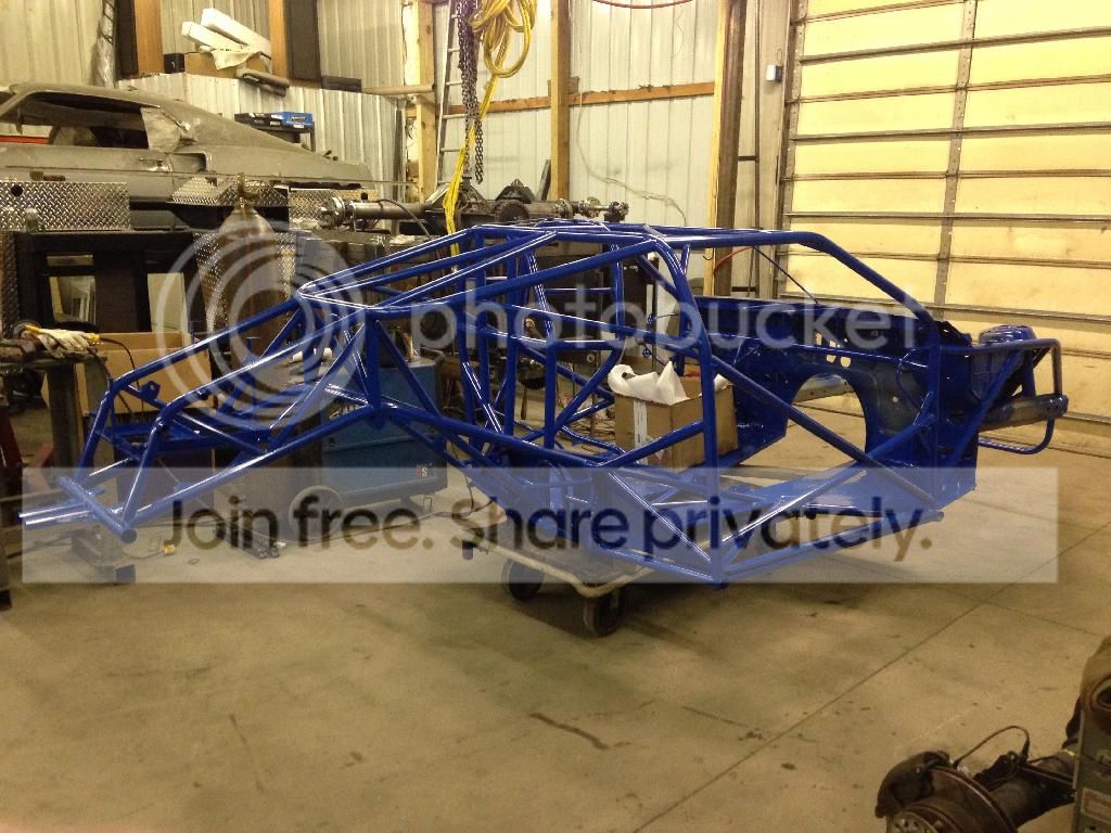

These are the frames that will support the Lexan side windows.

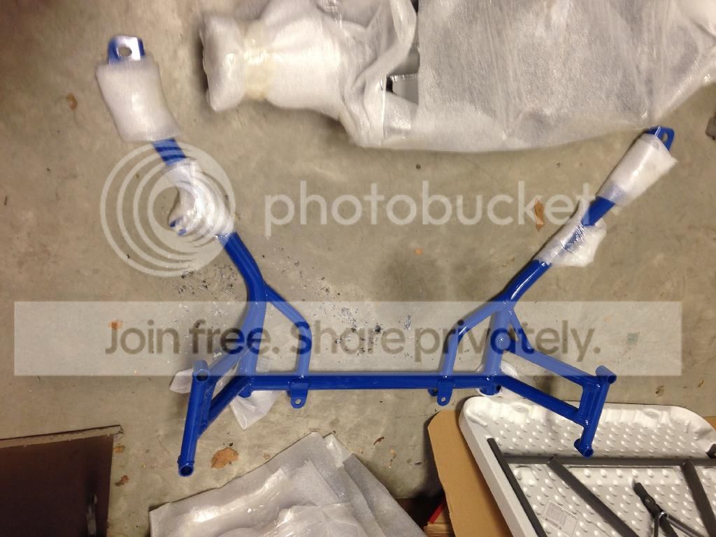

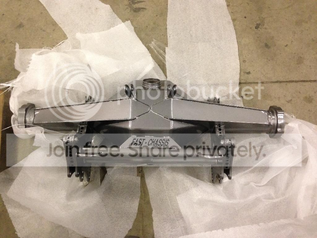

The k-member. It started its life as a BMR piece.
