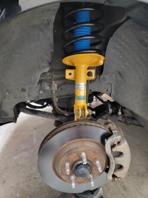

I have continued to go through the old girl with a fine tooth comb. And it was time to replace the suspension at around 83,000 mi.
Since the car is a semi daily but is never tracked, beaten, burnouts etc, I really wanted something that was comfortable but had a little bit better handling and good quality parts.
I put on Steeda jacking rails which I can't recommend enough for anyone working on their car. Makes such a nice difference being able to move the Jack and Jack stands and a lift in the future.

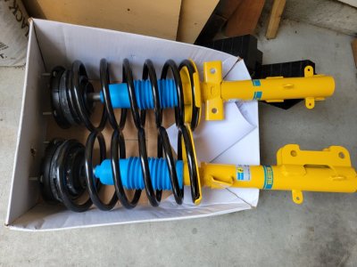

Up front I installed GT500 upper strut mounts, Moog replacement springs + Bilstein dampers and GT500 control arms. I went with the Moog springs because I am renting as I am watching for the right house, and really needed an assembly I could put on without having the car down and didn't want to deal with a spring compressor. A great local shop I use for state inspections compressed and assembled those for me for a great price so no complaints.
I added the Ford performance front control arm brace.
Out back I installed the GT500 lower control arms, with the Bilstein dampers.
Very happy with the ride, the front is still settling with the new factory replacement springs, but it is starting to come down more to where it was.

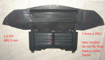

And, if your 07 has no engine undertray, get some 3 mm ABS, fill the gaps in front of the tires and find the engine undertray of the 11 for the gap between the radiator support and the axle K-member. And the k-support bracket.

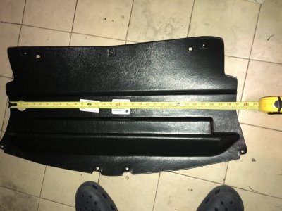

I put this on my 05' GT...
Ford front engine lower splash shield 5R3Z-17626-BA
JC SSP
Nov 8, 2022
2,283
1,348
FL
Yes mine is just the center section. Cost me $40 new from Ford.
This complete set up is much nicer but I don’t need all that underbelly coverage. Car is a 100% street.
