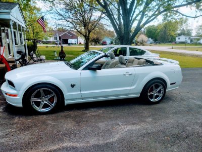

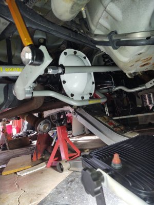

I put mostly Whiteline adjustable suspension products in my 09 vert, not racing just wanted the car to go straight and corner flat on the back roads. I had BMR rear control arms but they squeak even with the expensive grease but what can you expect for $100. Stay away from the cheep crap. I installed Ford Performance A-Frames & ball joints since I had a clunk in the front and Ford ball joints aren't the best, stock coupe front struts and springs and stock coupe rear springs also a strut tower support.. The coupe springs lowered the vert around 1.5" -2" and still have a good ride. Figured I would throw that in for any Vert readers.
If you are doing up-grades in steps buy in the winter, prices are lower and a lot of sales before Christmas. Bought all mine in the winter of 19 as the prices went down but it kind of got away from me spending to much time on the computer during the cold weather.
