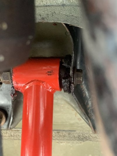

okay but quick question the upper control arm bushing seem to rip apart after a couple days drive could that have been that u did something wrong?
MasterofDisaster
Jun 10, 2019
2,480
4,178
Michigan
That upper control arm bushing looks nasty. Polyurethane is not compatible with all greases. Looks like you need a new bushing up there.
The one you're showing is where the arm bolts to the body/bracket, right? There's a sleeve at the differential, but I don't remember a sleeve up at the body/bracket.

Hello I’m back so wobble is still here and my new control is already ripping the bushing I’m at a lost right now
Samos3
Feb 27, 2022
736
484
St. Louis
Pics needed.
Also, how is your panhardbar and its bushings. Looking for side to side movement of the whole axle, maybe the bar is loose/bent? If its an adjustable one, is it adjusted correctly?
