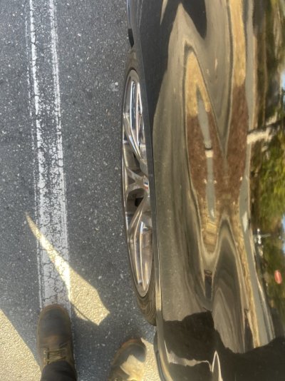

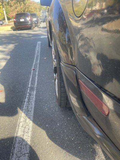

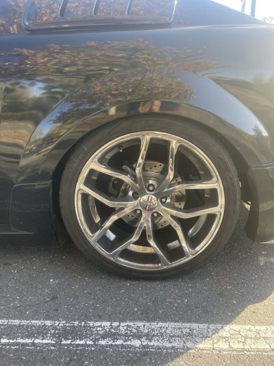

Hello I’m back life happened haven’t had time for anything but here a picture of my driver side rear wheel

Just looking at the finder gap on the rear of your car it looks like you are lowered 1 1/2 to 2 inches. That much drop requires relocation brackets to correct the angle of the lower control arms and an adjustable panhard bar to center the rear axle in the chassis. An adjustable upper control arm will let you correct the pinion angle.
By the way, I see you are missing a lug nut. What else is loose?

Take this car to a shop immediately. A car lowered that much needs an adjustable upper arm, and relocations brackets for the lowers. Based on the clearance arm you bought, it seems you are trying to do this as cheaply as possible. But it isnt any cheaper to do it over and over again rather than the right way the first time

And, you get a wobble feel in the rear if you have frequent contact with the bump stop. That combined with the LCA angle going up instead of down makes a car unstable.

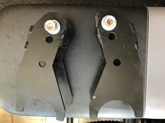

Why would you throw out the relocation brackets?

I have a set of new brackets... Unfortunately sold the upper and panhard long time ago.
