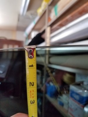

How far from the top edge of the window is your tint, we usually run ours up to the very edge of the glass and have had the door seal push on the tint if it's too fresh.
Iceman62
Bullitt 6005
Feb 5, 2017
1,299
386
NE
I'll check this weekend...right now she's covered-up/hibernating for winter, but weather's getting into 50's (rare warming) and I have to get some information off the registration for taxes. I believe it's all the waty to edge, but could be wrong...more to follow.

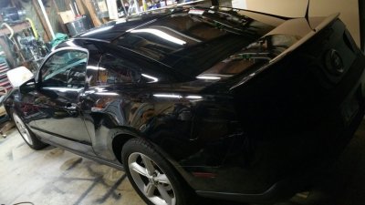

Got the back window and quarters tinted.....back window took FOREVER to shrink. Dont know if it was the film I ordered or my heatgun not getting hot enough. Or maybe im just rusty, couldnt find my squeegee and noone sold one so had to make due cleaning with hardcards.
Was being all carefull getting in backseat with wet tint in hand and trip on seat baserail and rubbed tint all over inside headliner lol. It didnt turn out bad though...can laugh now but was pissed. Lol
Hopefully can get door windows done sometime this week or weekend.

I stand corrected...mine's exactly like EBABlacknChrome (above)...1/16" down from edges.

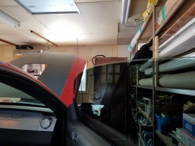

ive tinted probably over 100 vehicles in my life. Its really convenient now with the precuts but back windows especially HAVE to be preshrunk on the outside or youll have bubbles and "fingers" all over the edges. Theres just too much compound curvature for a flat film to fit on the curved glass. I have a few embedded hairs stuck behind my back window tint that I can see now that its cured- from tripping with the tint when climbing in backseat, its only noticeable up close but im a bit of a perfectionist and it bugs the crap out of me. Thinking about louvers now lol.
On the door windows I just popped some bolts in the door latches to trick the sensor that the doors were shut and left them partially cracked open for a couple days untill i was sure tint was cured, worked great.
