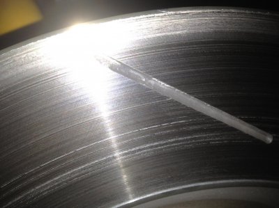

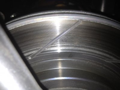

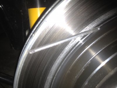

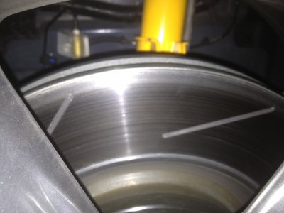

First, the Goodridge kit came with a flow bolt of the wrong size. Didn't find out till the very end so know i have 3 ss lines and 1 OEMI'll be calling them tomorrow. The rotor and pad install was easy. Bedded the pads to the rotors per their instructiones and i ended up getting streaks on all rotors. Sent them an e-mail to find out if this is normal. What do you think? Got a track day on Saturday.

check the anti rattle plate to make sure they are secured correctly, they may be touching the rotor.
