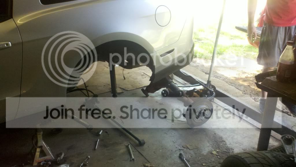

Okay i will get pics next time im off, i do want to explain this
The tube twisted inside the housing it sits in as in its just not lined up
Its not as if it twisted the metal
Like if i have a piece of steel in my hands and twist it with the left and let the rigjt hand pivot
Not if i grip with both ands and try to bend it lol

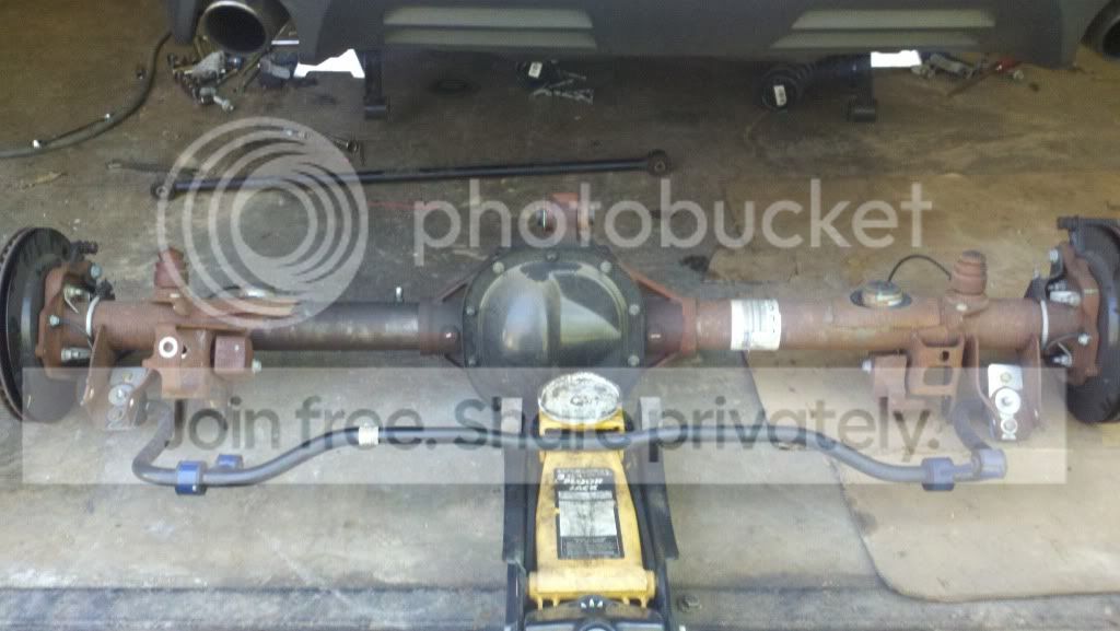

Yep. You can see the plugs in the housing. They drill out pretty easily and what you'll want to do. You can get a tube from currie since they make them new with brackets and all. But you might be able to save that one. Could be hard though. Or start from scratch
Stock tubes compared to the .250 chrome moly ones I have made.

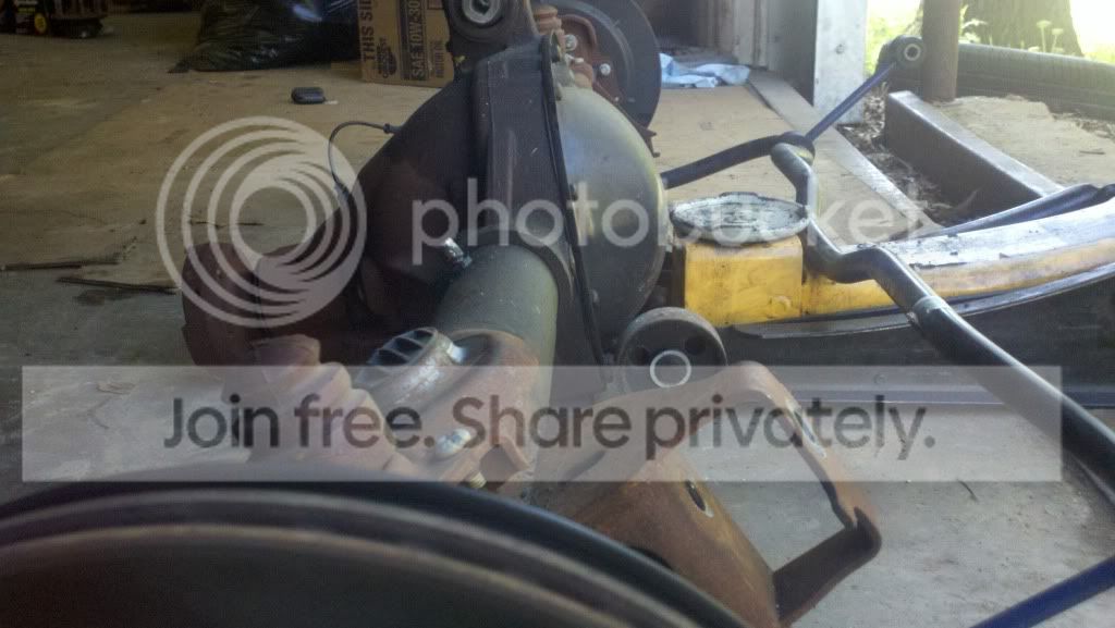

If tou look at the control arm mounts you can see how it was twisted
I have already fixed it, car runs great now
I welded both tubes
