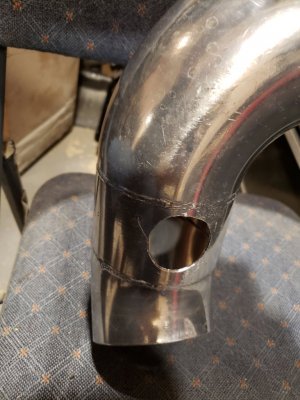

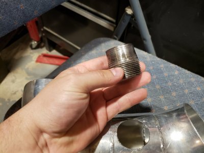

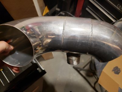

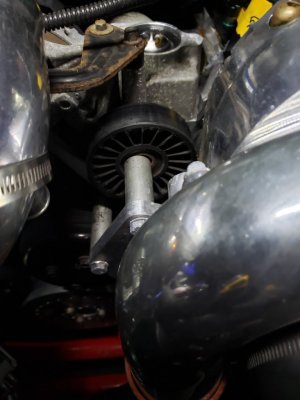

Just swapped my tial q base for a qr base to recirculate the air to the intake. I was getting tired of not being able to hear my exhaust over my bov. Going to pick up some 1.5 inch radiator hose and try to figure out a connection to my intake.
All set up to recirculate now. But I have an issue. Started it up and it's much quieter but also stalled out after running for 15-20 seconds and won't start again. Mind you it is 20 degrees outside. It is getting fuel. Maybe a vaccume leak at the bov??? If your looking at the picture I did add a hose clamp.Be interested to see the final outcome, thanks for sharing

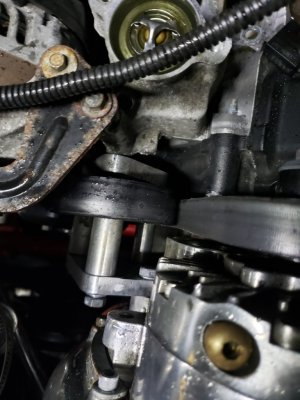

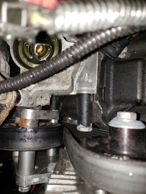

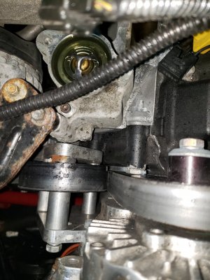

Went to change the thermostat housing to one I modified the angle on the clear the belt and what do I find when I remove the intake manifold. A broken bolt for the manifold in the head, the supercharger setup with pulleys in the wrong spot " which is why it's rubbing on the belt. " .But even better one idler pulley mounted completely crooked and siezed which is why the power steering pump has been whining. I am beginning to believe that the only person I should trust to work on my car is me. Now I have to look up the supercharger install instructions and go through them.
I would tear it all down and start over. Not everything but the belts and pullies and such. Start fresh with known good parts. That stuff should not be too expensive to replace.
As far as the bolt, you have a kit to remove it? I have removed a few from mine over the years. Pretty inexpensive tool set to pick up.

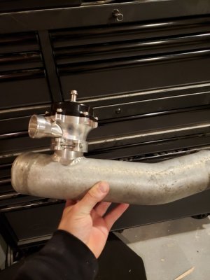

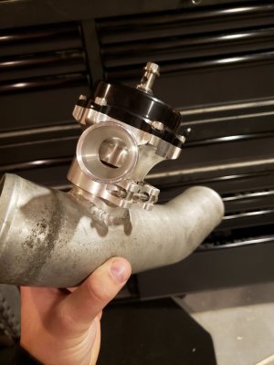

I am so glad the weather held up for at least 1 solid day. I swapped out the snapped off intake manifold bolt, reinstalled the pulleys, and converted the bov to recirculate back into the intake pre blower. Sounds so much better. Get your motor going!Glad to see everything is figured out! It might just motivate me to put my motor in and give it a whirl!
