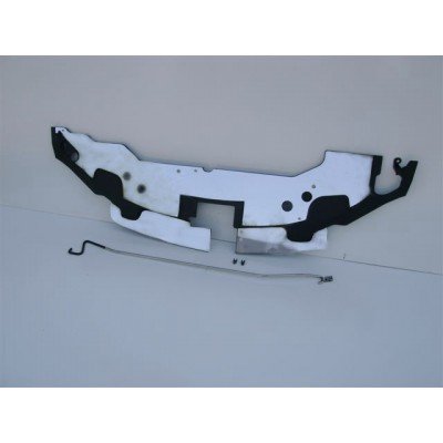

Check out these emblems to replace my fender GT logo and the stainless works radiator cover. Also does anyone have a good method for removing tape residue from my carbon fiber hood. The shop that had my car taped my hood vents shut and the residue is still there.
