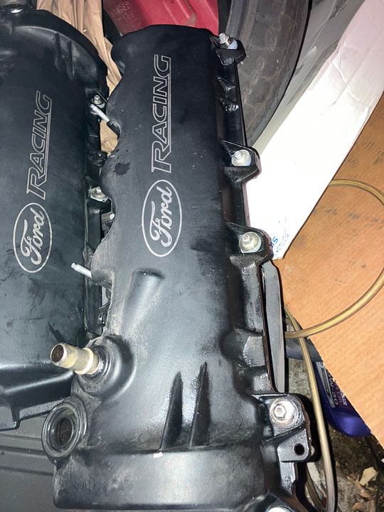

Well got the intake tube & TB, fan and hoses out the way this morning. Might have to remove a heater hose and fuel rail to get the passenger cover off. I can’t remember if I had this set up last time I pulled the covers off the engine.
Gotta work in the driveway so early morning hours are it for me with these 118* temps. Even now at 6:30 I’m sweating my balls off.

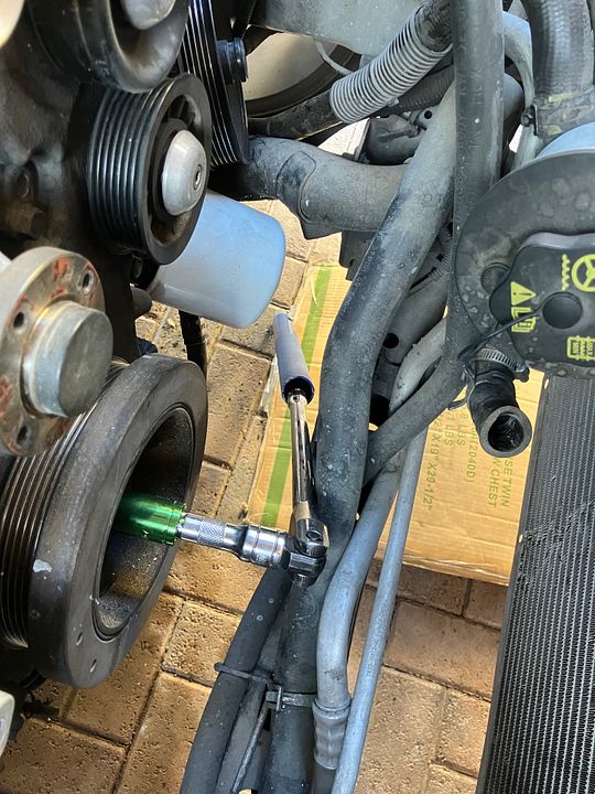

My method to loosen a stubborn crank shaft bolt. Easy peasy. Just make sure your battery is charged and blip the starter. Then unscrew by hand.

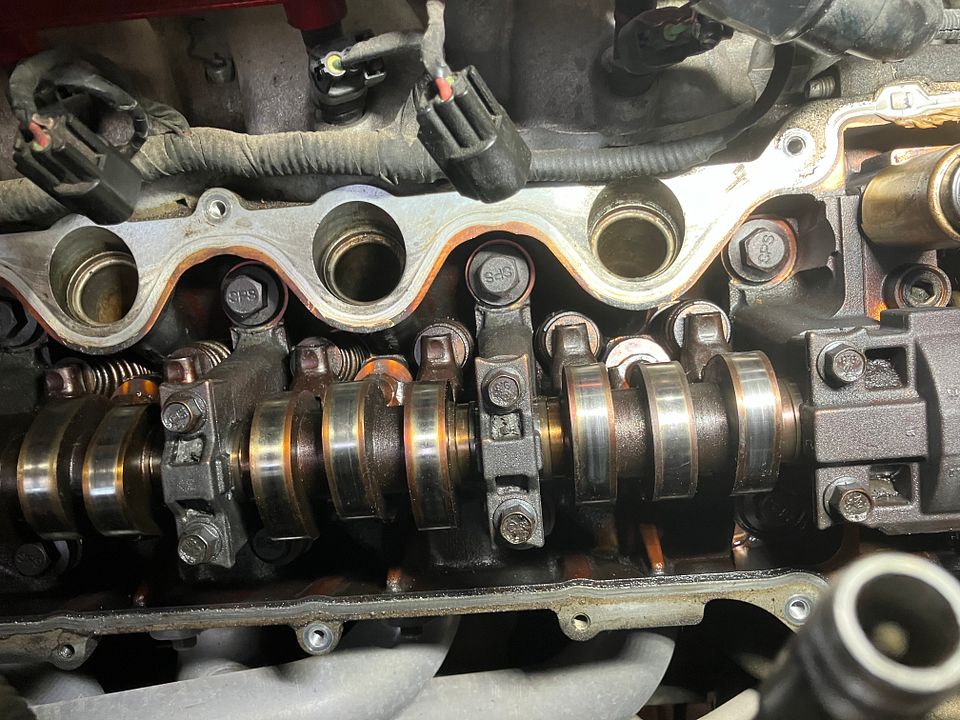

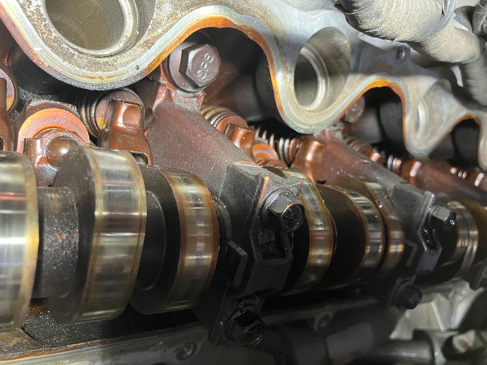

Cam lobes don’t look too bad for 160K miles (120K with cams). Everything looks pretty good under the covers.
Gave the covers a quick wipe down. Might hit it with some degreaser too.
Tomorrow the cover and chains come off. Maybe the pump too.
