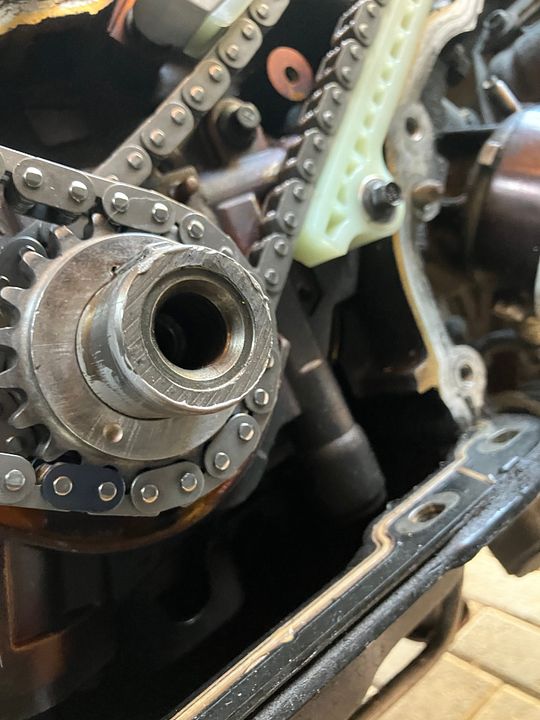

As far as the bolts for the tensioner. Mine failed due to lack of oil pressure. The tensioner must have have gone down and the chain started flapping away in there and sheared the bolts. I don't think I've ever heard of anyone shearing those bolts like I did without something else going wrong.
And a quick update: Due to continuing issues and being pressed for time I'm going to skip installing the pump at this time, reserving it for a time when I can be a little more casual. Yeah it's a ton more work to get in there again but I just don't have the time or resources at the moment. So I'm going to put the timing stuff in and button her back up.

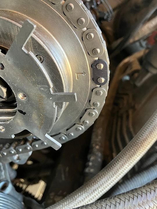

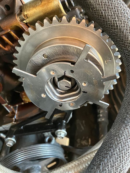

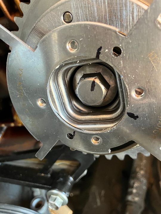

Anyways. After taking it apart 180* off (I was in a rush and not paying attention). I had to turn the crank and cams to TDC before lining everything up.
But phasers torqued to 30 ft/lbs and then 90*
Chains lined up.
Cover and ps pump back on so almost done. Cam covers, plugs, intake, fan and I’m pretty much done. I gotta remember to get to the store before it closes for some water and water wetter. Then I can fire her up tonight.
