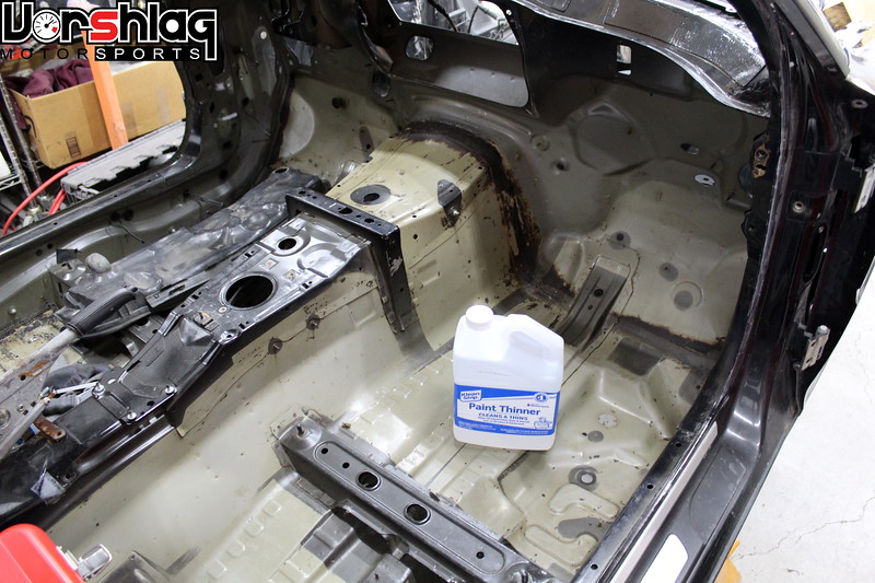

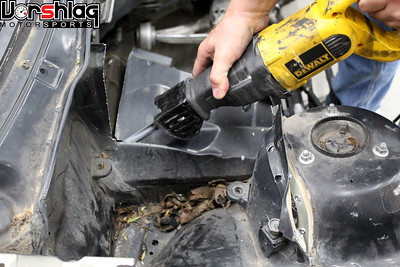

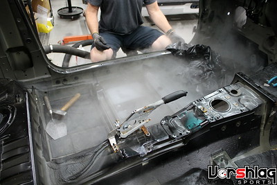

Our crew that started tearing this car apart one weekend (when I wasn't here), to make it into an endurance race car, literally ripped apart and threw away perfectly good interior panels and seats. When we aborted that plan and I decided to make this into a dual purpose street/track car to sell, we needed to keep the windows. Question: how do we cover the door openings on the inside? Answer: fabricate all the things!

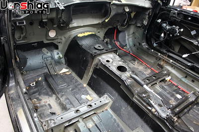

The carpets were gone and with that a lot of padding that covers up a funky floorpan shape and lots of big wiring bundles.
To cover up the "non-flat" floor and hide the wires a pair of "false floors" were built from aluminum sheet. Underneath is a lot of structure to keep them from buckling under the weight of a driver's legs, which is not shown. A custom "Dead pedal" foot rest was added along with some "Grip tape" (above) to keep your shoes from sliding around on the floors when wet.

FLOOR PANEL PREP FOR CAGE INSTALL
We already removed all of the carpets, dash, door panels and other useless interior bits in the first week of work back in April 2019.
What we were left with inside was a LOT of floor pan sheet metal covered in this adhesive sound deadening material, which I will refer to henceforth as "tar paper". Its really more complex than that, but tar paper is easier to write. We would fight getting this heavy, sticky, brittle crap out of the BMW for weeks, employing a number of removal techniques. Some here have even called it the Tar Paper Wars. One technique worked better than others...

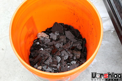

DRY ICE SLURRY METHOD on EVO X
We did a cage job back in early 2018 on this EVO X, which had a welded 4-point roll bar we had to cut out and got a proper 6 point roll cage installed in it's place. This car still had all of the tar paper installed, which we had to remove since the entire interior and cage would later be painted grey.
The method we used to remove this tar paper was suggested by one of our fab guys at the time, Aaron, who had used it successfully on Japanese cars before. The idea is the dry ice gets the adhesive holding the tar paper to the sheet metal so cold that the adhesive breaks loose, and then the tar paper comes off in whole sheets! I wanted to see this witchcraft in person, so we gave it a go on the EVO.
With a 5 gallon bucket filled with crushed dry ice, isopropyl alcohol was added to make a chunky slurry that looked like a witches caldron. This slurry was carefully poured onto the top of the tar paper (the flat portions), then was allowed to sit and chill a bit, then light percussion with a hammer or scraper was used...
It was like magic. This stuff just popped out in whole sheets! I never would have believed it, but damn, the results were real. In this EVO. This one time...
DRY ICE SLURRY METHOD on BMW?
We had high hopes and bought two 8 pound blocks of dry ice and a butt load of isopropyl alcohol to try this again on our E46 BMW's floors.
At first we tried a twist - putting the dry ice + alcohol slurry into a black trash bag, that could let us re-use the stuff in several sections, as well as the vertical paper applied at the front firewall, transmission tunnel, and back seat shelf around the fuel tank.
Well we gave up quickly on the trash bag, as it did not work at all. We went to straight dry ice + alcohol applied directly to the tar paper, as we did on the EVO. Problem was it was not working well on this car. Not at all.
We tried this method again another work night, with two more blocks of ice and more alcohol. And more "percussive" persuasion. After many hours over two work nights, $100 worth of dry ice and alcohol, we barely had the passenger and driver seat flat floor sections done, and it looks like a 12 year old's patchy beard. This just did not work on this BMW, maybe due to more advanced age or possibly different tar/adhesive materials the Germans used? I give this a solid FAIL rating.
I can NOT recommend this method to be used on a BMW. Not to mention that the alcohol poured out of the many plugged drain holes in the floor and trashed my new polished & coated concrete floors. I was less than happy about this - the alcohol/dry ice method is now banned in my shop.
"GIVE ME SOME HEAT" METHOD
We were still fighting this battle weeks later, and on the 3rd work night attempt to remove the tar paper, I insisted on trying my old proven method that we have used on dozens of BMWs in the past - a heat gun + scraper.
This worked so much better on this car. With heat applied to a small section of tar paper for a number of seconds, a 1.5" wide putty knife was used as a scraper, and this stuff peeled right off. Not in entire sheets like on the EVO, but in manageable chunks and in a timely manner.
The work went much faster than the dry ice, and no hammering was involved, just gentle scraping. It was like peeling fondant frosting off a wedding cake... came off in long chunks, after the heat nuked the adhesive.
The video above shows this heat technique used on some vertical sections of the transmission tunnel - which would be nearly impossible to do with dry ice, even if it even worked. Like all methods, this still leaves an adhesive residue behind, which we cleaned up on other work nights.
Tim tried a number of adhesive removers, from Acetone, to Goof Off Pro Strength, Brake Parts Cleaner, and finally Mineral Spirits/Paint Thinner. The Goof Off worked well enough, but its $15/gallon. The cheaper $7/gallon Mineral Spirits / Paint Thinner worked the best - just apply liberally to a blue shop paper towel, wipe it onto the adhesive, use some elbow grease, and the brown stuff comes off. Sometimes it took some work with a red ScotchBrite pad soaked in the same stuff as well.
I wouldn't call this adhesive removal step "easy" by any stretch of the imagination - its not a "spray on / wipe off" kind of effort. You gotta get in there, use some pressure, and a lot of heavy duty paper towels and a little ScotchBrite to get it off. Just takes time.
And sure, we could have used some power tools and abrasive discs or wire wheels, but that would have made a giant mess and we would have to prime the floors to prevent them from rusting before the interior is painted (after the cage is installed). I have heard from others that blasting or sanding this stuff only turns it into a fine mist of tar, which re-applies itself to the floorpan and other areas. As well as all over you and your shop. This heated peel + paint thinner method keeps the stock paint/primer clean and intact on the inside. We will just remove the paint near the "mounting feet" of the roll cage.

POWER WASH CHASSIS
This was a good time to stop and power wash the chassis, while it still could be rolled outside. On one of the work nights (during the middle of the "tar paper wars" above) we rolled the E46 outside and pressure washed everything.
Under hood, inside the cabin and trunk, exterior - all the things.
As you can see below, this is with some of the "rear seat" deck structure is removed.
So much nicer working on a car that has the stinky interior removed, grease and other nasty "road funk" washed out.

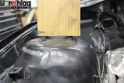

MUSHROOMED STRUT TOWER REPAIRS
Something we commonly see on E30, E36 and E46 BMWs is the front strut towers - which are supposed to be flat - get worn over time to have a curved "mushroom" headed shape.
This happens due to a somewhat thin sheet metal used to make the stamping for the strut tower plus the smaller, softer aluminum strut top mount that transfers load into the tower. If you hit enough big potholes over time, to the point of bottoming the suspension, the larger diameter strut tower will deform around the smaller strut top mount. The 3 studs from the top mount will also "splay outwards" like above. The two towers in this car were badly deformed...
The fix is rather low tech - I like using a piece of 2x6" lumber a a 3 pound sledge hammer to flatten the upper portion back into shape. Light rapping downward with this flat edge, walking around and pressing laterally next to around the inner ring. I fixed both towers in about 45 minutes, then we could install a camber plate on that side (during suspension and wheel mockups, which I will show next time).
This video clearly shows the technique on flattening the towers. Of course the front struts need to be out of the car to do this, and there are some tips to keep the towers from deforming again in the video.
