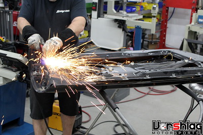

MORE DOOR LIGHTENING
In my last post I showed how we got the doors down to 29.0 pounds with some serious cutting, gutting, and removal of the window glass and associated mechanisms. We used a variety of cutting tools to get this structure out - including the plasma cutter and some cut off wheels in a pneumatic die grinder. Both methods are loud, noisy, and messy. Plasma cutter is probably the worst way to do this work, as it leaves a super rough edge that we then had to grind or cut away.
We foolishly forgot to weigh the full weight doors with glass so I don't have a good starting point to reference - but this 29.0 pound weight still seemed heavy for a gutted door, to me. Something didn't "feel" right about that weight. A buddy of mine (Andy) owns Clownshoe Motorsports and said his doors were lighter, so I stopped by their shop one Saturday.
I can't show many of the endurance racing secrets he shared with me that day, but we did measure some various tires, and noted the technique he uses to gut doors. They leave more of the upper structure but remove ALL of the lower structure, and much of the door striker bits. So we took our 29.0 pound doors and went to town on our next work night.
Tim and Jason got to work with the Saws-all and it proved to be a more efficient, less messy tool for cutting the door structures. Leaves a much cleaner edge, too. We cut off the ugly edge left by the plasma cutter and then started to work on the metal below the latch plate.
I then used some extreme care with the cut off wheel and took the upper "crash structure" out at the top of the door, on the inside. The slotted, 3D shape shown in the picture above left. We took this out of the passenger door, and it is heavy. All told we found another 2.1 pounds, which isn't a lot. We had already taken the main crash beam, glass, and regulator out of the door. We were starting to hit a big "diminishing return" type of task.
Tim suggested we KEEP the upper structure on the driver's door (shown with a red box around it, above left). He crews for two different pro level road race teams that have driver changes, and he has noticed that they tend to lean on the upper part of the door during stops. So we left that in the left door, and it is only 1.1 pounds heavier at 28.0 lbs (above left). This door was weighed after cutting some of the inner structure out and with the window + regulator removed, but the diagonal "crash beam" in place at 34.7 pounds (above right).
I made sure we weighed the full weight door (above right) on our 2015 Mustang road race project, which is going on a SERIOUS diet and getting an LS swap. 84.2 pounds for a door is extreme, but keep that in mind when you are gutting your door. We might find another pound in these BMW doors, but we have kept structure at the hinges, striker latch, side mirror mount and along the top of the driver's door. Any additional weight removed is going to make the remaining door compromised... I think we are there.

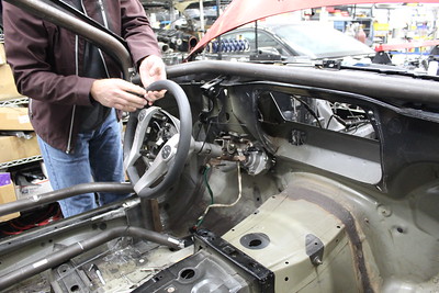

FITTING THE DASH + CHANGES
So the dash bar was changed from how Hank likes to make it. His tube is probably stronger, and you can stitch weld it into the cowl structure at the base of the windshield.
The above left pic is how Hank sends the dash bar. It can be stitched to the cowl and is pretty far out of the way of everything else. But it would murder the leading edge of our OEM dash, which I demanded that we use. So we did some work (below) and made this straight dash bar instead. I will explain.
We have a number of spare E46 dash assemblies, including this grey one and the tan one that came in this car. We took the tan dash (above right) and removed the bits we wouldn't use. It weighed in the 12-15 pound range (we will weigh it again later) but after we got a nearly finished weight under 2200 pounds (see bottom of this update) we figured we could afford a dozen pounds for a full dash skin.
The dash mounts to a complicated structure that has a lateral bar that bolts to the A-pillar/hinge areas (see above right) and has a lot of clips and stand-offs that tie into the dash pad itself. Of course we removed the radio, computers, HVAC and other heavy bits - we just want the shell. But the easier way to mount the skin was to tie into the base of the windshield (hence the removal of the Hanksville tube) and then to keep the stock dash bar (the rusty bits above). To be able to fit this OEM dash bar in front of the A-pillar / front down bars of the cage we had to hack away at the ends for clearance, then cut the tube in half.
Of course we could have done this intact if we had planned on using the stock dash bar before the cage was fully welded in place, but once we clearances the ends and cut it in half it could be slipped in place. Then we welded it back together. Obviously the structure of this dash bar is compromised now, with all of these changes. Hence the second straight dash bar that we added and tied into the cage. Again, it seems like a waste of tubing, but it will be MUCH easier to fit the dash skin over this straight bar than the curved bar the comes in this kit.
Me, Tim, and Magan (our newest crew member / future driver) worked all of this out one evening, test fitting and cutting the OEM dash bar until it fit. Then the dash was almost ready to go in (above right). We'll trim the dash pad - carefully and in progressive steps - to clear the A-pillar / front down bars, and then it can mount right to the OEM structure. Extra work but it will provide proper glare protection for the digital dash we will stick inside the stock dash "nacelle", and a dash pad really makes a race car look more professionally put together. With some of the parts we added below you might understand why that's becoming more important.

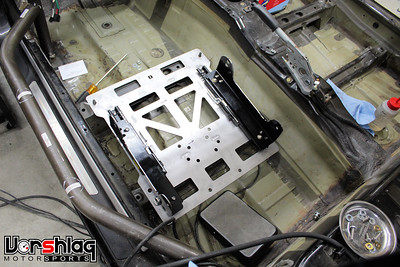

3D SCAN + E46 SEAT BRACKET DEVELOPED
One of my goals for this project it to develop new products - and one area we have been pushing into lately is seat brackets. I moved us into this arena reluctantly, but since many of the chassis-specific seat base bracket offerings out there are so terrible (too tall, too flexible, not safely built) that I felt we were doing the community a disservice by staying out of this area.
I wrote this forum thread last year explaining the "what, why and how" of our unique form of seat brackets. We have made these for 5 different chassis now and will be offering the E46 versions soon after I post this. We make these to bolt to the chassis, have mounting holes for lap and anti-sub belt anchors, and leave a swatch of metal that the end user drills and bolts their side brackets (fixed) or sliders to. All of these designs are minimally tall and have reinforcing ribs underneath, and we make them 100% in-house with CNC cut parts, TIG welding them on production fixtures.
We normally take manual measurements of each chassis' four factory mounting holes, but this time we were willing to try some new technology - 3D scanning. A helpful sales tech came by to demo his scanning products and used this chassis for the test. What it gave us was a point cloud that we could then translate into a CAD design. Don't know if it really saved much time, but it was cool watching this tool being used.
Myles turned that into a working prototype, which he CNC cut and we tested in the car (above left). The E46 chassis is pretty narrow and what he realized pretty quickly when this prototype was placed in the car is - we usually offset a racing seat pretty far towards the tunnel. The factory steering wheel isn't even centered on the factory BMW seat. So I worked with him on version 2, which has this offset built in, that he cut, tested, then welded in the reinforcing ribs for (above right).
Tim worked on the sliders and side brackets, which were tested on the seat, then the holes were transferred to the bracket (above right) and the sliders + brackets were bolted into the car. So we have one seat mounted. As soon as we make the passenger side version (they are sometimes mirror images of the driver's side, sometimes now) we will release this as a bracket to sell.

We removed the dash bar structure from the dash shell and started hacking away at it. To fit it between the two main A-pillar down bars we had to cut the OEM dash bar in half.
We cut the main bar to the right of the steering column support, notched the ends to clear the down bars, and put it into the car. Then tack welded it back together.
This way the dash pad has some of the OEM structure - which is a lot better than how some dash pads get installed. I cannot stand a floppy dash that is bouncing around willy nilly.
Since we compromised the structure of the bolt-in dash bar (we really had to hack up the ends) as well as cut it in half. We built a new straight dash bar to mount just next to the OEM bar. This is going to be hidden under the dash but this one has real structure and ties into the cage in case of a side impact. We will tie the OEM bar to this one, for the structure needed to hold the column. We still need to notch the plastic dash pad to fit around all of this, but I will show that in a future update.

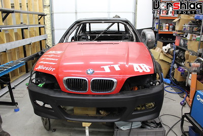

The composite Seibon hood (24 pounds) is considerably lighter than the stock steel hood (42 pounds), but it is weaker in some ways also. When some of the crew were man handling the hood into place back in March they only had one bolt on one side fastened and somehow with the hood struts installed on that hinge it was tilted, which cracked the mounting flange for the hinges on one side. I've seen similar damage done when using (mostly aftermarket) gas lift hood strut kits.
I was less than thrilled, but "stuff happens" and at least it wasn't a customer's car. Evan extracted the threaded insert plate that had pulled out and sanded the areas to be repaired with more layers of glass and resin.
He cut a space for that into the composite then used fiberglass mat and resin to cover that plate and reinforced the whole area. A little primer and it is as good if not better than new.
We installed the repaired composite hood for a while with one new OEM gas lift strut on one side, but it still felt like the hood was going to fly off when we lifted it up. Just sitting there with the hood up it was bending that side, so we had to do something different. I had an idea...
In late August I installed this S550 Mustang hood prop rod setup. This is an aftermarket, stainless steel version of an OEM prop rod made for 2015-up Mustangs, which was easy enough to install. I added an M6 threaded insert to the radiator support and bolted it on during one of our work nights. Still might tweak this a bit after we get the cold air intake hose and airbox in, but this way we can hold the hood up and NOT have the gas struts trying to bend the hood in half.

We have been talking about using an "Electric Power Assist Steering" (EPAS) column in this car since the beginning but I have not shown that yet. Why? because unlike aftermarket supplied units we have used in the past, we're trying to do this with cheaper OEM based column.
The aftermarket EPAS unit above worked well enough in this V8 E46 M3, and I got some good first-hand experience with this on track this January. But it was expensive ($1800-ish) and required a lot of work to join their electric motor to the E46 steering column. It does have a steering force controller on a dial, which is nice, but it wasn't working 100% of the time in our track test. We're chasing issues with that now.
Instead we're trying to make a steering column from a Toyota Prius model retrofit completely into our E46 330 endurance chassis. This could make for a lot less hassle during the install or for replacements later (expect everything to break on an endurance car at some point). We have researched several units and some racers have used the 2004-09 Prius unit (above right). But we have very different height drivers in our car, so the tilt/telescope feature of the 2010-14 Prius might work better for us. We bought both to test with.
Myles has designed and cut out a couple of different brackets that were bolted or tack welded to the BMW steering column mount, to test both the early and late Prius columns. The column was "clocked" so that the motor was not down by our legs this time, as shown above.
To complicate matters the chassis we started with came with no steering column at all - it was pretty stripped - so we didn't have a good gauge of where the steering wheel should be. So we paused the steering column testing for a bit to wrap up the E46 seat bracket base, get the seat installed on a slider as low as possible, then proceed with more Prius steering column mock-ups.
It wasn't until the seat was mounted and the cage largely complete (late April 2020) before we could "test sit" the column. Above is the early tilt version shown at two tilt heights. We could never find the correct Toyota wiring diagrams and pin-outs for the later tilt + telescoping version, so that version will have to wait. We got some schematics, but they were wrong and didn't match the 2011 column we bought.
Tim sourced a Flaming River U-joint that ties into the base of the steering column's intermediate shaft splines and goes to a 1" DD shaft. We then connected the other end to another shaft that will have our BMW 54 spline U-joint at the steering rack. A "center bearing" at the fire wall is needed to keep this multi-piece shaft lined up (a support bearing at the firewall is normal).

REAR SUBFRAME MOUNT & RTAB REINFORCEMENT
Like all BMW E46 chassis, the rear subframe mounting points on the tub need reinforcement, so that was a big task I saved for the new guy, who was a welder for use for a number of months. We do these jobs periodically for customers and I like to break in a new tech on a shop car instead of on a customer's car.
In the last week of May 2020 we made room on the lift for a couple of days to tackle this work on the clock. Brad and Evan showed the new guy how to do it and helped remove the fuel tank and rear subframe.
After the chassis was cleaned of paint and undercoating (the least fun part of this job) the CSM reinforcements were bolted into place and it was time to TIG.
The 6 plates were TIG welded, seam sealed, primed and painted within a couple of days. While the OEM fuel tank was out I went and power washed that to look as good as new.
One of the areas on the chassis I have personally seen fail (at least on the E36 chassis) is at the RTAB cassette mount. So I asked Myles to make a tracing of the OEM mounting holes and shape, design a CAD drawing, then cut a pair of reinforcements. With one small tweak we had a new product, and we are using our chassis to test it out on. Which is part of the reason why we're building this car.
With the RTAB reinforcement welded in, seam sealed, primed and painted it was finally time to install the upgraded, powder coated, and stronger E46 M3 rear subframe and diff. This move let's us go from an open 188mm diff to a limited slip 210mm M3 diff.
