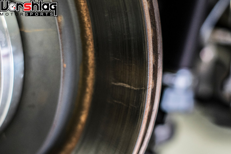

Since last weekend we've replaced the rear pads and rotors (the rotors were so thin one had "popped"), installed the new MCS RR2 dampers, changed the rear spring rate (from 350 to 250), altered the rear ride height, corner balanced and aligned the car, bled the brakes, changed the oil and mounted up some 320mm Continental slicks.
No major changes, just some new suspension bits to test and a little preventative maintenance. Amy will be driving the Mustang at the Track Guys Performance Driving Events this weekend at TWS and we will stop by and see some of our SCCA friends at the National Tour event in College Station. I will have several used 315mm Hoosier A6 and R6 tires for sale for $100 cash/each at my trailer during this event - stop by and see what you think. We will be posting lots of these tires on our clearance page, as well as the used Moton Club Sport doubles, next week.

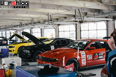

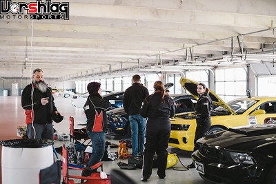

We didn't take over the whole garage but a good quarter of it was Vorshlag folks. The event was a bit under-attended by local drivers, due to a few factors: 1) Not many folks knew what USCA was or knew the rules/classes. 2) The entry fee was a little steep. 3) There were several other racing events going on that same weekend that drew potential entrants away, including: inaugural WRL race at MSR-Houston, Texas Mile, and BMWCCA at COTA. I got a call from one of the USCA principles a week before the event and we worked out an even better deal where local folks could get $250 off their entry fee + I threw in $100 service credit at Vorshlag for a $350 in savings. I then made a number of phone calls to customers, got another 7 folks to join us, ordered several sets of BFG Rivals, and then there was a flurry of safety gear outfitting at Smiley's that week. All told we had 8 entrants that had "Vorshlag" on their order form, out of the 38 signed up, and I'd like to thank ALL OF THOSE FOLKS for stepping up: Jerry, Jan, Shannon, Heather, Michael, Jon, and Marc!
7 of the 8 Vorshlag customer entries at the TMS round of USCA

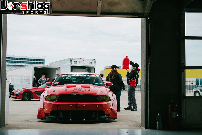

We arrived Friday and we had a naked red Mustang (see above) - and yes, I prefer it that way as well. We were going to try to "tone down" the Vorshlag and race car graphics a bit, but they still had a gaggle of event and sponsor decals for us to add, so Amy got to work.
As our other Vorshlag customers and friends arrived Amy was drafted to install many of the bigger "event decals" as well. And then someone wanted big Vorshlag decals, which we had a limited supply in our trailer, so those started going on cars ... including our own.
Amy also showed some folks how she installs big decals, both wet and dry, and passed along some knowledge. Once Shannon saw Amy's decal tricks she started helping her sister and mom with installs on their cars, too. Yep, two sisters and a mother all entered this event in their 3 track cars - they all did well and snagged a lot of camera time, with about 4 special interviews sessions. Look for a side story about Jan, Heather, Shannon, and "the women of USCA" in the episode that will air for this Optima Challenge event! (sometime around August 15th on MAVTV, the Lucas Oil channel)
I was reluctant to "over-Vorshlag" our Mustang, as this event was about street cars and I wanted it to look the part - well, as much as possible with a giant wing, flares and splitter. So we put some simple black Vorshlag decals on the rear flanks, which are much smaller than we normally run. We also kept the white Vorshlag.com windshield banner, and added some small decals for our main products: Whiteline, Forgestar, MagnaFlow and Maxcyspeed.
To show BFGoodrich some love we got a BIG Rival "R" decal from the BFG rep on site. This was added to the hood and two small "R" decals went on the front flares. Marc followed suit in his red C6 Z06, and we all added the Optima windshield banner, Redline oil rear window banner, the giant Optima door panel decals, the numbers we were assigned, and the tall strip of sponsor decals for the sides.
Doing that many decals on 8+ cars carefully enough to avoid bubbles, wrinkles and tears took Amy and everyone else a few hours, and we cleaned up some exteriors as we went also (some folks still bring a dirty car to an event that is televised, ha!). We all got registered, teched, had all of our safety gear checked (more on that in the Sunday Road Course section), and met a bunch of cool folks who were also arriving.

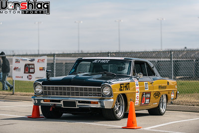

There were also lots of famous folks from the Pro Class of Goodguys and Optima Street Car events. Kyle and Stacy Tucker from Detroit Speed and Engineering had their transporter full of cars and they both entered. Infamous autocrosser and road racer Danny Popp entered in a wild 5th gen Camaro prepped by Lingenfelter. Bret Voelkel from RideTech was there in his Camaro, and autocrosser Cheryl Herrick from JetHot had a Nova that was absolutely beautiful inside and out. Ryan Mathews, a former NASCAR truck series driver, was entered in a race prepped 5th gen Camaro from DSE that had big aero, no interior and a full cage. Last but not least, 2013 Optima Challenge winner Brian Hobaugh was there in a really beautiful and monstrous 2nd gen Camaro built by Maier Racing - who builds epic autocross cars from Detroit iron.
There were so many AMAZING cars! Detroit Speed had several that most people would give a right arm for. So did Ride Tech, and many other Pro Touring shops from around the nation. It helped to have the Goodguys event the weekend before, so many of these shops that normally wouldn't have made the trek to Texas brought big transporters full of cars and ran Goodguys, flew home for a week, then came back for the USCA 3 day event.

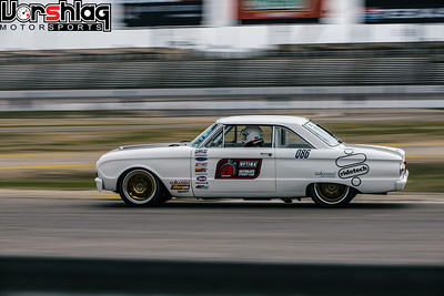

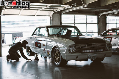

Dallas area's Aaron Kaufman from Gas Monkey Garage was entered in his 1963 Falcon (which he is taking to Pike's Peak this year), but he only ran on Sunday in the road course event. From what I heard there might be a conflict with his Discovery channel TV contract, so he and his car probably won't be shown on the episode that was filmed at this event. Too bad, the car looked great - but Brandon got a lot of good pics of his car.
We spoke again at this event with Aaron and a couple of the guys from the GMG shop - all super nice folks. Marc even tried to get Aaron to co-drive with his team in a ChumpCar race at Daytona in May, in his "Poorvette" C4 Corvette that we caged. That car is a riot!

Our warped front rotors paled in comparison to one competitor (who shall remain nameless) who lost an alternator on the road rally and had to stop and get 4 car batteries, which he swapped out when each one would die. Towards the end of the 91 miles of heavy traffic driving he noticed high coolant temps. They had to change a head gasket that night, and coupled with a complicated alternator swap they finished work on the car at 5:30 am Saturday morning! Long night, but he made it to all 5 checkpoints and raced Saturday and Sunday and drove it home, too.

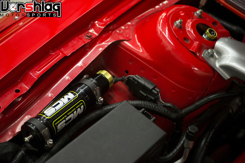

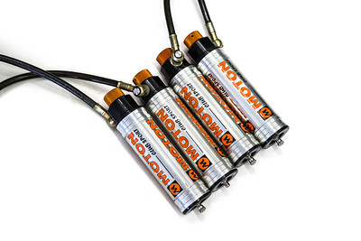

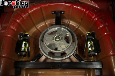

We recently installed our 4th different set of shocks onto our Mustang - a set of MCS RR2 shocks that I will show in one of my upcoming posts - so our old Moton Club Sport remote reservoir double adjustables are now for sale. We bought these new in May of 2012 and they have proven to be very rugged, have a large rebound and compression damping adjustment range, and we've set a lot of track records and notched up a lot of wins on these.
What you see here is for sale, just as they came off our TT3 Mustang a week ago
Lots more information can be seen about these used Motons if you click the pictures above. A winning set-up, real-deal remote reservoir Moton doubles at a big discount. If you don't see them listed on that page then they have sold.

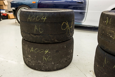

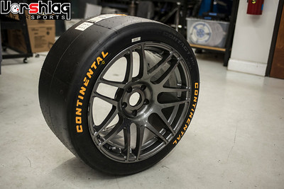

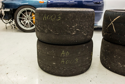

Last but not least, we still have multiple sets of the new 305 and 320mm Continental DP racing slicks as well as a many pairs of used Hoosier DOT racing tires we need to move. Stacks of tires are all taking up far too much room in our overly crowded but climate controlled shop. The Contis are normally about $2000 for a set of 4 but the we have dropped the price on these brand new race tires to $550/set, below what we paid for them.
All of the used Hoosiers listed right now are 315/30/18 sized A6 tires, which until very recently was the tire we used on our TT3 Mustang. I normally hoard my old race tires, but since we moved to the 335/345mm tire sizes on our Mustang, the crew here is grumbling at me to move out these 315s. Each Hoosier has some tread left, and we have listed each pair currently for sale with pictures of the actual tires being sold and DOT date codes from the sidewalls.

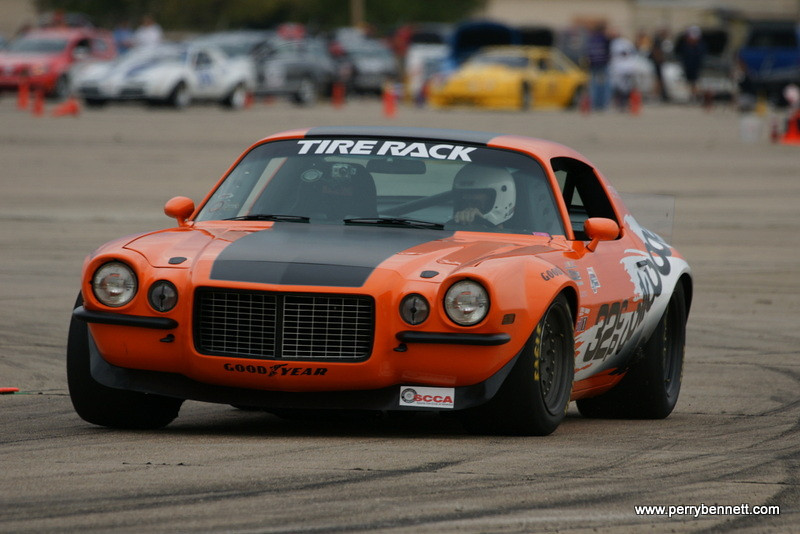

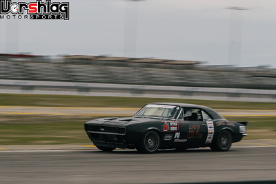

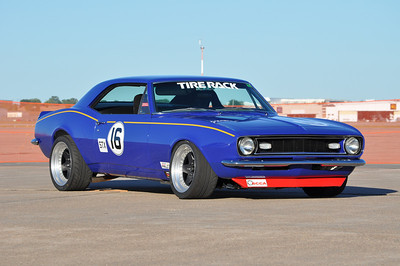

This Pro Touring "movement" has been around for a long time, and there are disputed stories about which was the first Pro Touring muscle car. The car I remember first, and that those of us that have been around HOT ROD magazine long enough remember, is the Gottlieb 1969 Camaro called "Big Red". This was more of an "Outlaw" top speed event car, but it had the look that Pro Touring adopted. This car even has its own Facebook page and it's own website. Built in 1987 (when I was but a wee lad) this car became a semi-tube framed "silhouette" car with a giant 540ci V8 motor that made 750 hp, wild and crazy and very little of the 1969 Camaro was left. It started out radical and nuts. It was built to run the La Cararrea and Silver State Classic open road races, and the car had just enough of the look of the classic Camaro to be allowed to run those. It was an over-the-top build that is chronicled here.
The cars that followed, like the Camaros from famed Pro Touring builder and GM Engineer Mark Stielow, were still packed with crazy powerplants and modern suspension, but more often than not today's PT cars are still mostly based on factory unibody structures and much tamer builds compared to Big Red. These are more streetable cars that were entered in One Lap of America events, and later beget the Goodguys and Optima "Pro Touring" scene. These latter events were made to allow pro built show cars to have a place to show that they were... more than just show cars. Show them being driven in competition.
A pair of 1st gen Camaros built by Mark Stielow, which both ran in Optima Invitationals
As these competition events have grown in number and popularity, more radical Pro Touring builds have been built and they are fast approaching the Gottlieb car - and in many ways have surpassed it, at least in suspension sophistication. These PT cars have more and more radical mods: extreme lightening, lightweight and big race motors tamed just enough for street use, and modern, uncompromised racing suspension designs. The popular front suspension for a 1st or 2nd gen PT Camaro includes narrowed hydroformed frame rails with aluminum spindles, modern double-A arm suspensions, and a narrowed set-up that allows 315 or 335mm tires to fit with the outer track unaffected. The transmissions are increasingly more racey (Jerico, G-Force, etc) to take the power of these big LS-V8 engines. And rear suspensions have gotten beyond solid axles, with fabricated tubular IRS set-ups going under classic Detroit Iron.
And even the "iron" component is becoming less evident, with engine blocks mostly in aluminum and sheet metal going over to lightweight composites, even carbon fiber. There are Pro Touring cars with 4 pound fiberglass doors, Lexan windows, CF front ends, and big aero, with exotic materials and methods creeping in. And why not? There are essentially NO RULES in most of these series - even fewer than the admittedly open NASA Time Trial "numbered classes" (TT1/2/3) that we here at Vorshlag campaign in. On top of that PT cars usually have show quality paint, bodywork, interior coverings and more. You can spend a lot of money building a fast Pro Touring car, and the arms race doesn't seem to be slowing down. With top name street rod and race shops building these cars, price tags in the $100-200K range are not uncommon.
A Pro Touring Camaro being built with an LS9 engine, custom crossmember and firewall, modern suspension
I'm not saying they should change anything in Goodguys, ASCA, Optima or USCA, not hardly. More power to 'em! These cars are beautiful and fun to watch, and these groups all put on helluva show. I'd give my right arm to be able to own one of these Pro built cars, or to have clients that trusted us enough to let Vorshlag build one for them. But that's not what we do, and the PT type scenes is really not what the SCCA is about, either (more on that in a second). Sure, the 200 treadwear tire limitation does ultimately put some limits what you can do that really matters, and the 3000 pound minimum weight for the main class in USCA is a good number, but these series and the PT cars that enter them are going to get wilder and less recognizable as time goes on.
A classic Camaro built around SCCA Solo rules looks almost nothing like a PT car underneath
Why do I bring this up? Because the SCCA created a class explicitly to attract Pro Touring cars called Classic American Muscle. And this class has the fewest rules of any class SCCA has created in the history of Solo. Jason Rhodes deliberates on the many problems with the ruleset in CAM. Jason built the 1967 Camaro Z/28 shown above for STX class, only to have it moved to a less competitive STU class a year after its debut. If you look at the CAM rules from a racer's point of view there are some crazy things that you could build. And in typical SCCA style, the rules makers haven't thought this through very well, and when (not if) these wild creations show up there will be a series of TAKE BACKS and rules changes the likes of which have never been seen.

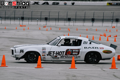

Brian Hobaugh's Pro Touring Camaro ran in C Prepared class at the Solo Nationals, and did very well

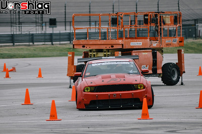

Ride-Tech Autocross Course

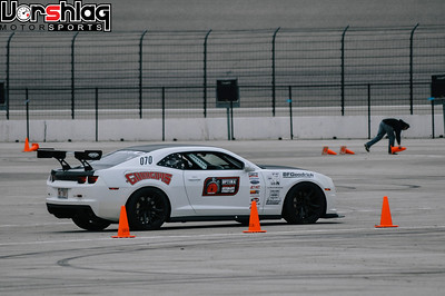

I will start with this Saturday event first, since I was in the "Odd" group that started out on the Autocross course first, and then we switched about every hour between this and Speed Stop. Towards the end of the day both courses were open to anyone, and lots of people had stopped running while others kept taking lots of runs.
Before we got going I took my walk-throughs a little more seriously and jogged / walked briskly by myself two times after walking it once with some friends, to get a good look at the autocross course. Chatting with others is normal on your walk-thrus but I've learned that I absorb a lot more of the course when I walk by myself, without distractions.
The course was set-up by an experienced SCCA autocrosser and it looked good, and nothing like the Goodguys gymkhana course we ran the weekend before. This made me very happy, as it would more suit a "normal car" and not the strange gearing and insanely tight turn-arounds that the Goodguys courses focus on. It wasn't an "easier" course than the weekend before, per se, just more flowing and with higher average speeds. Gone were the worries of another "1st gear only" course and as I walked the site it felt like a perfect 2nd gear course for our 3.31 geared Mustang - and it was. There were a LOT of cones and they even lined the course with white chalk, so it should be hard to get lost. If you did make a mistake I could see where there would be a lot of cones to collect.

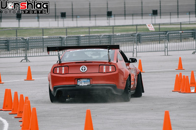

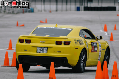

Left: The man lifts used for filming were in the middle of the course, out of the way. Right: The world's biggest video screen, recently added to TMS
They had video camera stations and Man Lifts set-up inside the course, and the layout had one crossover, but it made for a much bigger layout. If you look at the map in my previous post they had a LARGE area for the autocross to run in, much bigger than Goodguys used the week before. This is where SCCA normally has the paddock when they do the TMS Road Course autocross events, and it was BIG. There were a few "gotcha" sections the designer put in there, trying to make it challenging, but nothing that someone with 25+ years of autocross experience couldn't see past, heh.
Event Results: http://www.optimabatteries.com/en-u...street-car-invitational-field-adds-four-more/
Left: The Autocross course was overlooked by the Optima Prime trailer. Right: Dennis Pittsenbarger was announcer all weekend
There was a slight delay while some timer issues were worked out. The USCA folks had a brand new timing system, but the wireless lights were apparently interfering with another signal. The Texas Region SCCA folks working the course and instructing helped them diagnose the issue and it was found that the 3+ TV cameras around this course were stepping on the signal for the lights, so they fixed that after a bit. Before they did Jimi Day sent our group to go make one run on the speed stop course, while they fixed the issue. I'll talk about that in the next segment. Also, the weather was super sketchy. Rain was in the forecast (not if but when) and the temps had fallen, with winds whipping up all day. You'll notice dark clouds in many of the Saturday pictures, and that's what we ran under all day - a constant threat of rain.

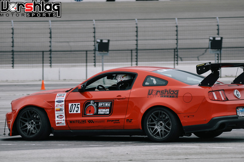

Once the Autocross course finally went hot around 10 am I got in a fast first run. I was lucky to have Amy, Kyle and Jason spotting on the course, listening for times, and helping with tire pressures and getting me ready before each run. I made a few more good runs in the first session by the time we were told to switch events with the "Even" group. At that time I was temporarily in the lead for the Autocross. We came back to this area 3 or 4 different times that day, and I quickly found out that my early leading times had fallen. I was in the low 43 second zone in the morning but the big gun drivers were already in the 42s and Brian Hobaugh was in the 41s. Yikes! I stepped up my driving and worked the tires hard, trying to maximize rear grip.
The rear tires became the limiting factor in everything on the autocross course that day. Yes, even with 335s on the back the car struggled to put the power down from this stock Coyote 5.0 (433 whp SAE). I was pushing the car to the edge of the cones, and picked up more than a few cone penalties that day (often just stepping on the cone bases, which is verboten in USCA). The event announcer (Dennis Pittsenbarger) was noticing my quick-ish times but was quick to also point out my penchant for cone penalties, and dubbed me The Conekiller, heh. He had nick names for lots of people, like "Cookie Monster" for Jon Miller - who had won a big bag of cookies in the Poker Run - and "Five Eights" for Marc Sherrin. He kept all of us informed as well as entertained all day, standing atop Optima Prime announcing.
I earned the Conekiller name, of course, but luckily this wasn't a "3 and done" sort of event. I kept making autocross laps until I could get a faster time clean. Then I'd push in another area and run until I had it clean and faster. Rinse, repeat. Over the day I made close to 20 autocross runs - more than most but less than a few. I worked my way into the 42s, then the high 41s. At one point I had a 41.7 second run but that wasn't good enough for the win, as Hobaugh had his orange Camaro down to a 40.900 second run. Brian Finch and Kyle Tucker both had 41.7 times a hair quicker than mine, so I was in 4th. I didn't think I could catch Hobaugh but was so close to Finch and Tucker that I kept making runs, looking for a tenth...

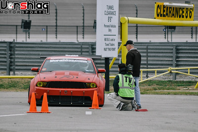

Side note: everyone was supposed to stop in a stop box after the autocross Finish timers, but I quickly noticed that most of the Pro drivers blew that off, as it wasn't manned like the stop box in the Speed Stop event. I kept killing my brakes to try to make that stop box, and it was TOUGH. But the new Ford Racing M-2353-CA" ABS/TC module worked brilliantly and our Mustang was definitely stopping well, considering the hefty weight it was carrying. All of the weirdness I've noticed when autocrossing on street tires was gone - with this ABS module I could go from wheelspin into full ABS braking without it missing a beat. It never once let me down all day - success!
Left: Our latest ballast weight rack, now with MCS remote reservoirs installed. Right: Our Mustang on the autocross course
We had the TT3 ballast plates removed (above) but the Mustang still pushed 3550 pounds, then add another 200 pounds for me. Many of these top Pro drivers were in purpose built muscle cars and were much closer to 3000 pounds, which was the class minimum weight for the "GT3" class - the class we cared about.

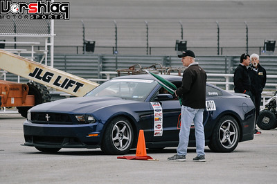

Strangely they arrived back to the paddock with a 5 gallon fuel jug and dumped that into the tank while I was strapped in. I figured they found a competitor with some 93 octane and would replenish that next, but I asked them "Where did you get that fuel?" They said, "It was in our trailer". "Uhh.... that's not one of our fuel jugs. You need to find out what you just poured into the car, please."
E85 ethanol fuel is becoming popular with racers running boosted engines, for the high octane rating yet low cost compared to race fuel
I don't think anything more of it and I'm in line about 4 cars back from the start line, ready to make a run, when Jason runs up and says, "Shut off the motor, that was E85!" Oh crap. I pull out of line and get out of the car. He explains that a friend of ours put his fuel jugs in our trailer overnight, after I told him he could stash his stuff in our trailer. He runs E85, didn't mark his fuel cans, and they just put 5 gallons of corn juice in my tank. CRAP! I kind of... lost my temper. I wasn't so much mad at them but mad at myself for watching them put "unknown fuel" in our car. I should have stopped them. They went to go get our fuel jugs both filled, and we talked about ways to get this fuel out of the tank. Kyle had already left for the day and we didn't have the Ford quick-connect fuel line tools needed to make this easy. The weather was looking bad and we knew we might get rain at any minute. The only dry runs left for the day were about to happen in the next 10 minutes. CRAP CRAP CRAP!
I did some mental calculations... I had about 2 gallons of 93 octane in the tank (fuel light had come on) when they dumped 5 gallons of E85 in there. There was not enough time to dump out the tank and no tools on hand to do it easily. We'd need to run to town, get the tools, dump the fuel, refill it with 93, and that would take an hour or more. By then it would likely be raining and the day would be over. I needed to make some more speed stop runs as well. Instead of all of that I decided we would DILUTE the E85 with a lot more 93 octane, but before that I'd take one more run. I was so mad, and so far back in the standings (4th place would cost me a lot of points in this event) I just didn't care, and needed just a tenth of a second better to make 2nd place in the autocross.

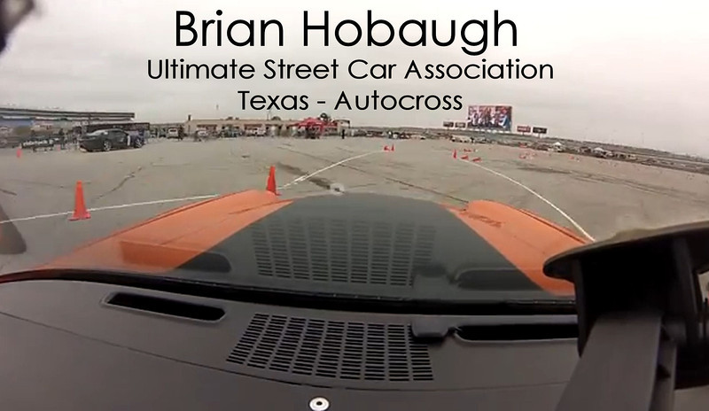

My 41.58 run still was pretty far off of Hobaugh's best, and he backed up the 40.9 with another 40.9. Nobody had anything that could touch him in the autocross competition all day, but even being almost 7 tenths back my 2nd place finish was good enough to net me 22 out of a possible 25 points, which made all the difference in the end. After we quit switching courses between the even and odd cars we were finally able to run together, so and I could watch Tucker, Finch and Hobaugh run. Wow, those guys were hailing some tail.

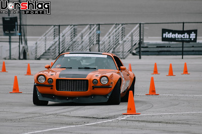

Left: Hobaugh's Camaro was in a league of it's own. Right: He took a lot of autocross and speed stop runs! Each of those papers is a time slip.
All of their cars looked great but Hobaugh's Camaro was so hooked up I cannot describe it. Here is one of his runs on video, below, which is obviously much faster than any of mine - or anyone else's. He dominated the Goodguys autocross event the weekend before (on Friday/Saturday) by an even larger margin.
That Camaro is hooked up and Brian had no driving mistakes. Very well done. Agian, he won the Optima Invitational last year in his dad's 1965 Corvette, and he has been autocrossing for something like 28 years, so he is no stranger to these events. Looking at his video, I'm going to have to step it up driving-wise as well as make some fundamental changes to our TT3 set-up to work better on these street tires for the Vegas Optima event. I had enough little driving mistakes but for the most part my run was right on the cones and on the limit of the tires everywhere.
I might never catch Hobaugh on any autocross course, and I don't think with 100 more runs that Saturday that I would have caught him. That car is seemingly tailor made for the tight stuff, and I was very happy to pull off 2nd place at this event.

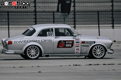

One of the more popular builds was this vintage Volvo built by "Swedish Ops". This had an LSx V8 swap and a manual transmission. Apparently they lost a McLeod hydraulic throw out bearing and had to snatch the transmission out to repair it. This was one of 2 cars in the "under 3000 pound" class, which it ended up winning. It barely made weight, as you had to weigh under 3000 pounds to run this class.

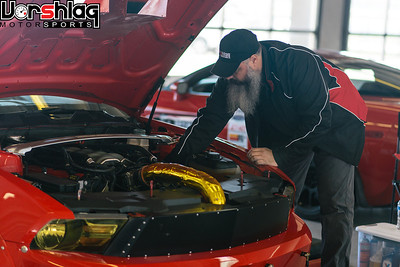

Saturday was also a bit of bad luck for the DSE crew. Kyle Tucker's 2nd gen Camaro munched a clutch, one of the multi-disc variety. His crew had the transmission out and the clutch changed in a little over an hour, and he was back out there making Speed Stop and Autocross runs.
Last breakage that I recall on Saturday was Danny Popp's 5th gen Camaro. We heard it go "BANG" on course after it had blown a CV joint in the rear halfshaft. Without any spares he was out of the event and didn't get to make a lap around the road course on Sunday. That sucks, and I hate seeing a top competitor like this get his weekend ended early. I'm sure we'll see Danny at another USCA/Optima event soon, and it looks like on Facebook that he's testing this Camaro on the BFG Rivals (he was on 305mm Goodyear Supercar tires during the USCA weekend).

Cheryl Herrick's beautiful Chevy II (above) from Jet Hot won this event, and if you had seen it up close you'd know why. That car was amazingly well prepared and scored a 72.2 score on the 0-100 judge's subjective scale (7.2 points) and she also netted the maximum 15 points for "the street amenity score". Her overall score was really only a 22.2 out of 25 possible points (only 1.1 points better then our Mustang), but since she ranked first she got the full 25 points in this category. That ranking thing is how they do it in all categories, and it really pays to win as many events as you can. Finch scored one place ahead of me here (by a 0.2 point scored margin, doh!) and netted 20 out of 25 points. He also beat me on the Speed Stop by one place, but I nudged him on the autocross by one place. So, unbeknownst to me, I went into Sunday 2 points behind Finch and what I thought was a huge gap behind Hobaugh. But his Camaro's Design score was hurt by the lack of a some street car parts and the resulting ranked score was only a 6.95, which hurt him.
