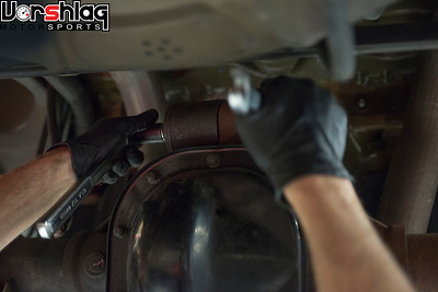

Another change he had in mind was a new rear Upper Control Arm assembly. After reading what we had to say about poly bushings, Del-Sphere and all of the other variations on the upper arm and mounts he went with some brand new "ultimate" UCA from BMR, shown below. The instillation was straightforward, but still time consuming. You need a lift, removal of the back seat, and a BIG torque wrench for the main bolt (which should be torqued to 250-300 ft-lbs, depending on the brand - see your manufacturer's instructions) to tighten the mount to the chassis. The pinion angle also has to be adjusted, and there is even a second set of holes in the chassis mount for potential geometry changes.
The upper control arm is one of those places where a spherical seems like the right choice, as this bushing has to pivot much more than the LCA bushings do. And to match the new upper arm's spherical he went with a Steeda spherical bushing replacement on the axle side of the UCA arm axis also, per our suggestions.
Getting the OEM rubber bushing out of the axle side is a real B!TCH of a job. The instructions say to cut out the old bushing, but if you make a tool to press it out you can re-use that to press in the new Steeda assembly. Then when you go to tighten the 58mm (?!) hex nut for the new spherical you might need to make a tool for that as well...
After finding a massive 58mm socket for around $35 we had to chuck it up in the lathe to machine the outer diameter down for clearance, otherwise it would not fit in the space between the axle housing and the bushing mount. Really fun job, that one, heh. After all of this work was done I drove this car around our Test Loop (bumpy road we use to listen for creaks, pops and noises plus to test ride quality) with Mark in the car and we both agreed that it makes a LOT more noise inside now. We had previously rebuilt his entire axle with all new bearings when we did the 3.31 gear swap, and the rearend was silent as a church mouse just hours before, but after the double spherical UCA set-up was installed it was much LOUDER inside the car - and he still has the back seat installed. Just know that this particular UCA set-up adds a lot more NVH than you might expect - you will hear all sorts of noises from the rearend that were masked before. Mark said he likes the feel of the new set-up but needs more seat time to give a full review. You can read his build thread on s197forums here and he talks about the new seat and the BMR UCA in post #262.

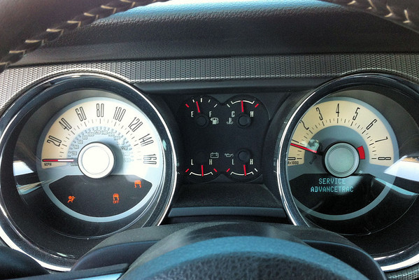

Hey, Terry. Sometimes during an autocross run (on 285 street tires on all 4 corners), I notice that my dash looks like this after crossing the finish line:
Only way to make it go away is to cycle the ignition. Does that mean that AdvanceTrac turned itself back on?
Hell yea, Chanel 51 BPM and Channel 52 on Sirius are my jam!
I knew Terry had good taste in music. :thumb:
That's what mine would do too on left handed 180's on autocross courses.

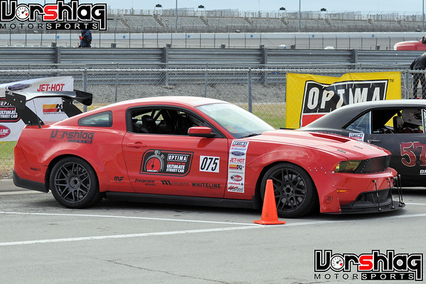

Seeing the competitors in this field that showed up I was hoping to be top 5, at best. I'm still stunned about the overall win for the event.
Our 2011 GT gridded next to Mike Dusold's twin turbo 7 liter LSx 1000 whp 67 Camaro
We had some luck on our side and just kept taking more and more runs on the autocross and speed stop courses until I simply couldn't drop any more time. I think I took over 30 speed stop runs and over 20 autocross runs.
When it came to the road course event I took at least 100 laps on the 1.1 mile circuit. I went out in all 6 sessions, each of which was 15 minutes, and made as many laps in each that I could. Having a reliable car with a stock drivetrain that never hiccuped once made this large number of laps possible.
Of course we also had a well prepped car, with the best tires we could get (BFG Rivals), and I had a lot of help from our shop. Jason and Amy were there all weekend, Kyle came out for Saturday (swapping front rotors before the day started), and Brandon and Sofi came out on Sunday. Big thanks to them!
Vorshlag also managed to have 10 entrants in the ~40 car field, and I have to thank our customers for entering at the last minute, after much prodding by me on the phone last week - without their numbers this would not have been as much fun nor would they consider coming back to Texas next year.
