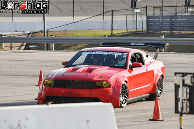

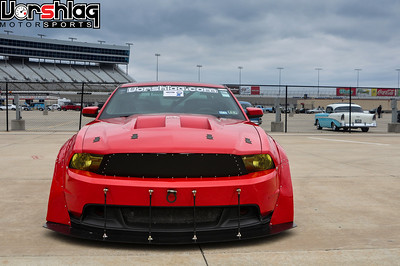

Project Update for March 20, 2014: As usual this started out as a "quick update" but grew into a monster, and it only covers two weeks worth of events and car prep. We had a great time with NASA at Motorsports Ranch Cresson March 7-9th, so I'll go over that race weekend. Then I'll discuss the last nagging problems we're having with the car, which slowed down the lap times once again (AdvanceTrac faults!). We stripped all of the graphics off the red Mustang in preparation for Goodguys and USCA events as well as installed a set of BFG Rivals. We also got a chance to install the new BMR "UTCA033" spherical Upper Control Arm for the 2010-14 Mustang as well as a new set of Cobra seats (Monoco) in one of our Tester's GTs. Then we get ready for USCA this weekend.... let's go!
NASA @ MSR-C, March 7-9th, 2014
In my last update we went over the modifications and rear flares that were involved to the rear fenders to clear the big 345/35/18 Hoosiers back there (see below). The front flares we made last August were always intended to clear the 335/30/18 up front, and this was the first event where we got a chance to run this new tire upgrade.
Mmmm..... big flares.... big tires.... NASA @ MSR means it was time to finally use these in anger!
We drove at MSR track in January with SCCA Club Trials to a 1:18.675 on used 315mm A6 tires, so I was hoping for a 1-2 second time drop with a sticker set of the wider Hoosiers on the same 1.7 mile course... if we even ran the 1.7 course. You see the NASA Texas Time Trial group is normally too big to fit on the 1.7 so we normally use the longer 3.1 mile course - and have done so for the past three years (2011-13). We've had as many as 47 cars enter into TT group at our events, but this time we only had 26 signed up about 4 days before the event, so Dave B made the call, "TT will be running the 1.7". The cut-off for minimum TT entries to run the 3.1 was 32 cars, and we just didn't make it in time (but we did by the end of the race weekend!)

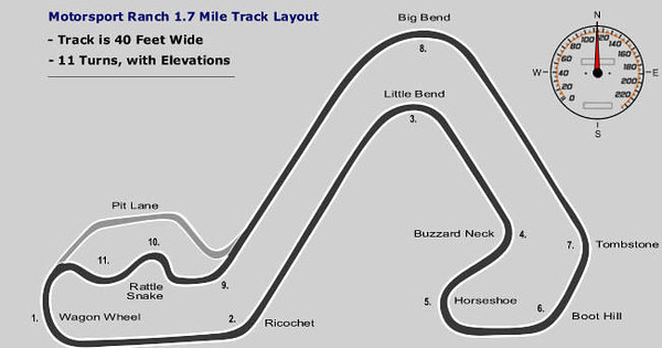

The 1.7 mile course everyone ran at the NASA event Jan 8-9th
The main thing I lacked at the Club Trials event in January was simple, SEAT TIME. I almost never run the 1.7 mile course at MSR, and have a lot more seat time on the (seldom used) 1.3 and 3.1 courses. I only drove the Mustang at speed for two sessions on the 1.7 mile course in January and put my best laps in early, in the 2nd session. Amy co-drove with me that day and drove in the last two sessions of the day, when it was warmer (it was very COLD at the start of that event, in the 29-35°F range). Well for this weekend Amy was at a wedding for a cousin out of state, so I was going to get to run the car as much as I wanted. Instead of learning the new tire set-up (and this track) during the four daily TT sessions on Saturday and Sunday I decided to head out to MSR on Friday afternoon to get some laps in at the "Test-N-Tune" event normally held the day before any NASA Texas event.

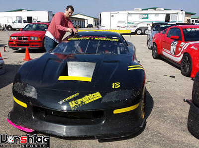

One of our testers Jamie Beck was there with his AST/Vorshlag/Whiteline/Cobra equipped 2013 Mustang GTs (above) to run in HPDE3 on Saturday and he was nice enough to snap these pictures of me driving - the only pictures I got all weekend of our car (I shot pics of TT cars in sessions that I wasn't driving on Sat/Sunday). We had just rebuilt his rear axle (diff bearings were shot, swapped in a new Torson and 3.31 gears from 3.73s - he loves it) and had some new gauges, a shift light, Ford Racing Sparco wheel and some "blip shift" device he was testing in HPDE3. He also borrowed my "loaner" AiM SOLO timer, which came in handy. So I went out Friday on the 335F/345R scrub set I had picked up for this car and was going to do just a couple of shake down laps, but once I got up to speed and scrubbed off the old rubber the car was flying around the track and I was having a blast.
I came in after 10-15 laps and hopped out under the "Tech shed" area to take a quick look and make sure nothing was leaking or rubbing. Well don't you know that the underside of the back of the car was dripping in gear oil. WTF?! I took a peek and thought I saw the problem... drove to the paddock spot, shimmied out of my driving suit, got the back of the car in the air and yep, the differential vent line for the vent/catch can system we built long ago had popped off the fitting on the rear axle. That was an easy fix. I cleaned up most of the leaked fluid, which looked like much less than a pint, and got back out on track.

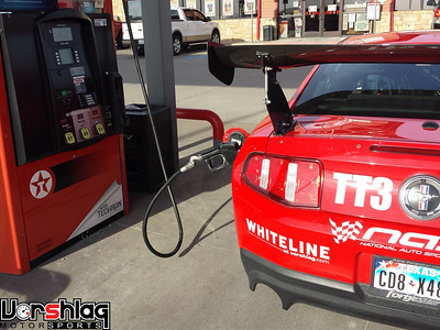

Arrived at the track Saturday morning at 7:30 am, stopped at the gas station in front of the track to get ice for the cooler. Noticed the line into the track was 30+ deep so I went ahead and ordered a bacon and egg breakfast burrito from On The Brazos BBQ next to the gas station. Best breakfast burrito I've ever had in my LIFE! This thing was HUGE, and chowing on that $3.50 burrito made the wait for the front gate go by quickly. Once signed, wrist banded and inside the gate to my paddock spot. Costas had arrived at some unholy hour and was already unloaded. Our single-trailer width paddock spot grew to three trailers stuffed in there with Costas' 28' and Jamie's 24' trailers jammed in front of our 36'. Their cars plus the Mustang, Toth's Audi and Cody's E36 M3 were all parked together next to Glen's CMC Camaro over the rest of the weekend, too.
After I got inside the gates I raced over to PST to buy a freakin tire gauge (it wasn't loaded in the trailer), and they had my two front sticker tires mounted and balanced by 7:45 am - they rock. Thanks AJ! Ran back to my paddock spot, mounted the front wheels with sticker A6 tires, checked all the fluids and put a tiny bit of oil in it.
Which is all I normally need to do to this car - just keep it full of fluids and drive it. This Mustang is a TANK, I tell ya. Bled tire new tires' pressures down to where I thought they needed to be in the 36° temperatures we saw in the first TT practice session - 29psi front, 27 psi rear, shooting for 33F/31R hot (it overshot that goal by a good bit, as each tire grew by 6-8 psi). First session for TT was of course early and cold, so the track was very slick.

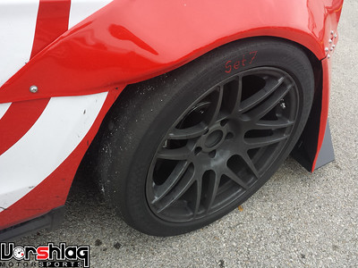

As I was installing the front wheels I was farting around with the front spacers - something just didn't look right and had the front wheels on and off a couple of times, getting the wheels to fit right. I was confused and knew something on the car needed to be changed with respect to the spacers when I ran the different set of wheels (one pair of 12's has very different offsets from the later set of 18x12s). We had a quick TT meeting in at 8 am, and I was very rushed all morning. I then got the car to grid but something was nagging me.. ballast! I drove back to my paddock spot and looked for the 35 pound plates, but they were still at the shop. I had like 2 minutes to spare so I grabbed a 25 pound plate and hoped that would be enough. Bolted it on and drove back to grid. I ended up getting there as the one minute warning whistle blew. Crap! Go go go!
I am belted in and look over to the passenger seat and see... the harness belts on the passenger seat were unlatched and the seat cushions were sitting on the floor - all of which which would fly around and be a huge distraction on track. I had to get out of my harness, get out of the car, go around to the other side and secure the belts and cushions. Long story short - I didn't make it out in the first grid spot as planned for the first session and had to rush out and catch the field once I had all of my crap together. Not having Amy or anyone else from the shop with me this weekend was a constant struggle to make it to grid on time and get the car checked over between runs. I had some help from Jason Toth and Paul Costas but they had their own cars (and students) to attend to.

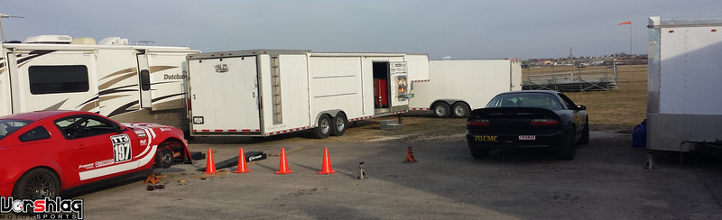

Went out dead last in TT, about a minute after they had left, so I blasted out of the grid and caught the back of the field on the formation lap then scrubbed the sticker tires a bit. Costas snuck out there in his GT-1 car late as well, but held back and left a half lap gap to me, so he had all sorts of clear track on his first couple of laps. Smart! I caught a ton of traffic on every lap, of course, but everyone was cool and I was passing 3-4 cars per lap. Worked my way up through the field and took five laps, which is a lot for this car in TT (normally overheating the tires by then).

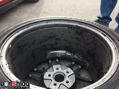

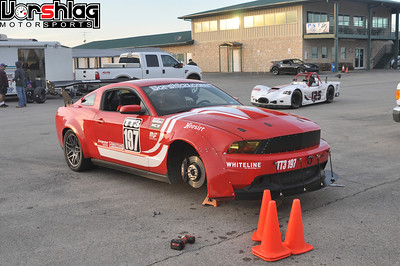

I can smell and hear a tire rubbing and smoking, and eventually I figured out that the right rear is rubbing inboard badly. Then I finally remembered which spacer I was supposed to change - the rears! I really needed to get a sub 1:20 lap so I took a few more laps even though I saw and heard the tire rub. Needed a fast lap to get up the grid for TT session 2, so I wouldn't be mired in traffic and slow all day. That was probably a mistake, as when I finally did come in I had damaged the tire a bit more than I figured.
Did manage a 1:20.4, which was 4th fastest and moved me up the grid. Way better than I thought I'd get with that much traffic and these cold temps, so I guess it helped after all. We ended up having 29 cars for the day after 28 signed up, some didn't show, and then we had several new drivers get check rides from HPDE 4 and move up to TT. I came in, pulled the rear wheels and put the correct spacers on back there. Checked the tire, despite the rub, it was still OK and had not cut all the way through the outer rubber and into the carcass. Made quite a big "tire baby" out of the shaved rubber from the right rear. Oops.

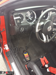

Left: Piles of tire shavings... Center: ...make a nice beard! Right: The SCT tool was used to check and clear CEL codes

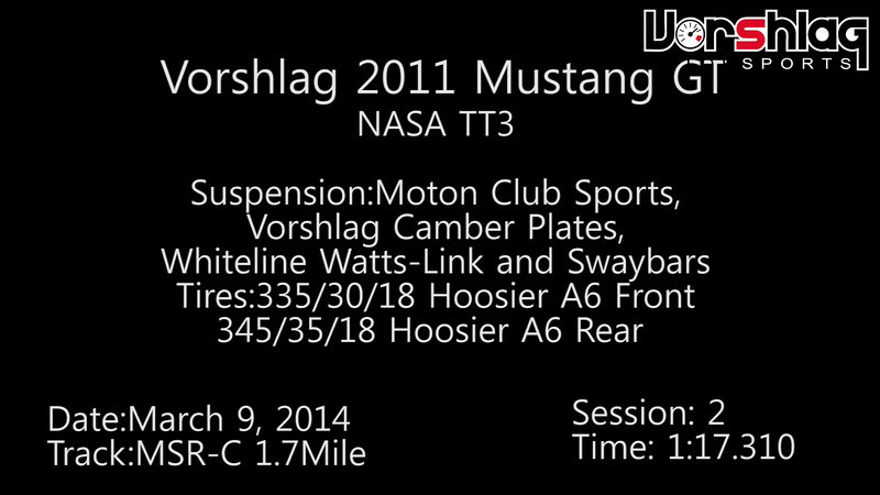

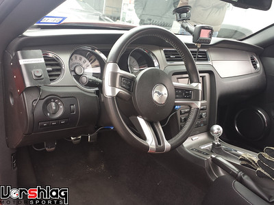

Left: The new AiM SOLO DL unit has CAN and OBD2 data reading capabilities. Right: Crazy barn fire right next to MSR
That 1:17.7 lap ended up being the fastest time of TT session 2, so I was in unfamiliar territory gridded in P1 for TT session 3. We took a lunch break after session 2 and I worked with Costas a bit on his GT-1 car (which ran in all four Super Unlimited races of the weekend and even ran in TT both days). Compared to MSR-Houston his GT-1 Camaro ran extremely reliably all weekend and it wasn't until 1:30 pm Sunday that he had to break out any tools to work on it.

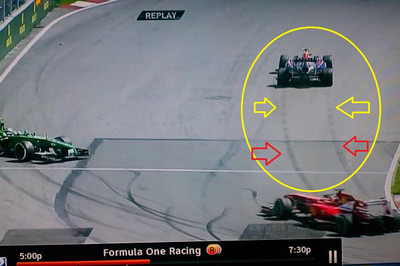

Hidden traction control systems in F1 may have led to KERS fires on the Redbull RB9
There was a big stink in F1 last year when some folks accused other F1 teams of sneaking traction control features into their KERS (Kinetic Energy Recovery System) systems, and it was evident that one car seemed to accelerate out of corners unlike any other (Seb's RB9) and former team-owner Giancarlo Minardi had a strong case for why there was a hidden TC system on this F1 car. Some cruder/simpler cheater TC systems look for rate of change of engine RPM, and include a soft cut in the ignition to reduce engine speed acceleration and hence wheelspin. Those aren't actively monitoring wheel speed sensors but they still can be effective, and are also banned in series that don't allow TC.

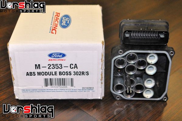

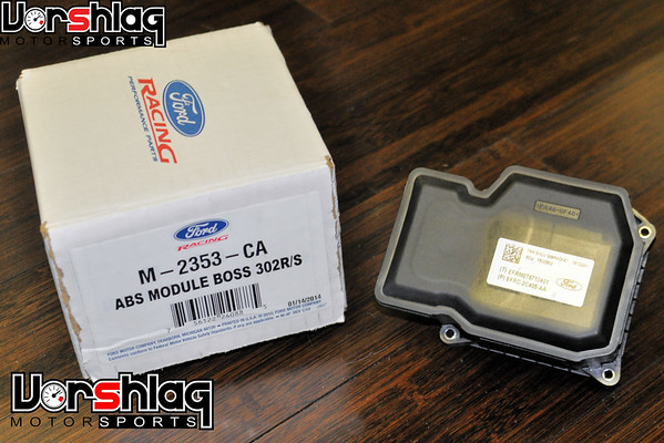

The new Ford Racing module turns off all traction control and stability control modes but also tweaks the ABS settings, supposedly setting a higher threshold for the anti-lock modulation when equipped with race tires and race brake pads. I will report back on the new settings but Rehagen Racing reports really good things about this -CA module in their Pro racing uses, so that's a very good sign.
The "M-2353-CA" module (shown above) is the Ford Racing ABS/TC unit we will be testing at USCA this weekend and at TWS at the end of this month on our Time Trial car. Yes, I realize this this -CA unit is not made for street driven cars and it will "make the dash light-up like a Christmas tree" but it already does that now with CELs and AdvanceTrac failures, ha!
This car has seen these AdvanceTrac faults with street tires, the 315/30/18 Hosiers at all four corners and is just as bad with the 335/30/18 front and 345/35/18 rear Hoosiers (which have very different tire heights). The car cannot make a single hard lap now without faulting the TC system and/or going into limp mode, so we have to take drastic measures. Even with the system turned all the way off the TC is turning itself back ON midway through my lap, and flashing all sorts of warnings on the display.
I think with the extra grip of these tires + aero we are running it is just too far outside of the factory parameters? I am not faulting Ford for this - we've taken a simple street driven Mustang farther than they'd probably intended. I also don't want to encourage people with street/track Mustangs to think they need to ditch the OEM ABS/TC modules - this Ford Racing module is an upgrade made for race cars with big, grippy race tires. If you are reading this and are not sure if you need this ABS/TC module, then I've been told that you don't. If you are racing a 2005-up Mustang with the OEM ABS/TC system in place and are seeing all sorts of faults and problems when racing, you'll know.

I also wanted to note that as badly as the Traction Control system has behaved it has mostly only happened to me and Costas when driving this car - Amy is a much smoother driver and it never faults on her.
We will test this new ABS/Traction Control module at the USCA event this weekend (on street tires) and at the Track Guys TWS track event the weekend after (on sticky tires) and I will report back with results after autocrossing and tracking this new M-2353-CA module with those vastly different grip levels.

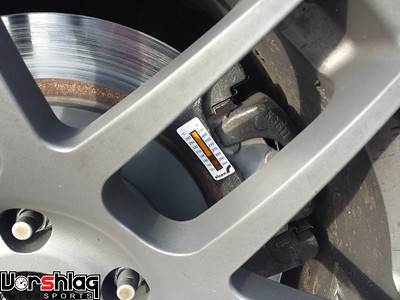

Indicated 470°F front and 350°F rear brake caliper temperatures were a bit alarming

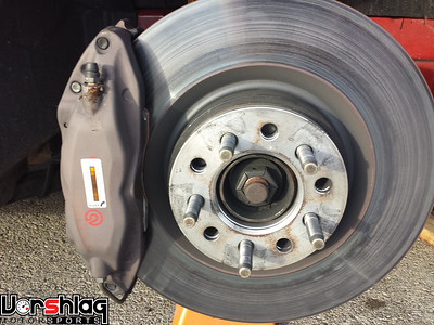

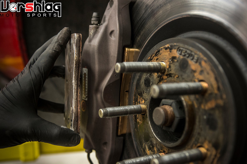

The brakes worked well this weekend but I got them REALLY hot, as shown in the Alcon caliper temperature indicators that we placed on each caliper. This is a standard data acquisition trick, but I learned the value of it from Costas in January at the NASA MSR-H event. So I picked up a packet of these adhesive strips and the results were a bit startling. The 470°F degree front caliper temps were the most alarming and we will need to address this before our next high speed track event. Again, we were running with driver and ballast at over 3800 pounds (much higher than most S197 racers) and seeing speeds and lap times that are probably atypical for this chassis.
Like many S197 racers we are using a single a 3" brake duct hose coming from the fog light openings right now but we had just re-routed and lengthened these hoses to avoid the 335mm wide front tires at full lock (see new routing, above). I fear that the new cooling hose routing (now located inboard of the splitter's rear mounts) with tighter bends in the hose is causing some additional airflow restriction we weren't seeing before. The rear calipers even saw over 350°F, which was a tick higher than expected. We will replace these Alcon indicators for each event and monitor the max temps reached on each caliper and possibly add a second 3" hose (or move to a 4" hose) up front and maybe even add some under-car ducting for the rear brakes. I have an idea for that which will tie into the new rear bodywork nicely and discretely.
We've run multiple brake cooling hoses to the same corner on other cars we've built before, like this C4 Corvette above. That one used a massive inlet duct, air passed through the frame rail then was diverted out into two duct hoses: a 3" hose routed to a custom brake backing plate for the inside of the rotor and a second 2" cooling hose pointed right at the caliper. This system worked very well and in that car's first 12 hour of racing the pads barely wore halfway, but the rear brakes (uncooled) went through two sets of pads. We might try this "dual cooling" set-up on front of the TT3 Mustang, or a single 4" hose to the rotor, or a dual 3" hose to the rotor. And a ducted rear rotor set-up is coming as well.
The front brake pads are wearing more quickly than we like (again, 3800 pound car + lots of brake heat), as shown above. We just put a new set of front Carbotech XP20 brake pads on the front Brembo calipers for the USCA event and will address the brake cooling needs soon. The old pads (shown) wore down tot he last 1/16th of an inch of material and are only good for "emergency use", to make one session or a drive home from the track for someone that had a pad failure.
In Sunday's TT session 3, the car didn't even make through the first hot lap before the AdvanceTrac faulted heavily. I barely ran a 1:18 lap and it was only getting worse, as was the traffic. I didn't even try to make a 2nd hot lap, and with the start/finish line just before the pit entrance road I just dove into the pits and did a little cool down drive to the corner gas station and back, to get the brakes and systems cooled off before parking the car for rest of the day. The ambient temperatures were getting warmer and a few guys went quicker, so I ended up only 4th fastest in TT for the day after skipping the 4th TT session. If the AdvanceTrac wasn't faulting I would have gone out and could have dropped time. After the car had cooled off I hooked up the truck to the trailer, loaded up the car and our gear, then helped Costas put his car back together (windshield, bodywork, and wheels) after he fixed a nagging brake light switch issue that was a bear to access. Once he was ready for his last SU race, where he won the class all 4 times, I headed out a little early.
That 2nd session 1:17.310 time was good enough for the win (7 cars in class) and reset the TT3 record. A Radical SR8 ran with us in TT on Sunday and was stupid fast, but its a SportsRacer and that's to be expected. Troy Messer found a lot of time in his TT1 Corvette in the 4th session and ran a 1:15.8 and Vorshlag customer Corey Wells put in a fast lap with a 1:17.290 in his TT1 classed ZR1 (street car!) as well.
All in all this was a great weekend and the Vorshlag Mustang really came alive on the bigger Hoosiers I have lusted after for the last three years. Just as I predicted, it dropped a lot of time AND I was able to get in 3, 4, even 5 hot laps before the tires got overheated and greasy - unheard of when running at this weight on the 315mm A6 tires. The extra grip probably caused these additional AdvanceTrac faults and one CEL issue, so we're installing a new ABS/TC module that hopefully eliminates all traces of factory traction control once and for all. Again, I really missed having Amy and our crew there, and the only pictures I got were with my Nikon that I took, and the only shots of our car on track were those that Jamie Beck shot with my camera on Friday in practice. I watched all the video and saw plenty of driving mistakes so there's no telling what this car could have run without the AdvanceTrac faults and my hack driving. I know a 1:16 was possible without the brakes being applied by some stupid computer when I wanted to be WOT. Maybe next year NASA will run the MSR 1.7 course again. I sure hope so, as this course was more enjoyable for me than the 3.1 mile course we normally run in TT.

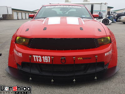

Making Weight by the Hair of My Chinny Chin Chin!
One little scare I had on Saturday was after TT session 2. I came after running that 1:17.7 lap and was sent to the scales. I wasn't too worried, as I had thrown a 25 pound ballast weight plate into the trunk mount moments before the session began, after I noticed a somewhat lower fuel load than I had wanted (normally I was going to grid with 7/8ths to a full tank). I made weight that time by 2 pounds!!!! And that took two tries...

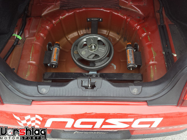

The first time they put the car on the scales after that session it was 8 pounds light. As per the rules, that would have been technically legal on my first weighing of the day (10 pound grace on first weighing) but I knew that weight couldn't be right. I asked them to roll me off, make sure the scale pads were under all 4 tires all the way, and we rolled it back on. That time it was 3804 pounds on a 3802 minimum. Whew!
I went to the paddock and immediately threw 20 more pounds of ballast and a full tank of fuel went into the car for each successive session all weekend. I was weighed a couple more times; once it was 3835 and another it was 3853 pounds! So getting spooked by that "close call" 2 pound weight check made me run too much ballast all weekend. I'm sure with our crew here I wouldn't have overshot that so badly, but oh well. It was fully 51 pounds overweight on my 1:17.310 lap Sunday.

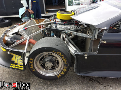

Jason Toth (the Alpha LS1 Miata owner) made his TT debut on Sunday in an Audi A4 (loaner, shown above left) and had a blast. He borrowed my spare AMB so he graciously ran in TT3, which made for 7 in class. Hoosier pays all the way down to 2nd place so Jeff Tan won a tire that day in 2nd and I won 2 more in 1st. Which was good, because I blew my tire budget all to pieces with the new A6s for this event and BFG Rivals for Goodguys/USCA. I'll save the newly arrived 4 tire winnings for April's NASA TT event and use 3 of these 4 tires from this weekend as my Friday test set if we go down there a day early. Gotta get a replacement 18x12" wheel so we have two complete sets - running around and getting tires swapped and mounted minutes before my first TT session Saturday was a bit too hectic. Congrats to Mike Patterson (shown above right), who won all 4 AI races, reset the track record for that class in the low 1:20 range (on the new Toyo RR tires running 18x9.5" Forgestar F14 wheels he bought from Vorshlag), and ran in TT3 both days as well. He also works as race director for another race group, so he was a busy man!

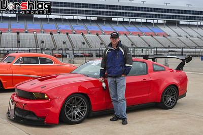

Decal Removal + New BFG Rivals + Prep for Goodguys & USCA
We had to steal a tiny sliver of shop time to get the red Mustang ready for the next two "street car" events, so we took it. The guys made sure the car was street legal and re-attached the horns and double checked all of the street car systems like the wipers, lights, signals and the rest. We ran out of time to get the car reinspected (it was a few months out but it just got re-inspected today) but they got it all street worthy and up to snuff. On Thursday March 13th the set of BFG Rivals I found a couple of weeks earlier (TireRack was out of stock on the 335s) arrived in town and I went out to an undisclosed location to pick them up.
On the Friday before Goodguys Olof got the 315/30/18 pair mounted to the front 18x12 wheels and the 335/30/18 pair mounted to the rear 18x12s. Once mounted on the car they were swallowed in the massive rear flares and even the 335s looked small.
continued below
Vorshlag-Fair
Official Site Vendor
Nov 12, 2010
1,592
116
Dallas, TX
continued from above

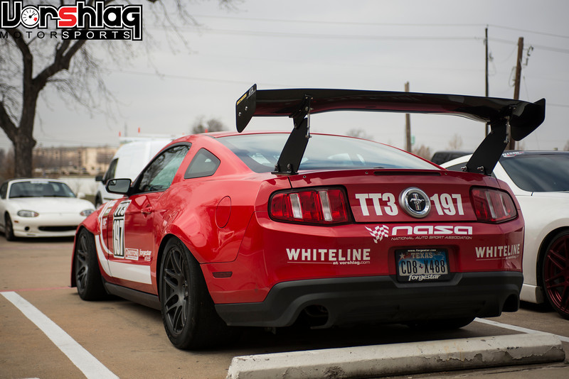

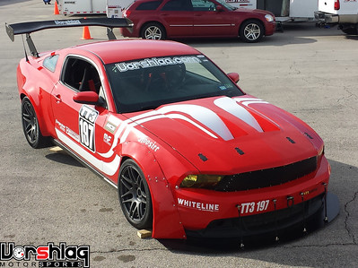

Another change we made was to remove the current "livery", which we've had on the car since 2012. The crazy stripes were Amy's idea, and the vendor decals were there to show what we have on the car that we sell. Some of the parts shown in decals are about to be removed (more on that in my next post) and almost all of the vendors we use aren't "Goodguys/USCA" sponsors, so they had to get toned down a bit.
Street Car, Race Car - What's The Definition? Who cares?
The number board, NASA decals and race numbers/class letters make this streetable car look more like a race car than it really is, and I didn't want to put the wrong impression for Goodguys or USCA - because this really is a very streetable car that we often drive around town for various events, unlike some cars that show up at those street car competitions. We have had a few folks complain publicly about how our Mustang is a "race car" showing up and beating "street cars" at NASA events, Goodguys, and other competitions, but I just chalk that up to internet whining. It is even funnier when folks with "street cars" that have gutted interiors, no radio or air con, built or boosted motors and/or wildly illegal emissions systems make these claims about our 2011 Mustang. This really is a full interior car (back seats are reinstalled as of last week), with the OEM air bags, big honkin' radio, touch screen sat NAV, a satellite radio subscription, air conditioning, power windows, all of the OEM glass, OEM seat belts, and a bone stock engine from throttle body to exhaust port. The suspension is refined for competition, but it's still quiet and uses bushings in most of the arms and links.
A ducted hood, splitter and big wing don't make a car a "race car" or really much less streetable than other cars - but these are visible exterior mods that look "racey" and some that don't understand the function of them would even say "ricey". And at the events we race in, this Mustang is usually the heaviest car at the entire event (3802 pounds) and almost always competing against much more radically prepped cars. Is it my fault if someone shows up to NASA TT in a bone stock car and gets beat? Should they expect to win in a totally stock vehicle? Sometimes a fairly stock-ish car can do well in NASA Time Trial, but most of the time these entrants are making significant modifications to otherwise OEM vehicles to be more competitive. When there are contingencies on the line (like free sets of tires for the winners) you better believe I'm going to look at the rules and do what I feel is most beneficial to lowering our lap times. At the 2013 NASA Nationals our car was one of the only ones on the TTU-TT1/2/3 grid that was a registered and inspected street car, and once again the heaviest car on grid.
Just know that everyone has their own definition of a "street car", and your's might not sync up with mine. You should see some of the street cars race in Hot Rod's Speed Week! The 80 mile road rally we have to drive on public roads this Friday at the USCA event will separate the street cars from the race cars, and I'm confident that I will have no problems on that drive. In fact I'll probably have the A/C on and playing Channel 51 on Sirius blasting through the 1000 watt stereo, burning 93 octane pump fuel and having fun.

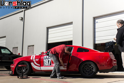

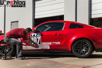

Back to the decal removal. So we left the car out in the sun for a couple of hours to help soften the adhesives, then I started to yanked off the stripes and most of the decals myself. Kyle finished removing the decals and then washed the car. After that I removed the adhesive residue with the Goof Off Heavy Duty spray remover I like (not the Goof Off Industrial Strength, which can sometimes affect the paint - the "heavy duty" version is much safer). Finally, Ryan used his detailing skills and tools to buff and wax the paint. HE wasn't around when Brandon took this picture below, so I stood in for him and pretended to do real work, heh.
Some of those decals have been on there for about 2 years but luckily we use good vinyl and they came off well. Nothing was brittle and tore except for a few printed decals that came from vendors or race events. One of those left a HUGE glob of adhesive that took a bit of elbow grease to get off, but it all cleaned up well. Some of these stripes and decals went onto VERY fresh paint (due to time constraints) but Shiloh's paint work held up perfectly. Once it was all buffed and waxed it came out nice.
There's the old livery at left and the new "naked" look at right. We had planned on doing some simple black stripes and a few vendor decals but the weather started to turn and we ran out of time. That's going to happen soon, so it won't stay "naked" long. Yes yes, it looks better with a simple red paint job, but this car is a marketing tool for us and it has to show the parts on it that we sell, so they have to go back on at some point.

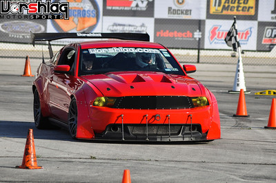

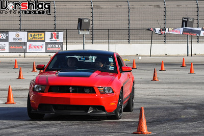

Ya see, back in October I didn't take the Goodguys autocross that seriously because I didn't realize they had such good prizes for the winner. I lost that event by two hundredths and only after the event was over did I realize that there was a free set of BFGoodrich tires on the line. So for this March 2014 Goodguys I came better prepared, with a fresh set of BFGoodrich Rivals and more serious driving attitude. :)
We luckily knew the entire "Goodguys event" drill this time. Since we weren't allowed to bring our truck and trailer inside the Speedway on Sunday we got to the race hotel at 7:20 am to register (for the Sunday autocross event you have to sign up the day of, or become a Goodguys member and sign up about 3 weeks in advance), got to the TMS assigned trailer parking area outside the Speedway, and quickly unloaded the car from the trailer. Yes, it was on street tires and we still trailered the car, but mostly because we are trying to keep these BFG Rivals FRESH and avoid unnecessary heat cycles on them. The more times you drive on any set of tires - where they start out cold and then get hot and then cool off again - the more heat cycles they take. Heat cycles can "age out" a set of competitive tires before the tread is gone, even these Rivals. And at $1300 a set I'm going to SAVE THESE TIRES. Not to mention that Texas Motor Speedway is also about an hour away from our shop, and we had no spare tire.
The weather started out in the low 50s when we left the house, but a cold front had swept in the day before (and brought MASSIVE winds and rain that night), and temps were dropping into the lower 40s and the wind was BRUTAL. The winds was blowing so hard that everything was flying out of the trailer - pieces of wood (which we use with the trailer ramps), papers, and anything not bolted down. This did not bode well for the rest of the day. We bundled up in several coats, tossed our helmets (didn't need em!) plus an air gauge in the trunk, and we drove to the Speedway entrance. Once we got inside to the area where the autocross is held we got in line and I went to walk the course.
I realized quickly that this was the same course we ran in October. Exactly the same, really, but one of the Pro drivers (the Fri-day-Saturday group is broken up into groups and the shops and drivers that go to most of the Goodguys events and do well get assigned into the "Pro" category) said it was different by a couple of feet here and there. Regardless, having run this strange layout in October was a big help, since I knew I wouldn't get lost this time like so many did at that event. I walked it one time and got back into the Mustang to stay warm!
When the event finally got underway around 8 :30 am the Pro class drivers went first, which they are allowed to do. They park by the announcer and put on a good show for the crowd, but they aren't competing in that day's events. Many of the 1972-older domestics that ran Friday-Saturday also take runs throughout the Sunday, but they also aren't in competition - just making fun runs. A little frustrating for those of us that are competing in the All American Sunday (1973-newer) event, but they paid their money and they get their runs. It makes the day more interesting, as just late models autocrossing can be boring for this crowd of spectators - which was a surprisingly full crowd all day, considering the weather.
I had one of my student's from Sunday's SCCA Solo School where Amy and I instructed who was at this event, Lloyd in the red Boss302. His son was with him and he wanted to get a ride in our car, so I took a rider on my first run - and only on this run. Last October I took riders on all of my Goodguys runs, but when you lose by .02 seconds you begin to get paranoid. I knew this first run would suck, and it did. The BFG's still had visible decals and mold release and it felt like driving on ice. He had fun and I got that awful run out of the way. You can see in these pictures that we were wearing helmets, which I'm so used to doing, but nobody else was because it isn't required at Goodguys.
And while the course ran very near fences and concrete barriers it doesn't seem to phase anyone at these events, so I just went with the flow and drove my laps. My first lap was a 77 second run, which was terrible... but after the first round of runs it was in 1st place somehow. Then I made a second run of a 74.4 second run, which was painfully slow and I had wheelspin everywhere, and now I was 4 seconds in the lead. Huh?
The lines were heavy and growing all day and it was taking about an hour between runs, but I was used to this from the October event. By the time I got to the line for my third run it was around 11 am, and they said they'd pick the fastest time run by 11:30 and call them the winner. I pulled up to stage and the guy is plastering decals on the car for "Autocross Winner", and I hadn't even made my last run. "Nobody is close" he said, and then I was told to report to the timing tent after my last run, shown below.
That run felt a little better, and I made all of my 1st gear downshifts shifts smoothly. The wheelspin was more controlled than my other two runs but there was still VERY little grip on this still wet asphalt in these crazy cold conditions. The BFG Rivals apparently don't do as well as the Falkens in cold temps, and Brian Hobaugh was stupid fast on Falkens in his gorgeous orange 2nd gen Camaro, running several seconds quicker that day than me. But he and the rest of the Pro class drivers were in the 1972-older series and luckily their runs didn't get compared or counted with ours'. Next weekend at USCA those cars are in the same class as me, so I am hoping with warmer temps and better driving I can get closer.
AAS...Terry Fair............2011 Ford Mustang............74.124
AAS...Bryan Mills...........1994 Ford Mustang............76.059
AAS...Lloyd Collins.........2012 Ford Mustang............76.684
AAS...Greg Scherer........2002 Pontiac Firehawk........77.788
I copied the first 4 results from the 23 entered in the "AAS" class and it turns out there were two driver's that improved a lot on their last runs and got within 2 seconds of my final time, including my student from the Solo school the day before (nice driving, Lloyd!). Didn't know until the results were posted earlier today.
