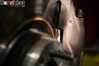

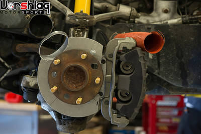

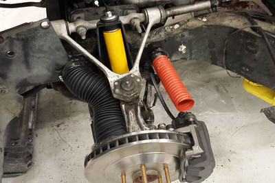

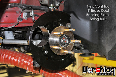

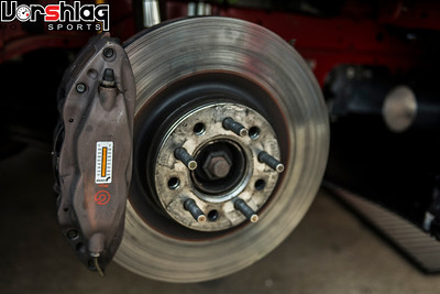

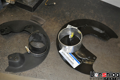

We were seeing 490°F at the front calipers before, with 3" ducting and Carbotech XP20 pads...
Now its down to 430°F with the same pads and 4" ducting... when we make the backing plate opening 4" it should get even more airflow and possibly go lower. I hope.

Where do you get those temp strips from? Those things are trick!
Unfortunately there isn't a good source for these Alcon temp strips at the moment. We tried to set-up a dealership with one of their distributors but they jerked us around so much we'll never buy anything form them again - they charged $14 to ship one packet of these strips, which weighs less than 2 ounces! And the price went up 25% overnight. And we had ordered 3 kits, not 1, and it took 4 weeks to get them - and they had them in stock the whole time. I'm not naming names but this place absolutely SUCKS. We're trying to go direct with Alcon.
I'll post up when I have a good inventory here at Vorshlag.
Thank you for taking the time to respond Terry but I am actually looking for Rotor Temps. If you have those and would share, I would appreciate it.
As for rotor temps, we haven't checked that and it likely would be too hot to have these Alcon temp strips adhere to... I've checked rotor temps with an IR gun on various cars and have seen 400-800°F numbers - they get HOT.
But it almost doesn't matter what the rotor temps are, as they are cast iron and good up to around 3000 degrees before they melt, heh. The temps that really DO matter include:
  • Brake Fluid - hydraulic fluid boils at known temperatures and this level must be avoided
  • Hubs - the grease in the hubs can melt and cause premature failure
  • Brake pads - various pad compounds have a range of temps that work in
Since it is hard to check brake fluid temp directly we stick these strips on the brake calipers near the pistons... which is as close as we can get to the fluid. Ditto on on the brake pads - they get SO hot that nothing will stick to them. They get about as hot as the rotors, and you can use an IR gun for that, with a driver coming in after a hot lap (no cool down) and someone in the hot pits gunning the rotor face.
Don't try to over-think this stuff guys. Just make sure to blow the brake cooling air inside the rotor ring itself, which allows the air to pump through the vented ring inboard to out, which keeps the rotor cool... which then keeps the pads and fluid cool. Since the heat from the rotor passes through the pads and pistons to the fluid. The cooling air also cools the hubs, which is a wear item on these cars, if you aim it correctly.
Again, knowing the exact rotor temperate could be nice from a metallurgical point of view, but the critical items are those shown above.
Thanks Terry - I paint the rotor for temp to match pads for different tracks. Newer pad designs make this redundant but it’s a habit for me. Haven't had enough time in my current vehicle - me driving - and it’s been years since I’ve had time to play until just recently. I’m going to drive my wife’s Mustang though the end of the year to get my legs back – Then either up-grade the engine or buy another vehicle. I’m stile having drive line issues – Pulling the trans & swapping it out for a stock one next weekend to see if my modified tail assembly is causing part of the problem. Just no-where to test and I don’t like testing on the street.
Alcon or AP Racing are the most commonly used Tape strips – A couple of others I have not tried. I try to stick with one manufacturer for comparison – Alcon but I’m almost out. I’ve used both though. There are many types of paint from different manufactures. I Paint 1/4 of my Rotor ends and a stripe across the hat.
A lazar pyrometer isn’t fast enough for me – Things like brakes & rotors cool too quickly.
Thanks again for the info.

Terry, you mentioned that temperature of the rotor really isn't a concern because the melting temp is around 3000 degrees.
What about yield temperatures of the rotor? Isn't excessive heat and force what causes rotor warping?

Rotor warping is often caused by the pads leaving uneven deposits on the rotor, which can happen when the rotor gets hot enough to "melt" the pad.

I've hit the rotors with an IR gun a few times and it's been 800+. But, that's usually after a cool down lap. Based on our pad use I'd make a SWAG that we are seeing 1100+ degrees on a regular basis.
To get an accurate temp you need to paint the edge of the rotor with temp sensitive paints.

I'm not a fan of IR guns. We had a middle of the road one that was like $300 and it was crap compared to a $50 thermocouple.
Yes, that was a little tongue in cheek. ;)
Actually - I have a Fluke – The only company I trust unless you want to spent $1000.00+
I don’t know the part number off the top of my head but it is within +/- (2.5) Degrees from 150F to 1500F verified by 3 different Very Expensive sensors. I paid around $300.00 +/- & deducted it off my taxes :roflmao: so out of pocket was prox. $200.00 OHHH I do like our tax laws.

Terry any thought to using multiple hoses, and also brake fans inline. Extreme for a street car but two h3" hoses could be mounted in a modified 2010-2012 CS/Boss fascia trim. One for the hub and one for the caliper. Also have you guys considered cooling the master cylinder and reservoir with a hose? It gets hot, not as hot as the caliper fluid but if there is positive heat transfer, maybe negative heat transfer can occur and help. Love the fabrication work you guys do at the Vorschlag shop.
Steve

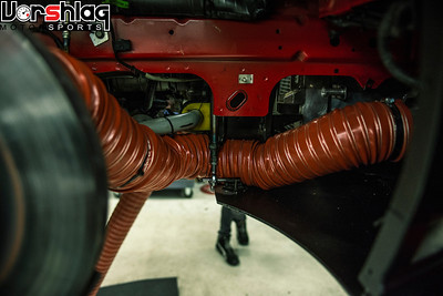

Yea, we looked at dual 3" or a single 4" front brake hoses... but the space under the front of the car is pretty tight with those big 335mm tires swinging around in there, so we made the 4" hose fit and opened up the fog light opening to match. It seemed to knock front temps down by 60 degrees at our last ECR track test.
The double brake ducting idea for cooling the rotor and caliper independently is a good one, and we've used that on customer's Endurance cars. But our TT3 Mustang rarely sees more than 2-3 hot laps in a row... this incident at Road Atlanta happened after two longer stints (12+ hot laps in a row), with much higher speeds than we normally see (155+), on really thin brake pads (mistake), with the wrong fluid for the weight/speed of this car (mistake), and it all just added up to the big off. :yuck:

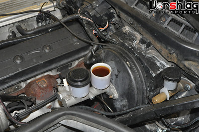

Cooling the master cylinder is an interesting idea... might have to check the fluid temps up there.

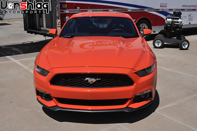

Ordered a 2015 Mustang GT - April 21, 2014
I ordered a 2015 Mustang GT in late April. I ran over to Five Star Ford of Plano and met with Corey White on April 21st to pick the options on our 2015 5.0L 6-speed Performance Pack GT, to get first in line at this dealership... before they even knew prices on anything. "Real" ordering started on May 20th, but they had options listed as of that April day, without prices or many stats, so we made some educated guesses and got our order staged in line FIRST! As you can see from the screen shot, there are some extra options we added to the Performance Pack, which include: leather Recaros, touch screen NAV, and the 401A interior package/equipment group.
There's one reason why we got the car a little more loaded than you'd think for a "Race Car" - resale value. As long as it took to sell the base model 2013 GT we picked up, and in case the rumored GT350 voodoo engined car comes out within the next 12 months, we want to keep this 2015 as sell-able as possible. We have no idea when we'll see this 2015 GT - it could be late July to as late as the end of August. I will post up here the MOMENT it arrives, and quickly start a new S550 build thread. Our initial development plans include wheel and tire fitment, immediate camber plate development, weighing and track testing. We want to test it against a stock 2012-13 Boss 302 at a local road course (ECR) within days of arrival.

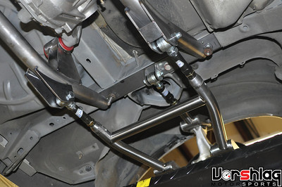

The rear uprights was the last project Ryan Begham worked on - sad to see him leave us but we wish him the best of luck in school!

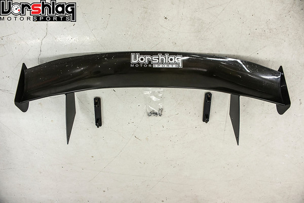

Once we had the new AJ Hartman wing installed the next big test for the 2011 Mustang was NASA at Texas World Speedway at the end of April. Since Amy and I both knew this track fairly well we didn't go ahead and sign up for the Friday Test-N-Tune event. With a competitive car that has recent changes you would normally do that, but NASA Texas had an 8 hour enduro event scheduled for 2-10 pm on Friday, so we would have had to arrive very early to get any testing in. Driving from Dallas towing our rig takes over 3 hours, so we'd have to leave by at least 7 am to get any testing in... and Amy didn't want to burn a day off of work (she works 2 jobs: her normal day job and also at night, here at Vorshlag) so we blew off the test day. Our replacement front 18x12" wheel also still hadn't arrived, so we only had one full set of race wheels. We mounted up a set of new sticker A6 tires (winnings from the last NASA event, thankfully, as these are $1710 per set!) and hauled down to College Station.

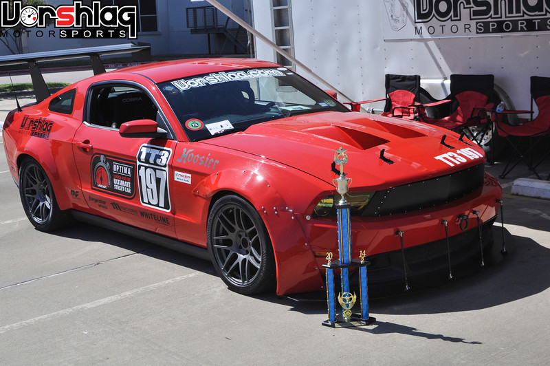

My favorite shot of our car all weekend was this one taken in our paddock by Matt Ruiter.... Full rez version in our TWS event gallery

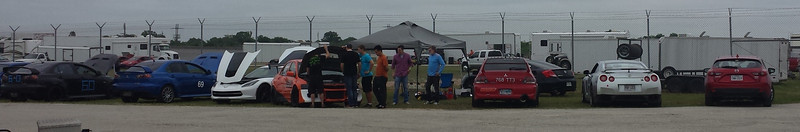

We got out to the track EARLY Saturday morning and dropped the trailer next to Costas and Matt White's trailers, who got a great paddock spot next to grid days earlier. Unloaded the car, topped off fuel, and got the sticker backing off, and went to a very brief TT driver's meeting where I handed our our TT maps.
Our paddock housed: our Mustang, Costas' GT1, Matt's ST1 Mustang, Misty's ST2 Camaro, Adam's E36, Toth in a Supra, and Norm's TTD BRZ

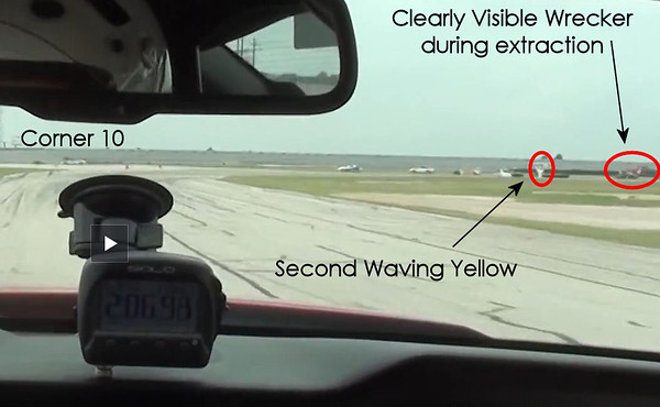

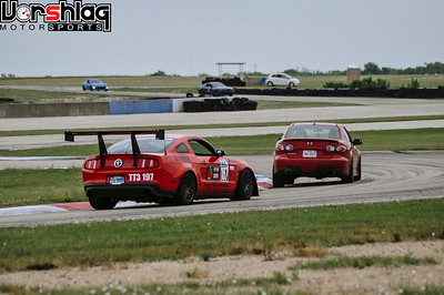

During the TT Practice there was a spin and a flat bed wrecker was called out on course for an extraction. There were then a number of Passes Under Yellow that were not appreciated by the track workers. Not one bit.
If you watch the video linked above you will see that we had a front row seat to a big nasty spin by a Viper Competition Coupe from the comp school group, about 30 feet in front of me at the 3:00 mark, entering T11. See, during the entire warm up lap this driver was scrubbing his tires like mad. I commented that maybe that was a bit much, but overall I just had a bad feeling - my Spidey Sense was tingling - so I backed way off this car when the first four cars ahead of me went Green during the out lap entering Turn 3, to give this guy some extra room. And I'm glad I did, because even through all four TT1 cars in front of built a big gap on the main straight most of them braked VERY early into Turn 15, where we're all doing about 150+ mph. The big gap I left quickly vanished and I had to back off into Turn 15 then 14 to avoid catching him. No big deal, it happens when we aren't gridded up in order by times - which is why the first session is called PRACTICE, so we can get gridded up in order by the first timed TT session. :)
Left: We have to run a nearly full tank and several weight plates to make our 3802 minimum weight
In the video the Viper slammed over the left curbing hard at T14, which may have damaged something. I pointed out the hard curb hit in the video. We caught up to him a bit in T12 then he braked pretty early into T11, and by this point I felt something was going to happen. Sure enough, the rear tires locked and he spun under braking into T11, first this way then that, on track and off. The spin was actually telegraphed pretty far in advanced and I had actually told Jason "Watch this", but the mic didn't pick it up on the video. I got the Mustang slowed down in plenty of time, and when he couldn't get going (he broke a half shaft) we threaded our way around him and got up to speed again.
Luckily I had pulled bit of a gap to the cars behind me, who probably didn't even see the spin happen, and I didn't impede anyone. The Viper pulled to the outside of the road in Turn 10 under momentum and parked - and without any halfshaft or drive, he was stuck. Everyone saw the Viper parked in T10 for 2 or 3 laps, with a waving yellow the whole time in this corner station. After getting back up to speed we took a leisurely hot lap 2 with an indicated 1:51.63 on the AiM SOLO, all while getting held up behind slower lapped traffic, making a pass, slowing heavily for Turn 10 (still waving yellow), and not really pushing it hard.
Funny thing was, that very compromised lap damn near matched my TT3 lap record time from this event in April 2013, where I ran a 1:51.530 and won TT3 both days. That best lap in 2013 was with me pushing hard, going 10/10ths on fresh 315 Hoosier A6 tires, using the APR GTC300 rear wing, the same power level, but the stock hood and the Laguna Seca plastic front splitter. Watching that old video I can see the front end wanted to push a lot at speed on corner entry and the rear was loose at speed, such as entering Turns 2 and T1 before the front straight.
After I ran that lap and saw the 1:51.6 as I crossed the start-finish line, I backed off (as you can see above, to about a 2:00 minute lap pace) and we immediately saw a waving yellow AND an EV/Ambulance flag added at the corner station before Turn 10, located inside Turn 13. Two corner workers there were waving two flags vigorously and that got my attention fast, even when slowing down from 150 mph. In the video I noted the yellow and the newly added Emergency Vehicle flag to Jason (at the 4:13 mark) and you can see that I backed way off, anticipating something new at the next corner station. We both knew what the two new flags meant - the TWS track crew must have rolled a wrecker out to Turn 10 to attempt a "hot extraction" of the Viper, which was stuck on the racing line in that corner for the past 2 laps. The entire session of 61 cars had already driven by the parked Viper, TWICE, so this shouldn't have come as a surprise to anyone. Once you see waving yellows AND an EV flag AND a wrecker on course, that TT lap is OVER, if not the entire session.

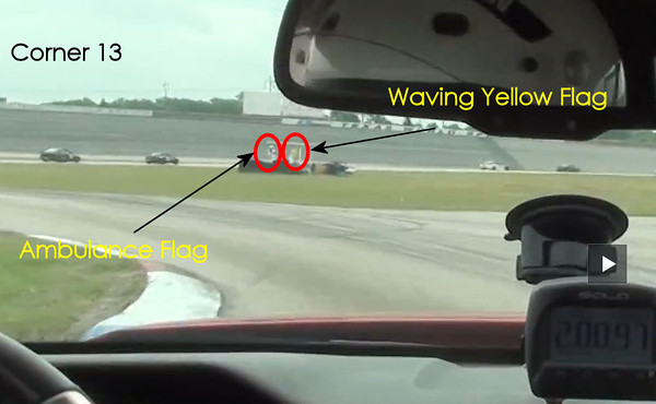

At the 3:38 mark in the video you see the second corner station in a row with waving a yellow flag and an obvious wrecker extraction going on. With the corner worker moved out of his protected corner station next to the track waving vigorously he really wants us to slow down for the wrecker driver, who is standing on the track and nearly right on the hot driving line. At this point I backed off even more as I approached this chaos, before T11. But there were some drivers blazing up in my rear view mirror between Turn 12 to T11, and I'm looking back and wondering if they had seen the flags at T13 and ahead at T10?? Nope. They are going full tilt, nose to tail in a major battle. It wasn't until the entry to T11 that I realized - these guys are about to pass me! Between a corner worker violently waving a yellow flag outside of his protected berm and right next to a wrecker driver trying to load the Viper - which has been sitting in the same spot now going on 3 laps - onto his flatbed.
Left: Jefri Tam drove to 2nd place in TT3 both days. Right: John Roberts placed 3rd Saturday then 2nd place in TT2 in his LS1 Miata on Sunday
I quickly pulled even father to track left, let loose a stream of expletives as the two drivers pass me going 10/10ths, mid-corner next to the wrecker, and watch as yet another driver behind these two also takes Turn 10 flat out then blows by me before we've even left the "danger zone" of this corner workers area (aka: 90 degrees from the corner station). Remember: this is a Time Trial practice session, the times during which don't even count, and nobody is racing for position. This exact corner has had a yellow flag flying and a car stuck on track for going on 3 laps.
I got back up to speed after this corner, stayed out of everyone's way, and dove into the hot pits. Once there the TT director asked me how the session went, and I told him what happened with some colorful language to emphasize my point. Later I found out the TWS wrecker crew was furious and wanted a handful of people thrown out of the track for the weekend. It wasn't just 3 cars that passed under yellow near the wrecker, it was closer to 6. These track workers literally put their lives on the line for us, and deserve more respect from the drivers.

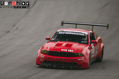

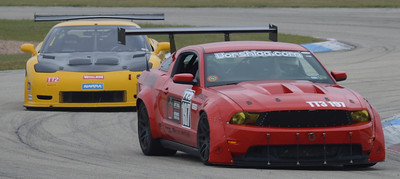

I tried to stay focused and since I was gridded in P4 after the practice, which was good placing for the first timed session. Temperature was stable at 76°F, as it was overcast and relatively cool almost all day.

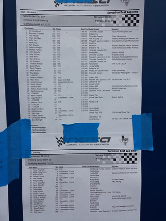

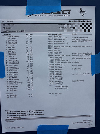

Left: Times from the gigantic clusterf*ck TT Practice session. Right: Times from TT Session 1 that followed
Amy and I agreed that I would go out in this first timed TT session to try to put in a good hot lap or two. We were on the new sticker set of 335/345 A6 tires, which I scrubbed in during the TT Practice. I went out with cold tire pressures of 28 psi front and 26 psi rear, which gives me hot pressures of 35 psi / 33 psi. We left the new wing at 6 degrees AoA, as it felt pretty good during the practice session and I wasn't even pushing hard yet. Not too much drag, with just enough rear bite at high speed exiting Turns 2 and 1 onto the main straight.

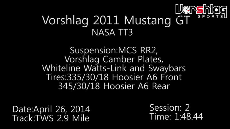

I had clear track and put in one good hot lap at a 1:48.440, more than THREE SECONDS quicker than our best lap here last year! That was exciting. As I crossed start/finish and saw the lap time I had the TT1 Corvette of Marc Sherrin tuck in behind and start drafting me, but I was pointing him by to pass, because I wanted to bank that lap (in Time Trial if you have a 4 off or spin on track your session times are DSQ'd). He figured it out and went on by me. Took a cool down lap and came in, figuring this would be my last laps of the day. That time went on to put us 6 seconds ahead of 2nd place in TT3, and we had 5 entrants in class on Saturday, so that meant we won 2 tires.
Maybe I could have made an even quicker lap 2, but I figured I would just catch traffic anyway and I didn't want to waste the tires. Amy went out in an HPDE 3/4 session just before lunch, to put in some laps, learn the line and get her up to speed, then she planned on running the two remaining TT sessions after lunch. But she wasn't feeling good, with crazy sinuses and a massive headache, and didn't feel well enough to drive after lunch... which meant that I got to drive in TT session 3 and 4, if I wanted.
Left: Saturday TT session 2 results. Right: End of day Saturday TT official results
I went out in TT session 2 at 2:10 pm and put in a 1:48.481 lap, nearly matching my time from the previous session (.04 difference). I was on a good hot lap 2 but had to abort the lap when I came upon a inattentive driver on a cool down lap ahead of me. I assume he clearly saw me gaining on him for 4-5 corners and he sort of pulled to track right, so I attempted a pass in a high speed corner (T7). In the middle of the corner he just came over on me and I had to put 2 wheels in the dirt track left to avoid a collision. This isn't the first time this has happened with this driver, and I hope he becomes more aware of his surroundings before he causes an accident. I'll just keep giving this driver plenty of extra room.
I wanted to note that this blocking situation is highly unusual in our NASA TT group, and the vast majority of our TT drivers have excellent situational awareness and go to great lengths to cooperate with other drivers, so that everyone can get their fast laps in.

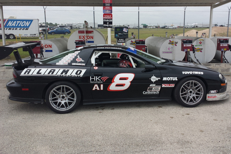

Mike Patterson won all 4 American Iron races on new 18x9.5" Forgestar F14s he got from Vorshlag, with a fastest race lap of 1:53.0

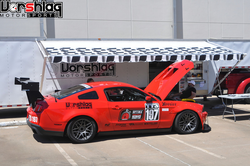

We got there around 8 am and set-up our trailer then unloaded the Mustang, just as it was prepped after the TWS event. I cleaned it up a bit on site and then set up our tables and some demo parts. We talked to about 60-70 people that day, which is good for a typical car show, I guess. Saw several of our customers there, but many of them didn't show up until after 10:30 am as there was a Cars & Coffee event that morning (these events are HUGE and draw in 1200+ cars and thousands of spectators). Having this car show on the same day as C&C was a bit odd, but hey, its not my event.
There were some beautiful cars at this car show, like the various C2 Corvettes above. And the typical, garish, silly car show stuff... loads of chrome ding-dongs and add-ons, little turntables with model cars under hood, every other car had a supercharger, etc.
I have to admit, this is not my scene. At. All. But we were there for a better reason than entering a car show... to see another pre-production 2015 Mustang and hopefully measure, weigh and drive this thing.

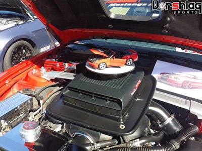

This pre-production vehicle was locked up all day and nobody could find the handler that Ford sent with this car to get us inside it, to ask if we could weigh it, or drive it. Aaron Sockwell from Dusold Designs and I took matters into our own hands and just went over and measured a few things...

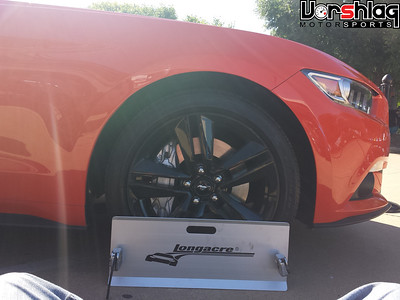

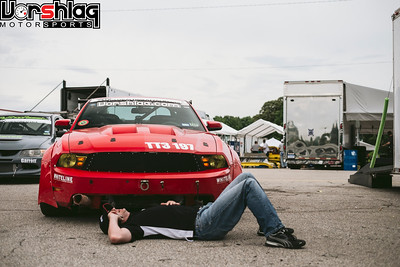

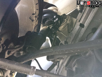

We crawled under the car and snapped a few pictures of front and rear suspension, but they show little more than we already knew. I did manage to snap a pic of the front strut to inner wheel distance, but it wasn't much. Discouraging.

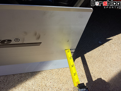

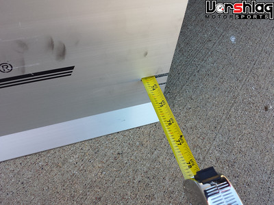

We measured outside track widths and the front was over 2.25" narrower than the rear outside track measurement on this car, which was equipped with 255/40/ZR19 tires at both ends. That's likely going to make the car understeer more, of course. Staggered track width or tire width set-ups are almost always done by OEMs to "insure understeer". Oh well, one more thing for us to fix.

By the end of this very long day they had awards to present for "class winners", and we won a 3 foot tall trophy - along with about 1/3rd of the attendees. I guess you could call it an attendance award.

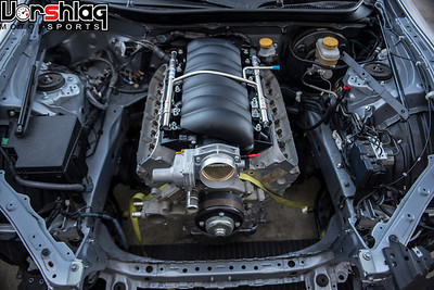

Our first or "Alpha" LSx V8 Scion FR-S swap development is moving along nicely and we just made an update to that build thread (on 7 forums, including at Vorshlag). The motor and transmission mounts were just completed and they look great (top right). The LS1 V8 adds barely more than 40 pounds to this little car, yet triples the engine displacement. Sound like fun yet?

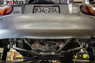

Our Alpha LSx V8 NB Miata project development has reached a milestone, with the custom tubular rear subframe and rear suspension design now completed and ready for final welding and fixtures. This bolt-in subframe assembly houses an aluminum 8.8" IRS diff housing from a 2004 Mustang Cobra, which it needs to withstand the 450+ whp that the built LS1 motor it has will put out. Our new head fabricator Ryan H, who just joined us from a Daytona Prototype race team, has done all of magic to this car over the past month. Look for an update to this build thread soon (here). Zoom-zoom....

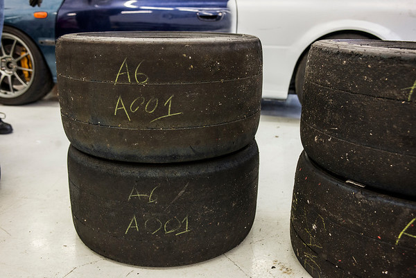

Lots and lots of used 315mm Hoosier race tires, in A6 and R6 flavors. Amy used up 4 of these doing about 7 sessions that day at Full Tilt speed at an ECR track event 3 weeks ago, and they were still very fast. We have dozens left. I've just removed all of the Hoosier entries from the actual Clearance page (no longer willing to ship) because I lowered the price on these by 75% to only $100/set cash. This gets you a choice of the best 4 we have, but we won't ship them at that price - you've got to stop by and pick them up in person. We need the shop space more than we need the extra scrub tires for our own cars.

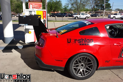

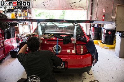

The custom 10" plexiglass rear spoiler we built for our time in SCCA's ESP class has been sitting on a shelf since late 2012. I forgot we even had this until something on a shelf in front of this part was moved out of the way. It is in perfect shape and we would charged 2 or 3 times this much to hand make one like it. It is built to fit a 2010-12 rear trunk and is made to the absolute limit of the rear spoiler rules for Street Prepared category. Comes with all of the hardware needed to bolt it to the trunk (note: a handful of nut-serts will need to be added for the lower rear strut mounts)
If that spoiler isn't your thing, maybe the big carbon fiber APR wing we used from 2012-2014 suits you better? Like the spoiler above, this also only mounts to the trunk so you don't have to cut into your fenders or anything else to add this. If you pick up a spare trunk, like we did (for $150), you can mount this wing to the spare and "swap trunks" between track days and street use.

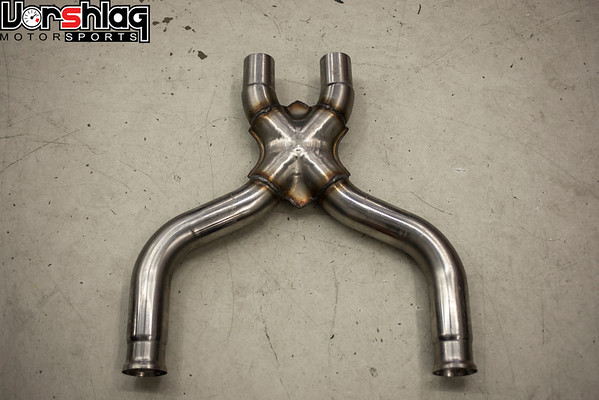

We acquired a brand new Magnaflow X-pipe for 2011-14 Mustangs that we're selling discounted by $100. It wasn't used on a customer's install and had been sitting on a shelf for months. It is brand new.

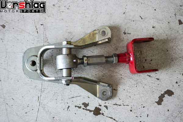

This was one of the many Upper Control Arm and UCA mounts we tested in our car. This configuration is an unmodified UPR brand bolt-in upper mount with a Spohn Performance adjustable UCA with a Del-Sphere upper joint, also known as a Johnny Joint. Vorshlag customized the upper mounting bolt (larger) and made custom mis-alignment spacers. It works better than Spohn ever intended, but it makes a little noise, like many aftermarket UCAs do.

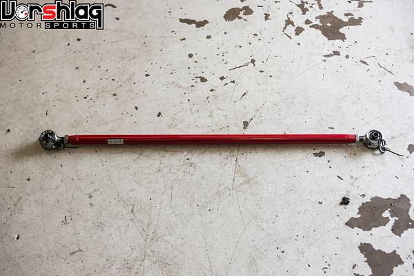

Spohn Performance adjustable Panhard Rod, M5-105, built with 4130 chromemoly steel tubing and Del-Sphere ends. This unit worked fine and we used it until we upgraded to the Whiteline Watts Link kit.

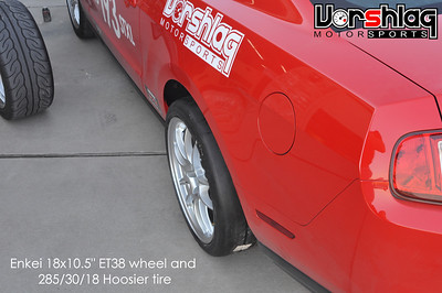

Mustang 18x11" Wheel Fitment Video + New Sizes

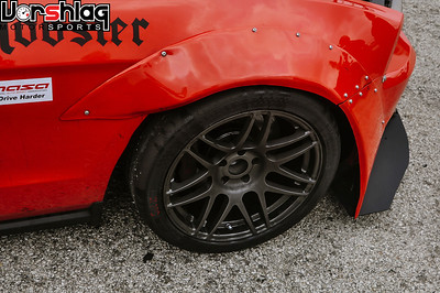

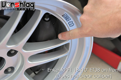

When we bought this 2011 GT and started racing it immediately, in mid 2010, I was shocked at the utter lack of wide wheels that were offered to fit the S197. I mean it had been out since the 2005 model, but most folsk were still jacking around with 8 and 9" wide wheels, or worse, using 18x10 or 10.5" wheels that POKED out the fenders like mad. I bought a variety of wheels (1 of each) to test 18x9, 18x9.5", 18x10 and 18x10.5" sized on the front and back of our test mule, trying to fit as much as possible under stock fenders.
After coming up empty handed we finally decided to pull the trigger and had our own 18x10" wheels made, which we calculated and verified would fit easily under stock fenders both front and rear. This D-Force 18x10 ET43 wheel was a success and now lots of other wheel makers have this exact same size. But I knew that we could fit more, so we did some more calcs and ordered 18x11" front and 18x12" rears, and made some suspension tweaks to make them fit with a 315 at both ends. We ran on this set-up for much of 2012-2013 before finally deciding to flare the fronts then the rears to fit 18x12s and even wider tires (335F/345R). the car only gets faster every time we up the tire and wheel width.
Click above for Hollywood quality video showing the tricks to install 18x11's on a Mustang (hint: its not Hollywood quality)
During 2013 we decided to try an 18x11" wheel for both ends, and came up with our proprietary fitment that uses radically different offsets on each end of the car. We have sold lots of 18x11" wheels now and have all the tricks and tips and this video above explains where the clearance is closest and the best way to have maximum room for street an track use. Jason and I made this video in about 10 minutes, so its not exactly Oscar worthy, but it gets the info across. We also touch on tire sizes to use on 10 and 11" wheels.

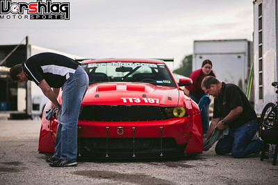

Since we were leaving on Thursday at 3 am, the car was quickly prepped and loaded in the trailer on Wednesday. The guys pushed some fresh Motul RBF600 fluid through each corner to make sure it was bled and clean, the same set of 335F/345R Hoosier A6 tires from TWS were left in place, 8 fresh quarts of Mobil1 15W50 synthetic oil and a Wix filter were swapped, and the car was given a good pre-race tech inspection. Shop Manager Brad noted the XP20 Carbotech front brake pad depth was only 1/2 thickness, and asked me where the spare pads were.... err... good question. "I think they are in the trailer". I went to get the trailer, no spare pads. Crap. This WAS the spare set of pads. "No worries, we'll manage", I said. We have 3" front brake ducting, so the pad won't get that hot. Ha.
Note: getting in a rush does not excuse the mistakes I made in this pre-race prep. We tend to push our own car to the back of the line when it comes to shop time, behind paying customers. My not taking the braking system needs and consumables seriously enough led to the accident below. Our Motul rep was shocked that we were still using RBF600 fluid on this somewhat fast and heavy Mustang. "You should ONLY use RBF660 on that car!" Motul RBF600 is great brake fluid, and appropriate for 90% of our road course customers, but the boiling point is a touch lower than their 660 fluid. We've been pushing the limits of brake system sanity in this 3800 pound car and I knew that our measured caliper temps were nearing the boiling point of RBF600. Don't ignore advice from your suppliers and don't ignore the data you are taking. Learn from my mistakes.

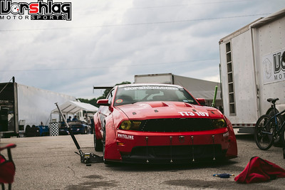

We got to the track Friday morning with plenty of time, found the registration center and got our credentials to get in the gate, then we worked our way through the maze of infield roads trying to find the paddock. We asked directions from parking folks 3 times and were told to go 3 different places. We even found Todd Earsley in the infield maze of roads, who threw his hands up and just followed us. It was crazy confusing, and after coming back from this event I've found a map of the RA paddock areas and better understand why - there are TWO pit rows and TWO separate paddocks. The "infield" or "Pro" paddock and the "TT" paddock and pits set outside the track, across the T12-T1 front straight. If you learn anything from reading this post, it is to learn to ask WHICH paddock you need to pit in at Road Atlanta, and to NEVER underestimate this track's abuse of your braking system. More on that in a moment. They put all of the Trans Am and GTA cars in the left "TT" paddock and the Formula Drift cars were in the right or "Pro" paddock.
Josh Garcia's Toyota V8 powered AE86 Celica is always a popular car in the pits and on track
We unloaded the car from the trailer, and while I went to the driver's meeting Amy and Brad gave the car a quick wash at a nearby garden hose. They were drying it off, applying the GTA number boards, and checking fluids when we I got back. At this meeting the GTA staff warned us that this track was pretty treacherous and that they wouldn't be surprised if there were multiple crashes and car carnage. They were right.

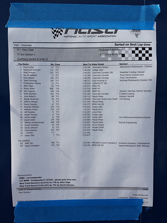

Left: After the GTA Session 1 results I was in 8th overall. Right: I found a 1.4 seconds in session 2, moving up to 7th

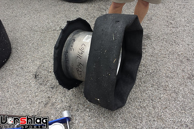

After swapping to our "test" tires, which were terrible, we never got a chance to put on the good ones

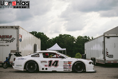

The Trans Am cars were paddocked all around us. We met some nice folks with good advice about this track

On lap 8 I was on a good lap, finally seeing a 1:36 indicated on the predictive lap timer, finally with no traffic, but I wasn't pushing it any harder than I had been the whole session - the corners were just finally coming together. I was motoring down the LONG back straight and could see two cars entering Turn 10A as I went to go grab the brakes, doing about 150 mph. WHOOMP! Pedal goes straight to the floor, nothing happened. No brakes. Shit!
Most racers will mentally practice for this very situation. You should also practice a stuck throttle pedal, having a flat tire, and a few other "bad things might happen" scenarios. This way, when Bad Things happen (given enough time, it all happens) you know what to do automatically. In 27 years of driving on road courses I've had exactly one other sudden and complete loss of brakes before, in my 2013 Mustang on the OEM pads/small front rotors, I went off track after a 120 mph braking zone at ECR, and I was doing about 80mph when I left the track. I had time to downshift, pump the brakes a bit, try to use the E-brake, etc. THIS time it happened FAST and the loss of brakes was COMPLETE. I was going a lot faster here, the braking zone was steeply downhill, and the run-off area option was not very friendly. This wasn't just loss of pad material like last time, it was a total and immediate loss of hydraulic system pressure.
Last time we saw the front end intact and all one color for a few months...
As it often happens in a crash, my perception of time Slowed Down: I quickly evaluated options. There was a wall immediately off track to my right, a gravel trap just off track ahead, and two cars negotiating Turn 10B to my left. Pulling an e-brake could shed a tiny bit of speed but potentially lock the rear tires, put the car into a spin, and likely punt me into a wall. Or into the gravel trap sideways - and flip. Going left and "short cutting" Turns 10A-10B through the grass wasn't an option because I'd likely collect one if not both of the cars slowly exiting 10B right in front of me. So going off track straight ahead was my safest option. I managed a quick 5-4 downshift, as I would normally here while braking (and even go down to 3rd gear), but grabbing 3rd at 150 mph would only mechanically over-rev the motor and lock up the rear tires. According to the Solo DL, I left the track doing 142 mph, so the downshift was good for a tiny reduction of speed via engine braking.
Now of course we always video EVERY lap of every session Amy or I drive, to catch good laps as well as bad things like this - to hopefully learn from it. But we goofed didn't pull any video off the same SD card in this vidcam for 4 race weekends in a row, and the 1080P camera filled the card during the 2nd hot lap of this session. So we have no video of the crash. Sadly I always check the vidcam before a session starts, and would have realized "oh, this won't record, it must be full" and swapped cards before the next session. Just happened to fill up during the worst session of the weekend. We still have plenty of pictures of the shunt thanks to some sharp eye'd shutter bugs.

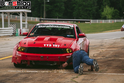

Brad was shoveling gravel out of the car and removing the brake duct hoses - there's still gravel coming out weeks later

The front pads were very worn after the Road Atlanta event. There was less pad thickness than backing plate thickness, as shown above. The front rotors were also DONE, with massive heat cracking on all of the surfaces. Those were both replaced with fresh Centric rotors and Carbotech XP20 pads and we won't do any more TT events without NEW pads at all four corners, and we'll keep full spares in the trailer (we usually do that already). The rear brakes looked fairly worn and after the first HPDE session at ECR 2 weeks later they were replaced at the track with a new set of spare Carbotech pads. The brake pedal was still mushy as crap after we got the car back from Atlanta, and the fluid looked like coffee. It had gotten HOT and boiled, as simple as that. THAT is what ultimately caused the loss of brakes...
But why did they boil? Two reasons: 1) I was driving longer stints than we designed the car for and 2) the worn and thin brake pad material wasn't thick enough to insulate the brake fluid in the calipers from the 1000+ degree rotors. We have since upgraded the Mustang to Motul RBF660 with a complete fluid flush. The Motul 660 looks light brown right out of the bottle, not clear like the RBF600 does when new. We had just flushed another car (see above pics) with 660 and that's what it looks like, fresh.
And even though these extended driving stints are very atypical for us in NASA TT, we went ahead and upgraded the front brake ducts from 3" to 4" on the front of the car, and plumbed the system with 4" flex tubing.
For 99.5% of you reading this the 3" backing plate + hose kits we already make (we now have the hoses as an option) are more than adequate for HPDE or even TT use. Our shop guys are building the 4" backing plates now (below right), but we ran it with the 4" hoses and front openings at ECR already and saw a 60 degree drop in front caliper temps. This weekend at Hallett will be an even better test.
